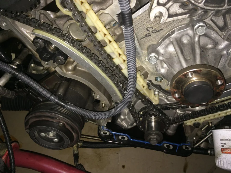

I just fully rebuilt the 4.6 3v in my 2007 mustang. Upon reassembly I used a brand new FRPP timing kit. Got the car running and tuned but when I left the shop after it sitting overnight it started clacking in the front. It was a random noise, not in time with the rest of the engine. I pulled the front timing cover off and turned the motor over by hand. I noticed my passenger side timing chain tensioner would click in and allow slack along the top guide. I figured the tensioner was just defective. So I replaced it and again it's doing the same thing. I realized it shouldnt do this while the engine is in constant rotation but it leaves me baffled as to how the bottom guide (that touches the tensioner) is tight, but I have slack up top. Made me think my timing was off but the car was running fine. Made over 500hp on the Dyno the day before this noise happened. Any help?

Not 100% sure, but I believe these tensioners use oil pressure to apply tension to the chain assembly. Could there be an issue with oil supply to the tensioner in question, or perhaps even an issue up top with the cam phaser setup. Doubt a phaser issue would cause an overall chain tension problem though.
After talking on the phone to the guys at the machine shop who built the bottom end, turning the engine by hand, and watching the cams and crank for about an hour I came to this conclusion. Between the supercharger running a higher boost and having a much stiffer valve train in the heads, the guides can no longer withstand the pressure. The tensioner losing pressure allowed the guide to drop down and the cam to turn slightly, while the crank stayed in place, thus creating the slack. I ordered upgraded cast iron and steel tensioners with built in ratchets to solve the problem. Turns out the guy who tuned my car, who has a 900hp 3V and loves these engines, is running the same tensioners. Found that out from my machine shop. So the tensioners should be in tomorrow and i will update the thread then.

Very late reply, but I hope you solved your issue! Assuming so with the dead thread. I recently did upgraded valve springs on a coyote and was greated with the same chain slack/slap on startup, even with new cloyes timing parts.
I'm throwing in Ford Performance's kit with the Boss 302 ratcheting tensioners. You'd think this would be more widespread knowledge that people could pass around, about upgraded valve springs needing racheting tensioners. But I suppose most people building a motor buy both without thinking twice!
