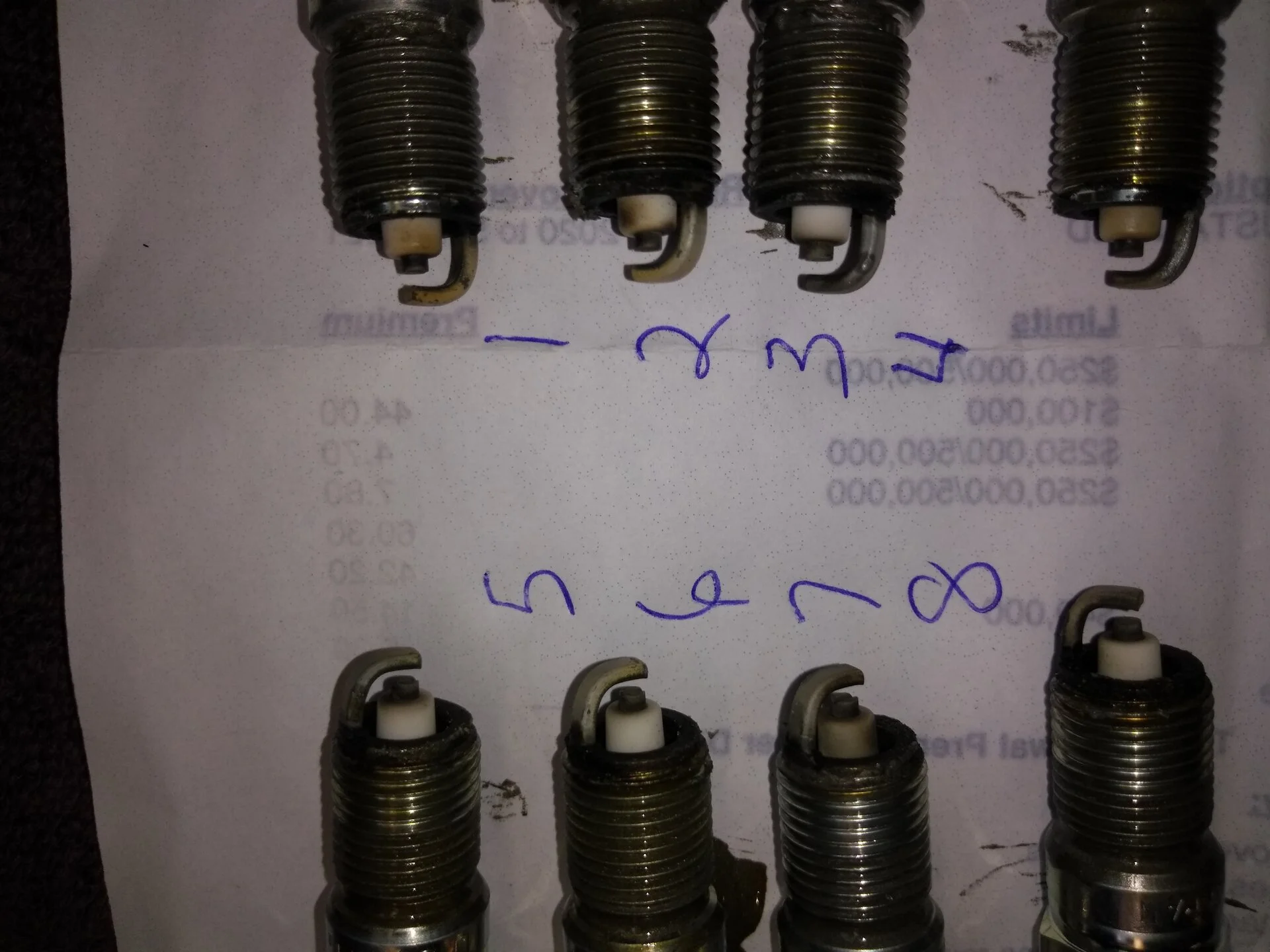

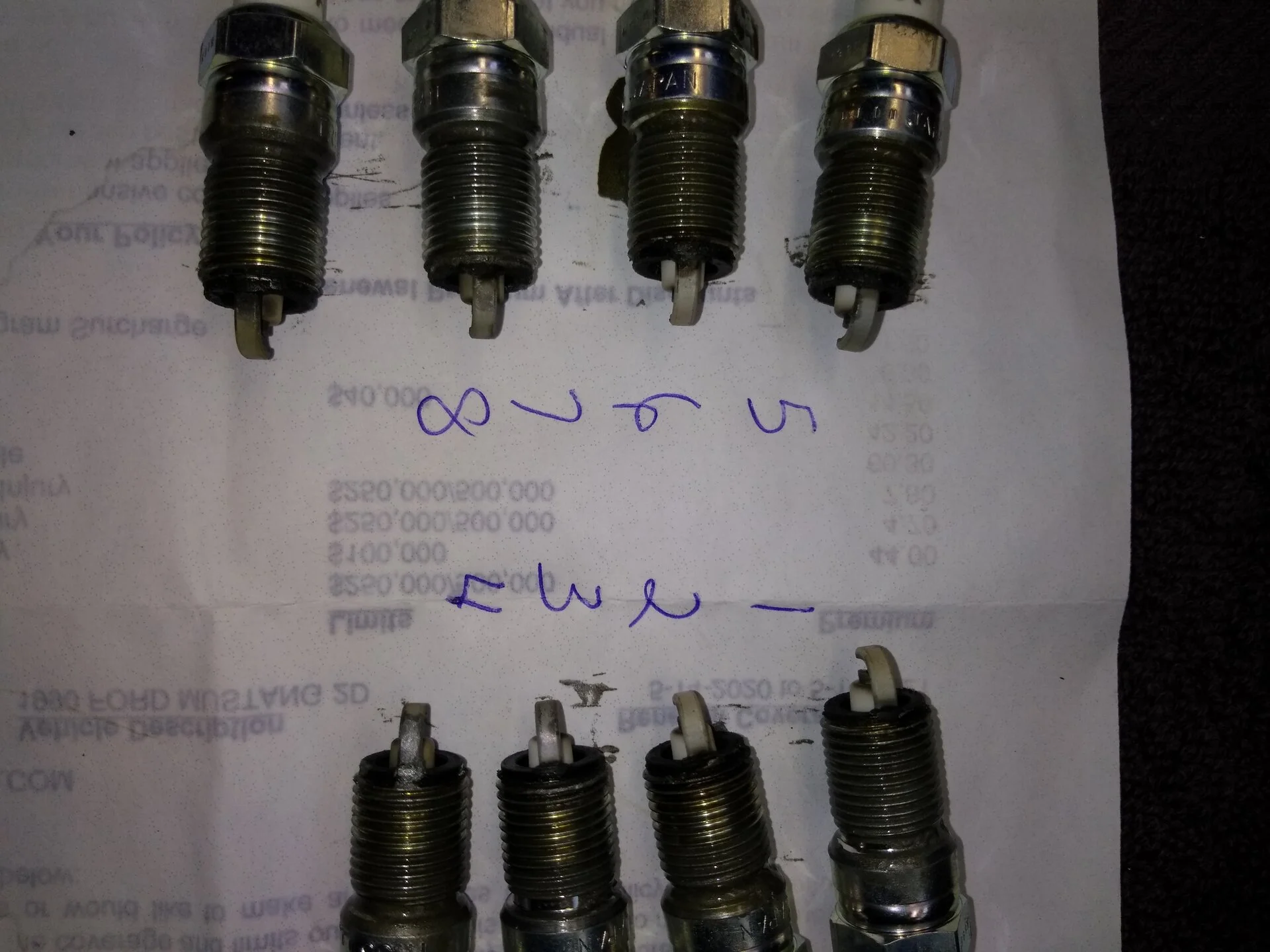

I'm thinking I could have an injector problem. I'll try a balance test tomorrow. Maybe disconnect one plug wire at a time and see if there is any changes.
I swapped plugs today. These only have a few hundred miles on them.
