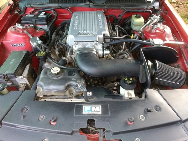

I already did a vacuum leak test and couldn't find any. There is a hissing now that comes from the engine
1. Make sure that the intake pipe has an airtight fit to the air filter assembly at one end, and to the throttle body at the other.
2. If you haven't already cleaned the MAF sensor, do it.
3. Remove the throttle body and clean it inside out until it looks like new.
4. The 4.6 3V engine doesn't have a PCV valve, and a little oil inside the intake manifold is normal. I recommend that you install a driver's side air oil separator. A cheap $25 Chinese ebay item like the ones I have will do the job nicely. I installed one on the passenger side as well but that stays bone dry.
5. It does sound like you have a vacuum leak and it could be one that's difficult to diagnose, especially if it's from an intake manifold gasket or from the CMCV shaft at the rear of the manifold. It's a good excuse to delete the CMCVs altogether.
