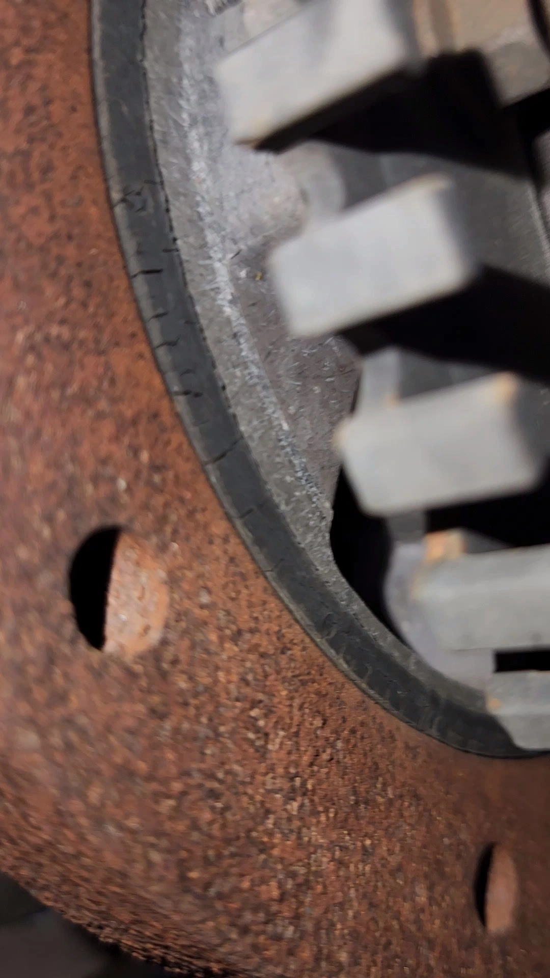

What about the balancer/crankshaft damper
I have read about that but I frankly have no idea how to inspect it. From what I have read about it everyone seems to say that the vibration would get worse with rpms....
As far as what it looks like...it looks original....rusty....I can't see any rubber or would know where the rubber is even supposed to be? I heard something about painting on something white and revving the engine and seeing if it moves....
Could a bad balancer cause INTERMITTENT slight shaking?
Shine a flash light and look for it being warped at all. I get under there while its running and just lightly touch the side. Not reccomended but it worked for me. Mine was off a touch
I just went under there with the engine off and to my surprise I finally did find the rubber and it is dry rotted and cracked. I bet that it is enough to cause intermittent shaking at idle specially in park vs drive....in drive I feel like the torque from the transmission dampers it....when it is in park it is isolating the harmonic balancer more and making all the effort put on it to balance everything....
Thank you....I am thinking it might be worth actually replacing this part now. There is definitely some dry rotting and cracking of that rubber inside...
Yours was off a touch....what were your symptoms? I just took a video and uploaded it to YouTube. It does appear to be moving in and out a little....that with the rubber cracking/dry rotting makes me think it needs to be replaced and HOPEFULLY after replacing it the shaking at idle goes away.
