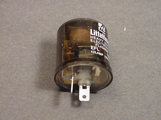

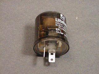

OK I found mine, It is behind the radio. it is a blue thing.
My question is if i go and buy a new one will my turn signals still flash at the same speed?
Yep that's it.
The new one will be clear with golden metal inner workings.
It will "click" moreso than "ting".
Throw this old thermal crap in the trash.

The number on a normal flasher indicates how many bulbs (ergo what kind of wattage) it's rated for.
An E-flasher is not nearly so sensitive. The parts store computer should be able to look up the correct E-flasher for you.
