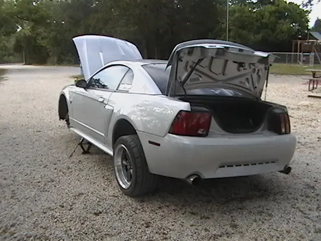

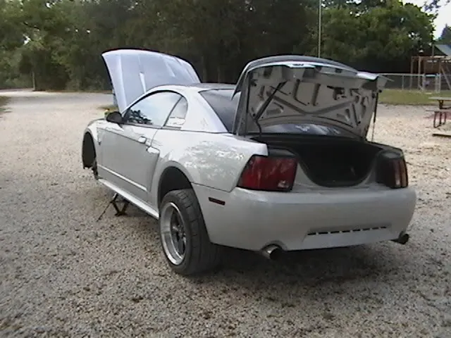

Jacked the car up

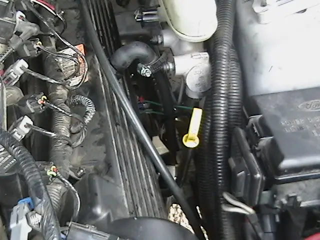

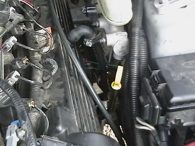

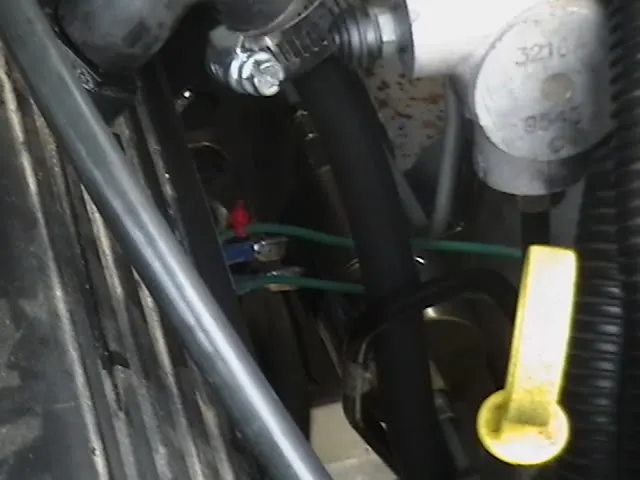

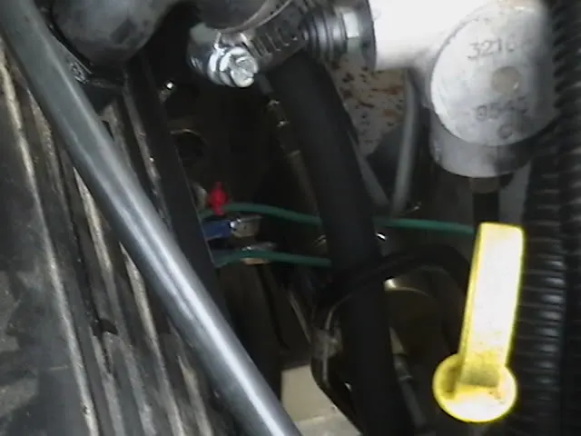

Now for the custom part....instead of wiring in the activation switch that they supplied, and the positive wire that they supplied...I decided to do something a little different :D. As some of you know, I hit a racoon a month or so ago and it broke my drivers fog light. So the other day I went ahead and removed both fogs.
Well this was perfect timing and decided to wire my fog light botton as the activation switch :D. The fog light wire cluster had both a hot and a ground wire...just what the silinoid needs to be activated. So as my dad suggested this morning as he was leaving, I cut off the end and took the 2 wires...extended them, and put some female ends on them and plugged them into the line lock :nice: . All it requires is a hot to go on one plug, and a ground on the other...and the fog light switch will have its own breaker to potect a short.

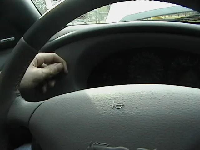

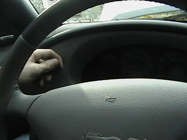

So when you want to do a burn out, turn the parking lights on (nice safty feature IMO)
Press the botton and the light comes on letting you know its activated
And have at it :D . When your done, reach down and press it again to release it .

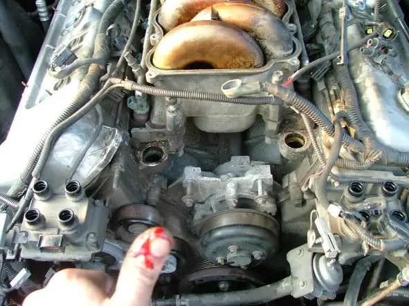

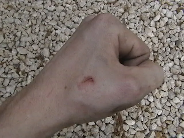

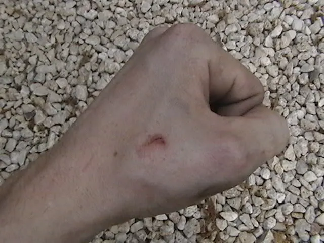

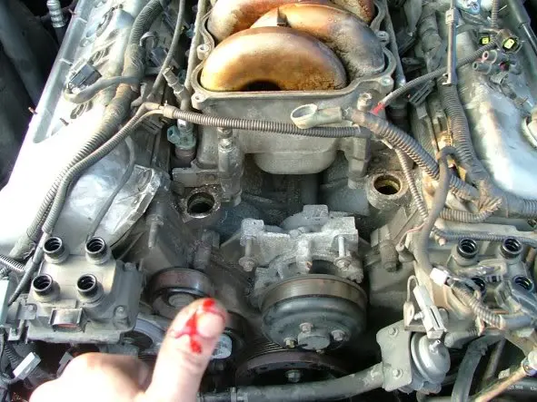

Oh yea and the battle scar :eek:

I gotta start taking pictures of mine. I got a doozy doing a 5.0 axle swap a few days ago across my forearm. It cut so deep, the scab contains chunks of the ink from the tattoo it cut across.
Thanks guys! Yea I seen your setup propellerhead, very nice...and secure!
Ouch Tom...I hate those cuts :( Makes mine not look so bad haha.
And Garlic, you just discovered a new way to remove unwanted tatoos :rlaugh: . must have really hurt :(
:eek: crazy battle scars.. I've got a few scars of my own!.. But they're from heart surgeries :D haha

:rlaugh: Yea mity maybe im a little crazy lol, I was all crawlin under there and crap too. I was thinking, "well if this jack falls, its all over...but ahh it wont" . I hate those jacks, but the other one was in use....and I didnt feel like putting it on those nice stands (yes we have them STRONG/NICE ones..just red). Looking back at the pic though, that doesnt exactly look too safe :rlaugh: :rlaugh: :rlaugh: .
