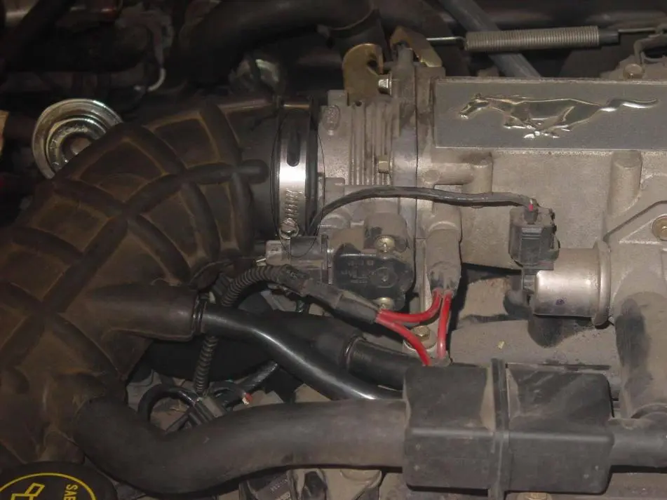

I found exact where the 'leak' must be coming from. I sprayed with the MAF cleaner I had (no residue spray) over the intake starting from the base where the filter connects all the way up slowly making sure to hit the two hoses that connect on the side. Once i reached where the intake connector meets the throttle body my idle smoothed right out. I retested by stopping and allowing the idle to get choppy again and then spraying thoroughly again verifying the the idle was smooth again.
I inspected the top of the hose and didn't see anything that looked wrong with it. What should I do now, pull it off and then reinstall it to make sure it was installed correctly? I'm 95% sure I reattached it over the lip completed to begin with. Any suggestions are welcome. Thanks,
Kirk
I just went back out and started the car, loosened the screw clamp and re-fed the rubber back over the throttle body lip. It still runs rough. It always evens out when i spray on the front section of the lip of the rubber but when i inspect it I don't see any cracks etc. I also looked over the throttle body itself and dont' see any cracks there either. What gives?

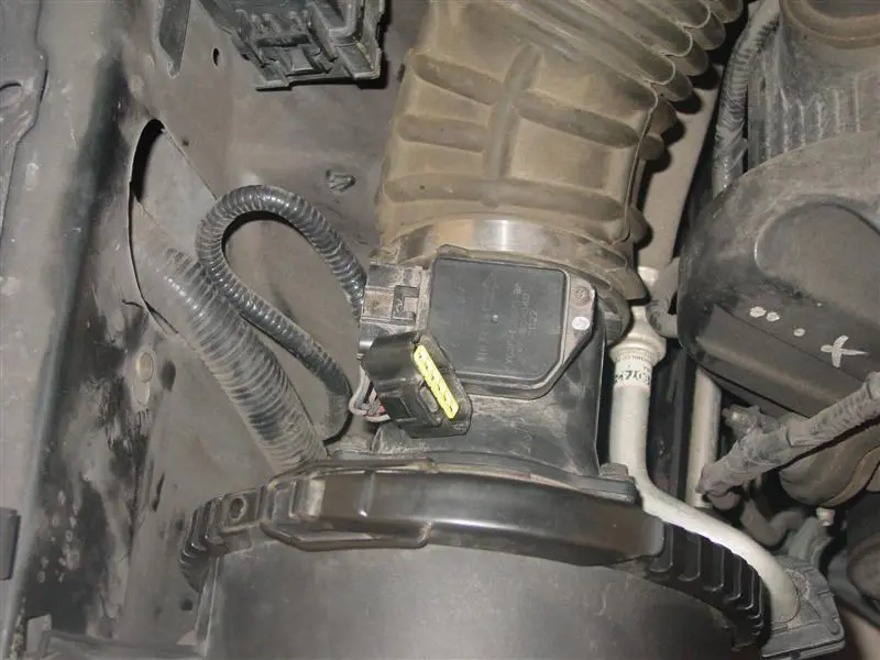

With both those codes being thrown the mass air flow sensor or a low fuel presure problem are usually responsible. I would do a fuel presure check and see if it is in specs. then check your mass air. their are a couple ways to do that. the easiest is to unplug it and see if it changes the way the car runs. If not the sensor is bad if it does the sensor should be good. If it was a vacuum leek i don't think your car would go back down to 700 it would just stay high.
Kirk
It sounds like there's a leak in that area. Could be throttle body gasket or worn throttle shaft. Take the throttle body off and check for leaks as you disassemble.
It'd an easy re/re and then replace the throttle body gasket if all looks good. Check the throttle shaft for wear by wiggling the shaft purpindicular to the shaft and see if there's excessive play.

I attached two photos. One shows (circled) where I am spraying the areosal (sp?) cleaner at that evens the idle. The other shows the unplugged MAF cable to test as suggested previously.
When I unplugged the MAF and started the car it didn't completely smooth out the vehicle. It did seem to make a small difference in the quality of the idle but not completely smooth.
If it were the MAF sensor would the check engine light go off after the idle smoothed out or would it stay on regardless because the sensor wasn't sending a signal?
I keep inspecting the intake area and I dont' see any leak. I also don't believe its the intake gasket because that is located to the right of where I'm spraying. I tried application of the cleaner undernearth the throttle body where that gasket most likely is and the idle stayed rough. Any more thoughts?
