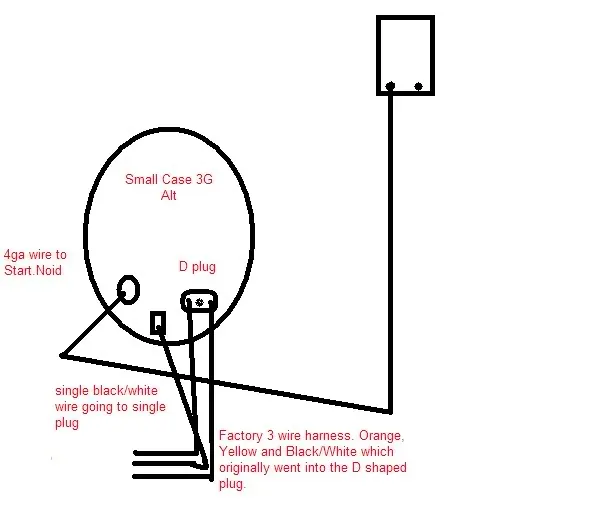

I want to know if I did my install correctly. I purchased a small case 3g wiring kit (complete with 4ga wiring and fuse block, connectors and plug) about a year ago and lost the instructions. I searched, but a lot of sites I seen weren't to clear so I figured I'd post. Below you can see a quick diagram of what I did.
Is the single White/Black wire which originally went to the D shape plug ran correctly? I figured I was supposed to cut the wire then run the harness side directly to the new plug and tape off the end coming from the D shape plug with electrical tape - making it a dead wire on the D shape plug side. I however seen a few pictures where ppl left it going into the D shape plug and ran the cut end to the plug.
Where the thick power wire goes on the back of the alt is that the only wire that goes there? I seen some people run the yellow wire from the D shape plug to there. If this is the correct way then I failed and need to fix it. If I did it incorrect do I cut it and run it from the harness side to the same power plug has the 4ga wire similar to how I did it with the black/white wire or do I run it from the D shap plug end?
