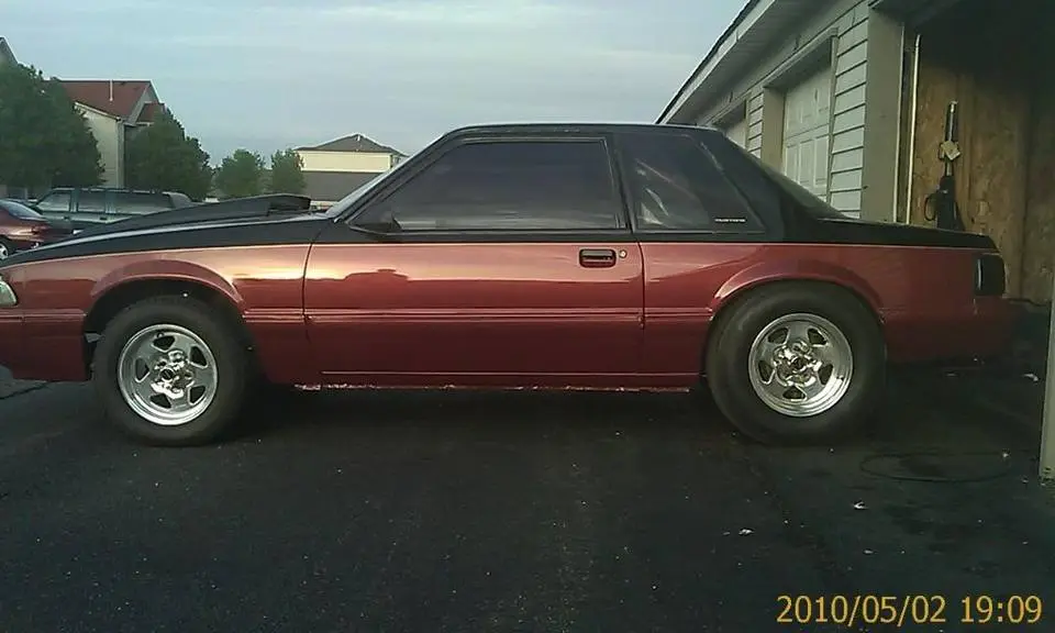

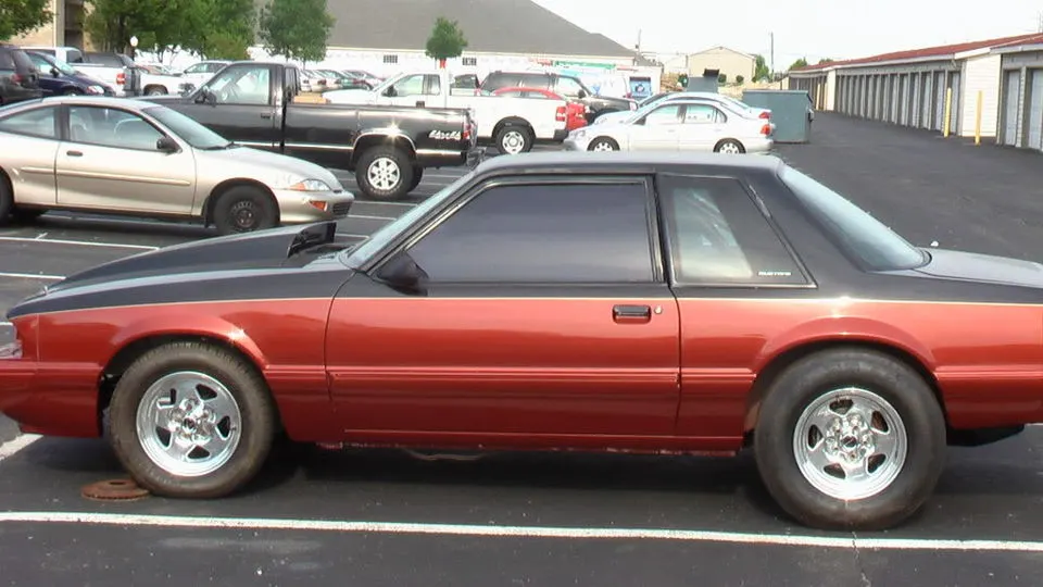

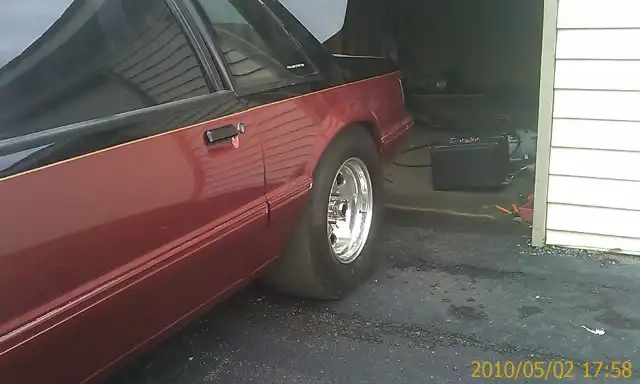

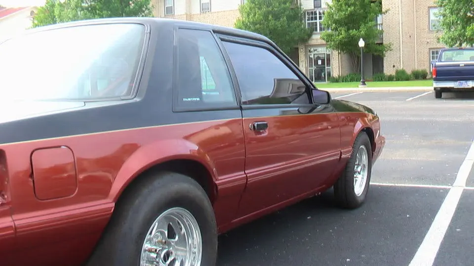

Minitubbed narrowed 8.8 1.5" 28X10.5w 15X10 w 6.5 back spacing
Before
After

Looks great!

looks good, should of went with a bigger tire since you went through the trouble of tubbing it, I run that same size by beating in inner fender and rolling the lip on outter.
edit- oh mine are the regular 10.5s, not sure the dif between the Ws

Wow, that really tucked the tires well! It looks awesome. If you don't mind me asking, what does something like that cost? Feel free to PM me if you don't want the whole world knowing your business.

Local guy here that owns a roundy round shop did the work and only charged me $650 he also put in a new tubular core support some more safety bars and readjusted my window net.

Its also set up for a 325 radial also

That's a damn good looking car.
about 3 inches

Thanks Im debating on anodizing them black let me know what you think.

I think they would look sweet flat black

Cedar Lake says Welds look good no matter what you do to them

Call me crazy, but I think they would look kind of cool if painted the same red color as your car. Bonus points if the outer lip is black and the two colors are separated by the same little pinstripe.
EDIT: Maybe just solid red with black lug nuts.
