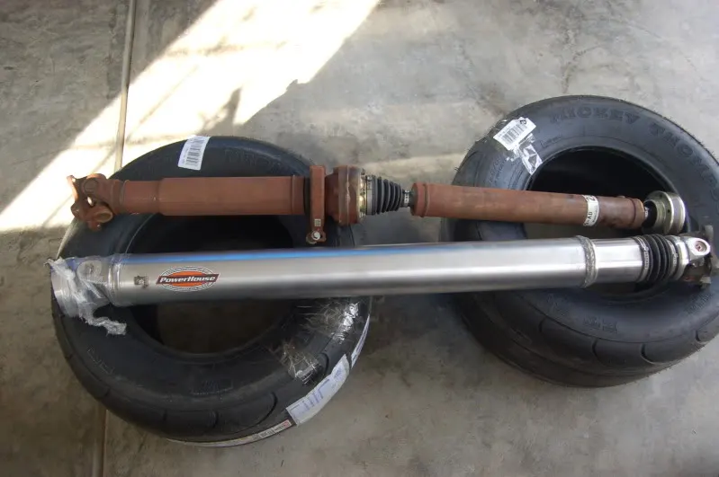

well last weekend upper control arm came apart while doing some spirited driving, not sure what happened, but it left me stranded on side of road needing tow home.
got it home all jacked up, i see 2 halfs of my steeda UCA. i take it all down, put it back together, have it on jackstands and put car in gear, front half of driveshaft moves, back half didnt go anywhere!
luckily i had the one piece axle exchange shaft siting here waiting to go on, installed that and my driveshaft loop.
have only had the car up to about 85 or so now, but i have no vibrations of any sort.
got quite a few parts to install before going to track, but they will be open now depending on weather.
i definitely feel the driveshaft was worth the money, real easy install, did it on jackstands with a electric impact gun to get pinion nut off. was light enough for me to hold it up while threading the bolts on myself.
still got the long tubes, catted x, anti squat brackets, upper control arm mount, to install. then get a new tune, new back tires, and i'll be all set for 12s this year.
nah, [not my picture, just one i could find]
the center section inbetween the two tires in the picture, you hear a clunking sound, and you can hold the one half, and spin the other half. i bet if i took off the boot i could see exactly what i messed up, but not a huge priority.
i believe the jamnuts backed off on the uca, and when i slammed second gear it was enough force to completely undo itself? i dunno, drove around a few months no problems.
