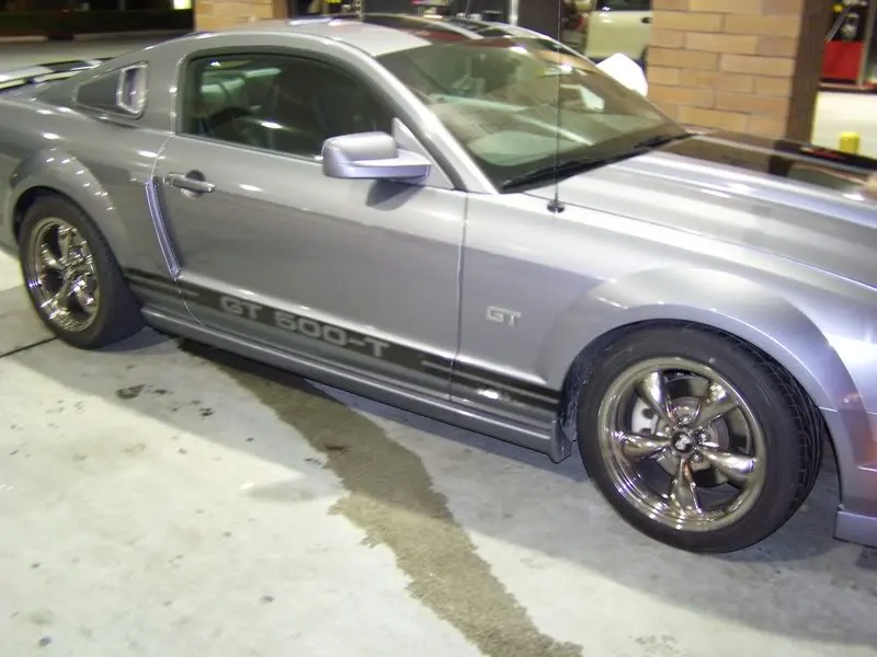

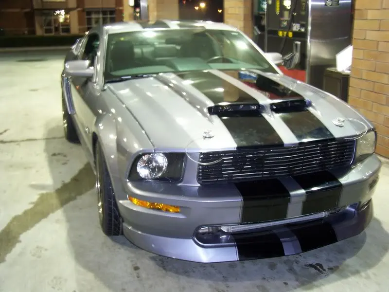

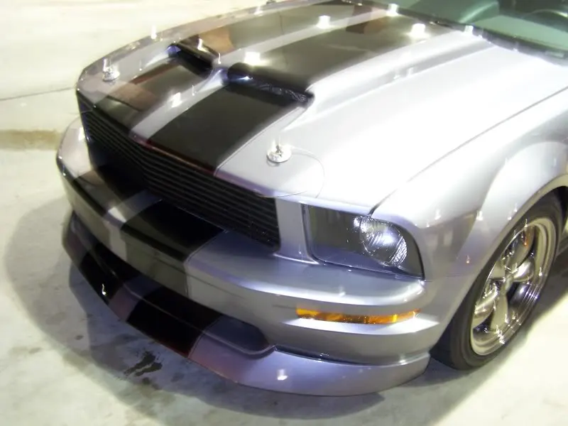

pics
they are a touch narrow, but they look ok, and they perform great.

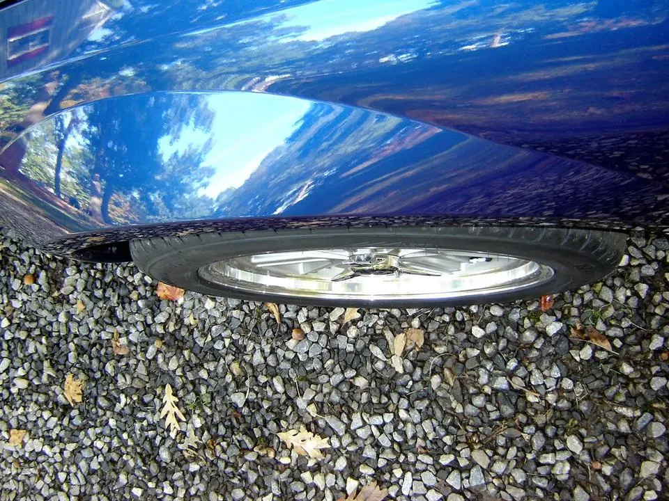

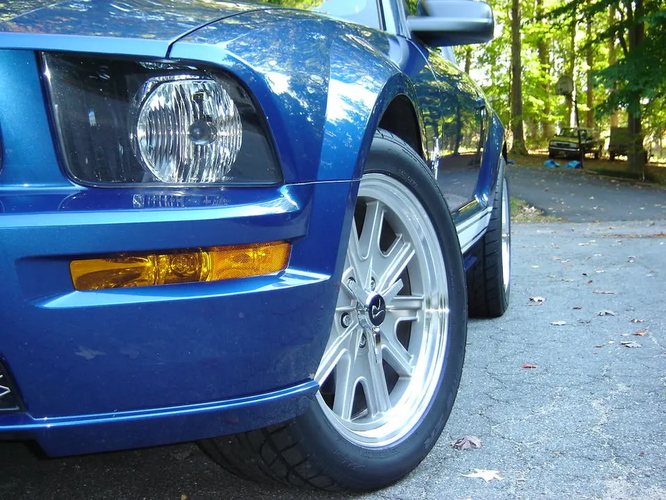

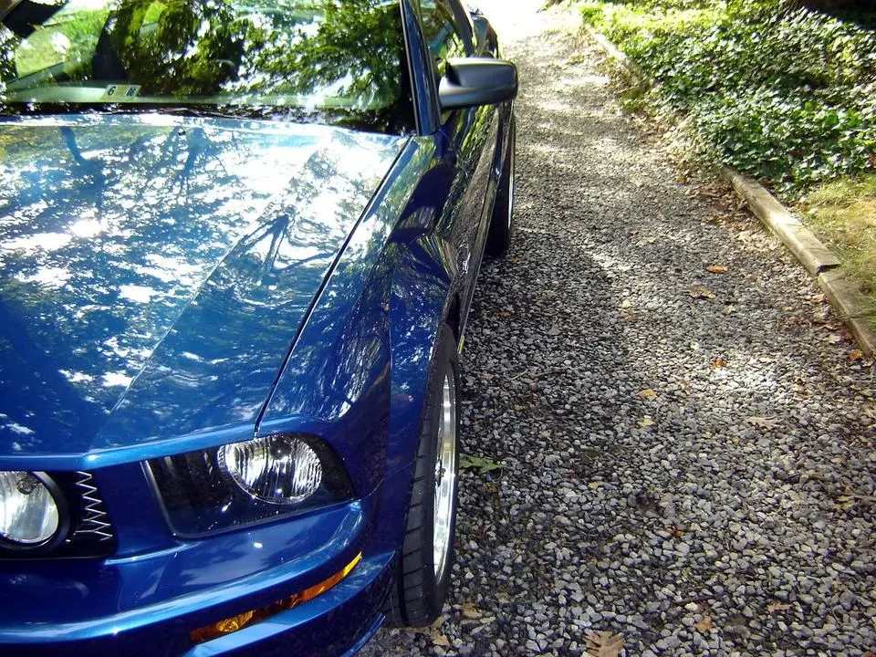

I have a 255/45 on the 18x8.5 wheel and the fit is good, but I wouldn't put it on a 9" wheel.

The 255/50 is only going to be about .5" taller than the 255/45. That only gives about .25" to each sidewall and I doubt that will be enough to overcome the "bulged out" look The 275 would work fine for the back, not sure about up front for handling reasons(the tire may curve inward too much to provide a stable ride while cornering).

COBESGT said:
Is anyone out there running 255/50/17, Nitto NT555's on 9" rims? If so I would like to see some pictures.
Thats what Kooldawg6's above pictures are of...
Supposedly Nitto's tend to run narrow, so the 265's may be a better fit. Looking at Kools pictures though, they look about right.
Dan

From what I can find, nobody sells a 265/45/17. Which I think would be the perfect fit!
If the Nitto's run a little bit narrow, this would make them possibly look worse than what I already have (255/45/17, Falken Ziex 512's). Maybe the sidewall design of these tires gives it to much of a curved look, take a look at the link.
Any suggestions? From Kooldawg6's pictures, his front tires have a decent sidewall contour, but his rims are 1/2" narrower than mine.
Also, please remember that a 255/45/17 tire is 1" shorter than stock. I would hate to find something that would make the size even smaller.

Crap, didn't notice his rims were 8.5" wide... Yeah, as far as 17" wheels, you seemed to be pretty screwed...

I have 255/45-18 on 18x8.5 up front.
