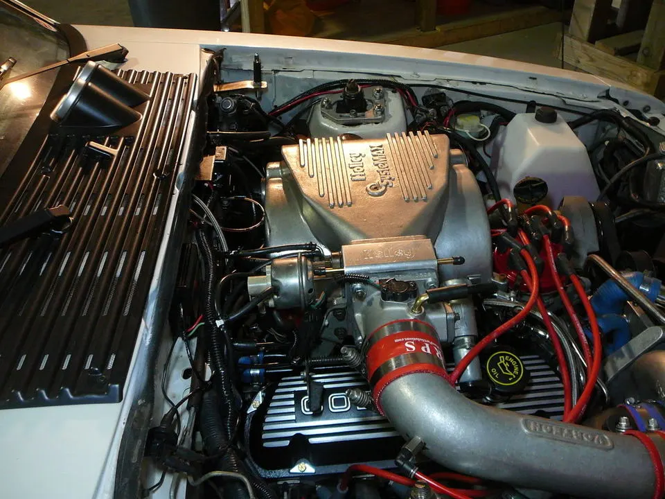

You can ditch all the smog stuff... As for the EGR.. I pulled it off & made a solid plate to block it.. I left it plugged in & the vac line on so the dummy light would stay off..

Hey man you should post some more pics of your ride! Or do you got cardomain or someting? What kinda numbers you putting down? I'm in the proccess of rebuilding mine and its getting that same holey intake as yours as well as the blower. Just curious on what your putting down.
