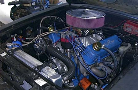

Ah Ha! I found a page with some information.
There is a certain amount of "blow by" from every engine's crank case, the amount will vary according to the ring gap, cylinder wear, compression.etc. A little blow by is normal. Those exhaust scavenged PCV systems also use an anti-backfire check valve between the hoses and the exhaust pipes. You can also do as I did and mount a late model smog pump to your motor that has a tube inlet that normally draws air from the airfilter, but instead can be re-routed to pull a vacuum on the crankcase. I ran the exhaust hose from this back out along the frame on my Ranger to a homebuilt muffler ( they're noisy little f---ers otherwise) mounted behind the back bumper.

If you're referring to why I did this to mine, this PCV system is the hot ticket for race motors now. Ford Racing sells the smog pumps to mount on race motors, to pull a vacuum on the crankcase, this free's up about 7-8 HP cause the pistons are working against vacuum. I had the smog pump layin around along with 20 ft. of used heater hose ( the exhaust for the smog pump) from a 93 E150 Van that I salvaged from a friends wreck. (along with the 5.0 roller motor and AOD trans too) I figured , what the hell, I'll put the pump to work. My accessory drive setup on the Ranger's 5.0 is from an 88 Crown Vic and I was only utilizing only one set of the 2 pulley drive. I mounted the smog pump from the right head, fabbed a stiffener bracket for it and it's driving off the other crank pulley.
