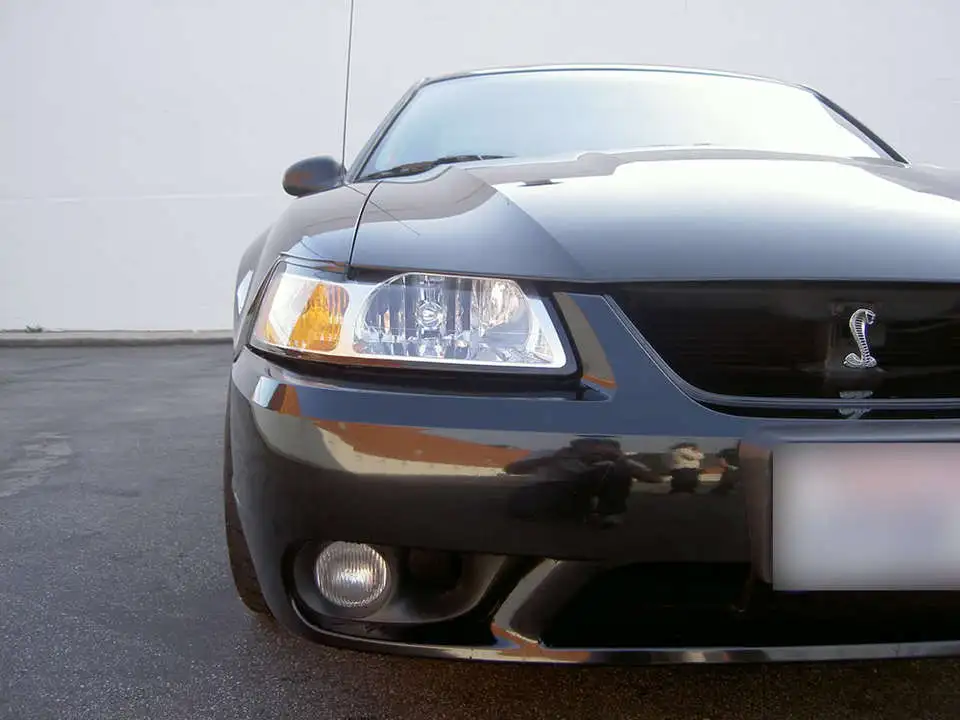

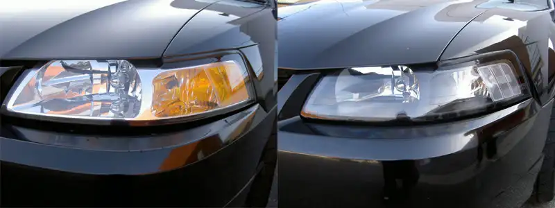

I got a pair of smoked headlights from Mustangtuning.com and was wondering what you all think. I figured I would do a short little install guide to show how simple it was for all who haven't done a headlight swap before. I've always been afraid to upgrade lights as most look pretty ricey; hopefully these don't... I personally think it looks far better than stock. I snapped some pix with the stock lights, smoked lights and stock bulbs, and finally smoked lights with Stealth Bulbs... Enjoy :banana:
-Aaron

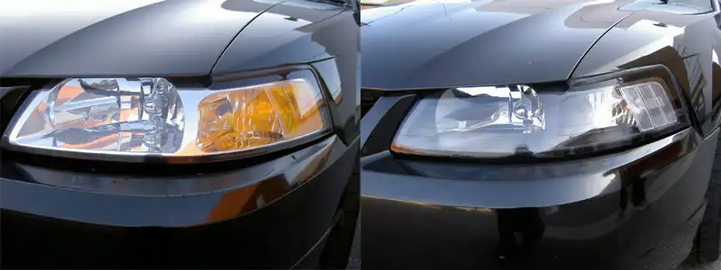

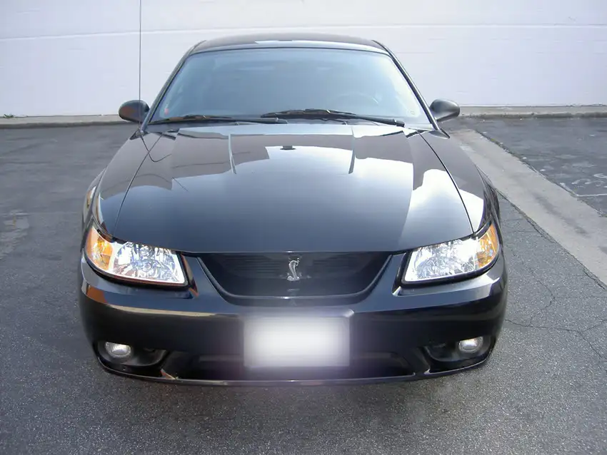

Before and after

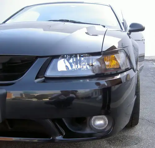

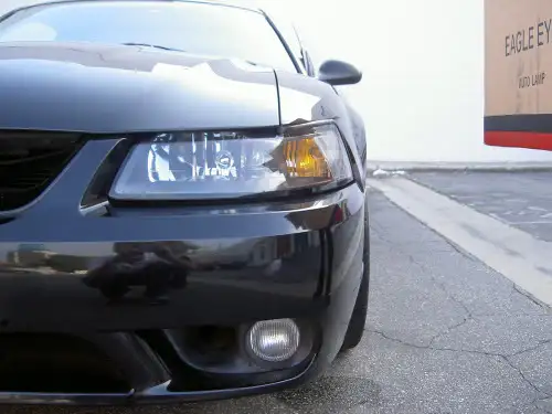

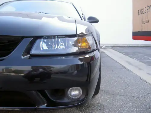

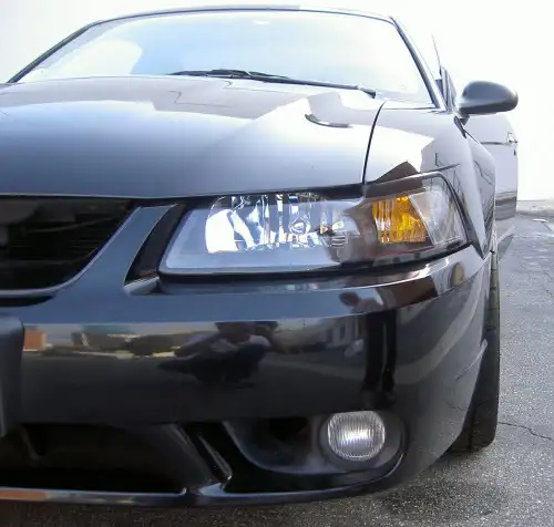

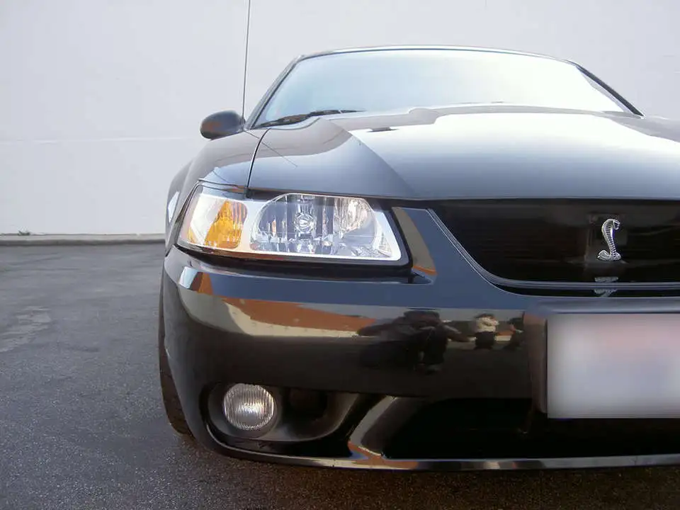

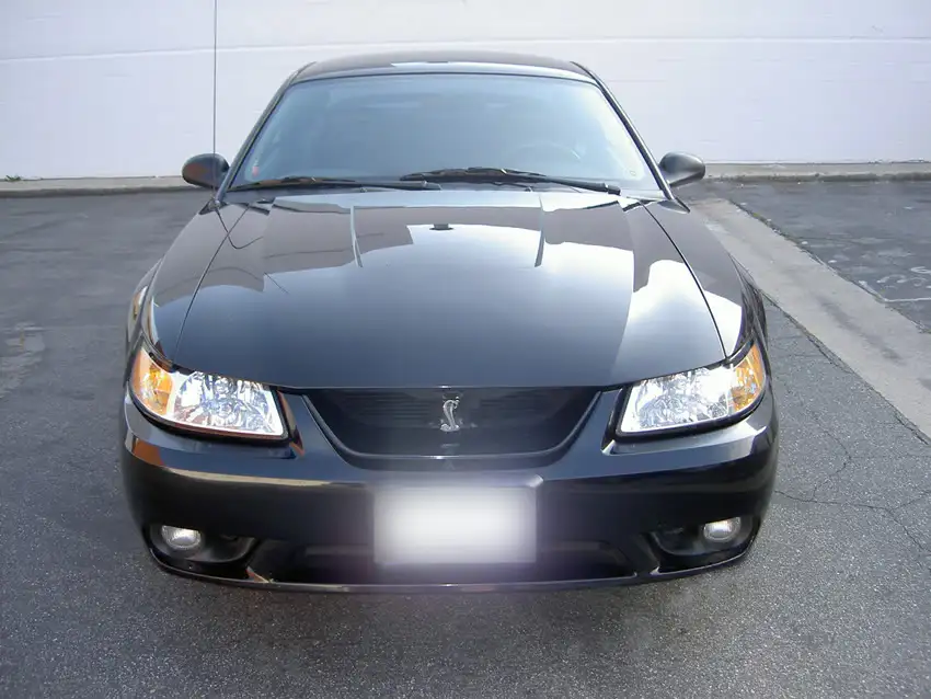

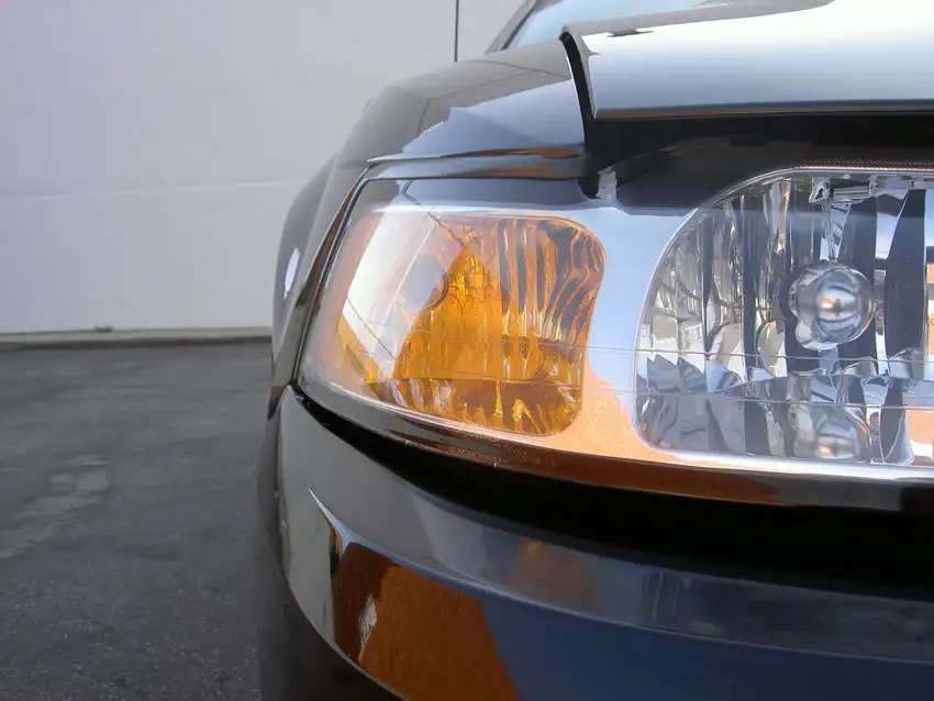

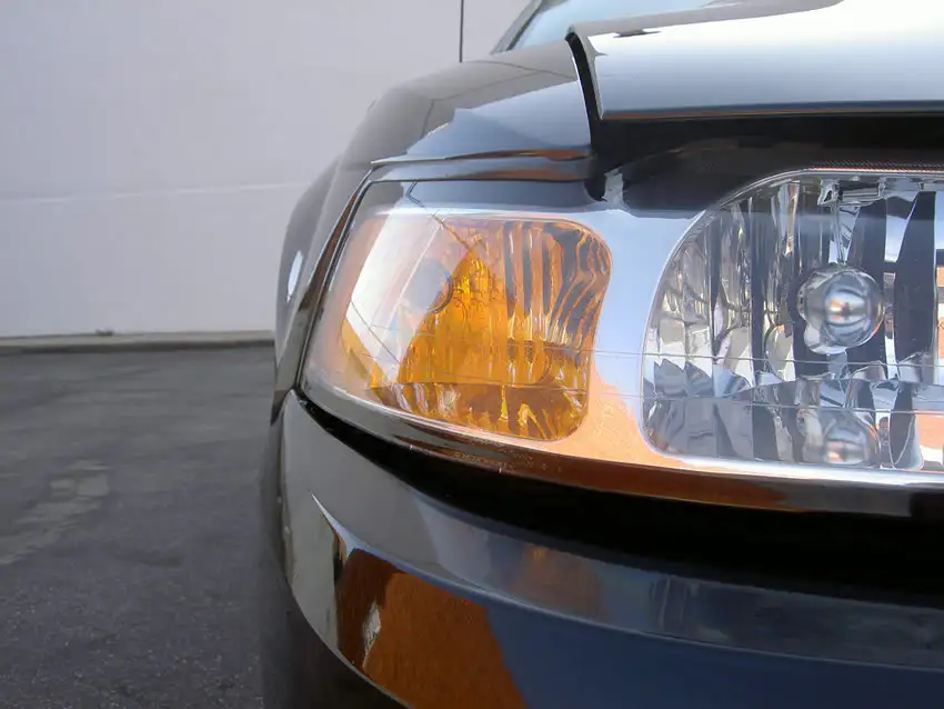

Stock headlights
Bye bye amber :xpl:

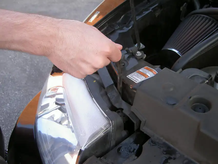

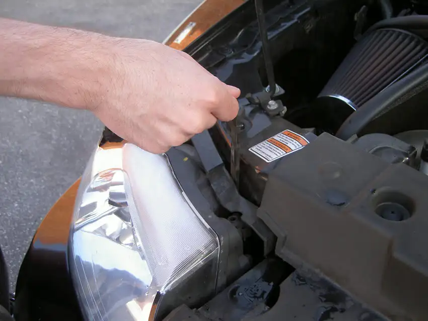

Pull the headlight pins out

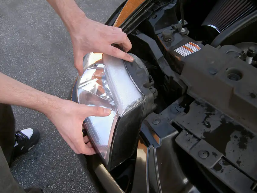

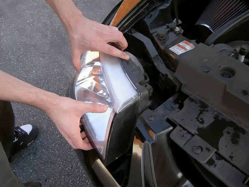

Slide headlight out

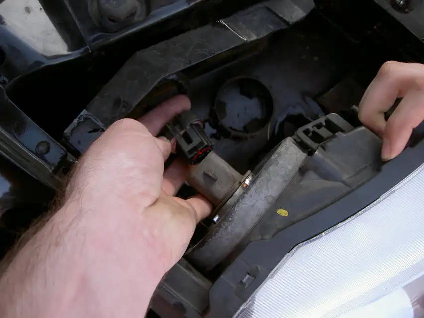

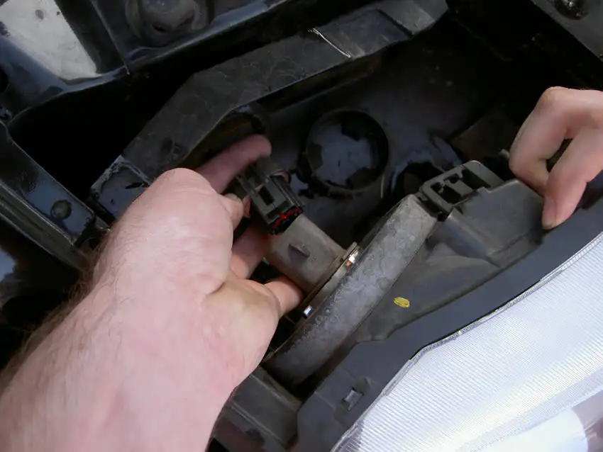

Disconnect wires

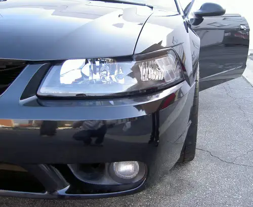

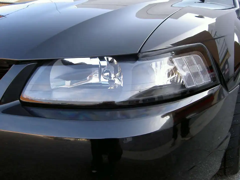

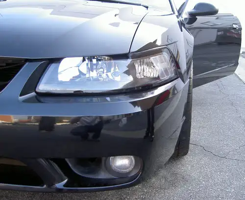

DONE~! :D

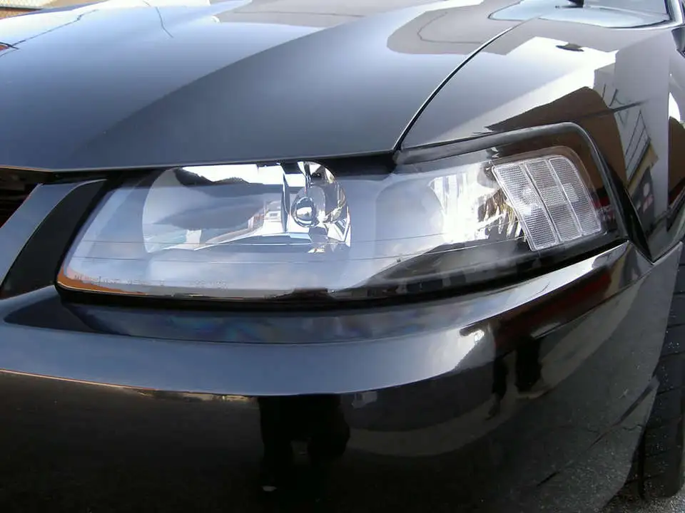

With Stealth Bulbs in
Please look at the LAST PICTURE above. There is a small gap between the headlight unit and the top front part of the pointed section of the front fender. The rubber seal that's on the headlight unit is not all the way up and "flush" up against the front pointed part of the fender.
My 02 Mustang has the same exact gap in the headlight unit, but the gap is much bigger than the gap in the picture. I have that type of gap, but a much bigger one on the passenger side head light unit. The driver's side headlight unit also has a gap, but it's not as bad as the passenger side. This gap has been in existence ever since the body shop took off both head light units and put them back in their place after my front bumper was repaired and repainted.
HOW can I make both head light units "flush" up against the top pointed front part of the fender again and "eliminate" the BIG GAP that's currently there right now? I took the car back to the body shop and they were not able to make the black seal on the head light unit sit flush up against the fender. There is still a gap between the fender and the black rubber seal on the head light unit at the front pointed part of the fender area.
Please look at the last picture above to see what I am talking about here.
Is there any way to make the seal flush up against the front pointed part of the fender again like it was BEFORE the body shop took off both head light units on my 02 Mustang?

I know exactly what you are talking about as I had the same "fitment issue with my replacement lights I bought. My solution? I used the same adhesive silicon along the gapped part (sealed it really good too. THEN, put that edge part in a vice with some napkins wrapped over where the vice was squeezing the edge of the light together as not to damage it. CAREFUL THOUGH, dont want to tighten the vice too much as it will crack the plastic. LET sit overnight. VOILA!!!!!!!!!!!! Flush headlight
Also, in addition to my extra sealant around the edge of the lights, I cut out some thin layers of rubber matting (it was actually used underneath the shingles of my garage roof). Anyway, I precut the pieces of the rubber mat and sit them on top of the headlights as any rain that runs in between the crack of the hood and fender will not go behind the headlight and chance somehow getting in the light. Overkill, Im sure but I havent had any condensation since.

looks like yours fit a bit better than mine do. Same place...
Only my drivers side has issues, doesn't sit flush with the body even with a lot of hot water and trying to shape the seal. Its about 1/4" away :(
