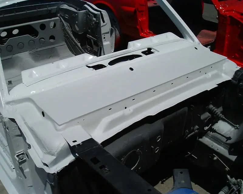

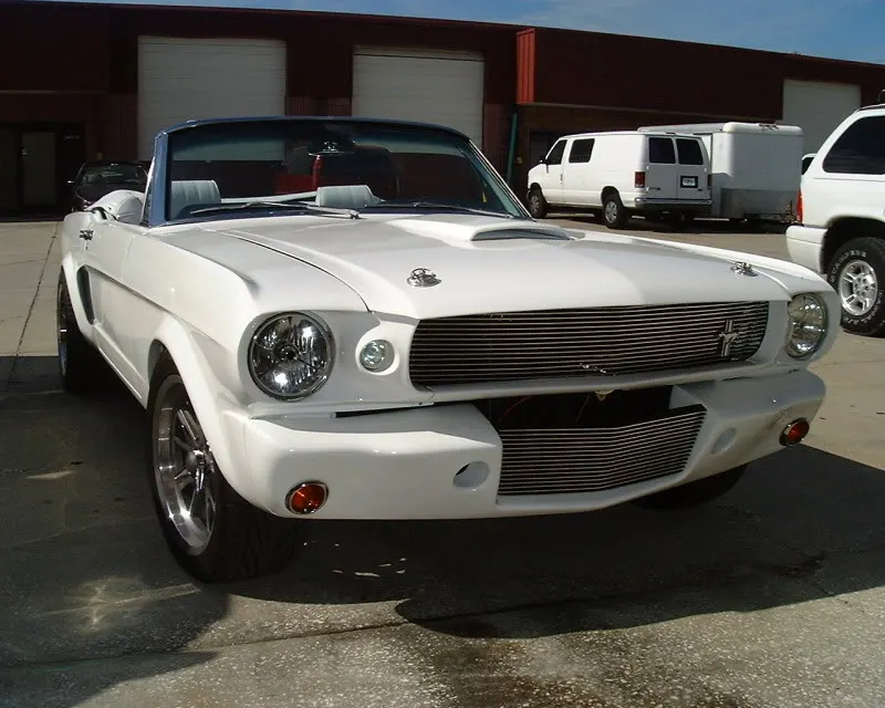

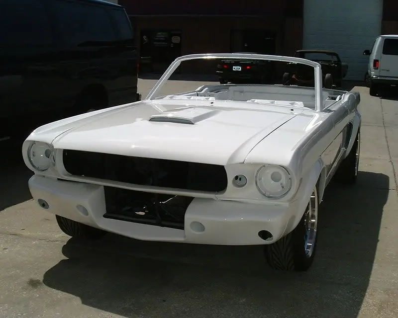

Im in the middle of ours now on the 66 I had rust on the fire wall so I cut that out only to find rust holes in the lower Cowl yea..Were doing a smoth firewall I hadnt condsiderd smothing the cowl also I would like to see some closer pics before I comitted to it..Good thread :)
That looks great, Rusty. However, while I can appreciate that the southern climate doesn't require heat or defrost, you limit the marketability of the car to the south. Here in the north, we need heat in the winter and air in the summer. Perhaps I'm a purist, but I think replacing or repairing the rusted cowl is a worthwhile venture, even if you only open the sides rather than replace the entire cowl.

Where in "H-E double hockey sticks" are you finding those 454 wheels? :bang: Did you buy up the whole last run of them, or are those the ones off your 68? What size and backspace are they and would ya help me find some?
Cool Pics, Thanx,
