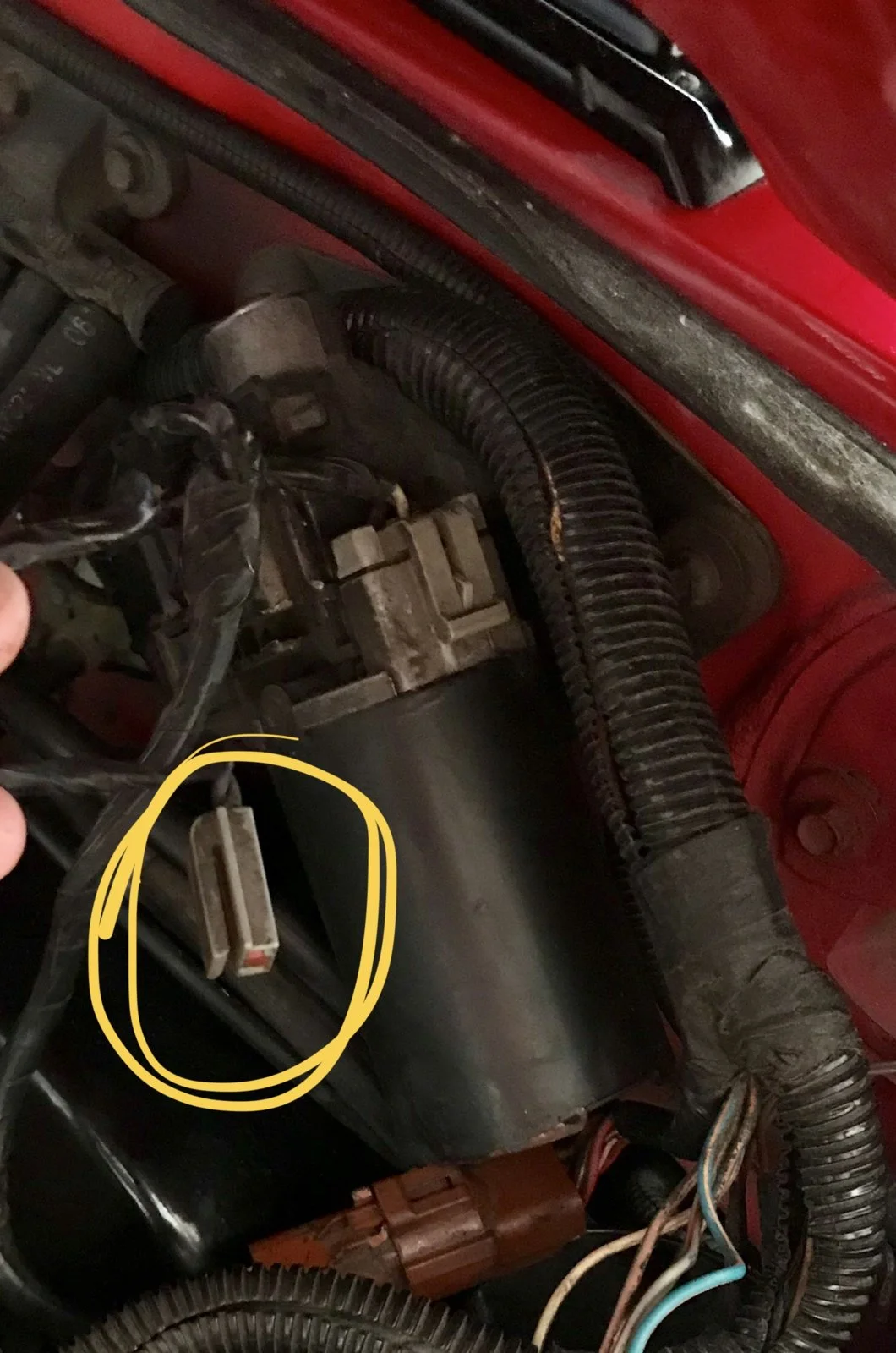

What starter are you using?
It’s this SVE oneWhat starter are you using?
Cool I’ll have to give that a go tomorrow afternoon. It’s loud and sounds ugly once it cranks on and running. I’ll post some stuff tomorrow thanks for the input, appreciate it.Mine is a ford starter from a 92, looks like that, works fine, pull it off and show where it hitting, it's possible the solenoid thingy is sticking.

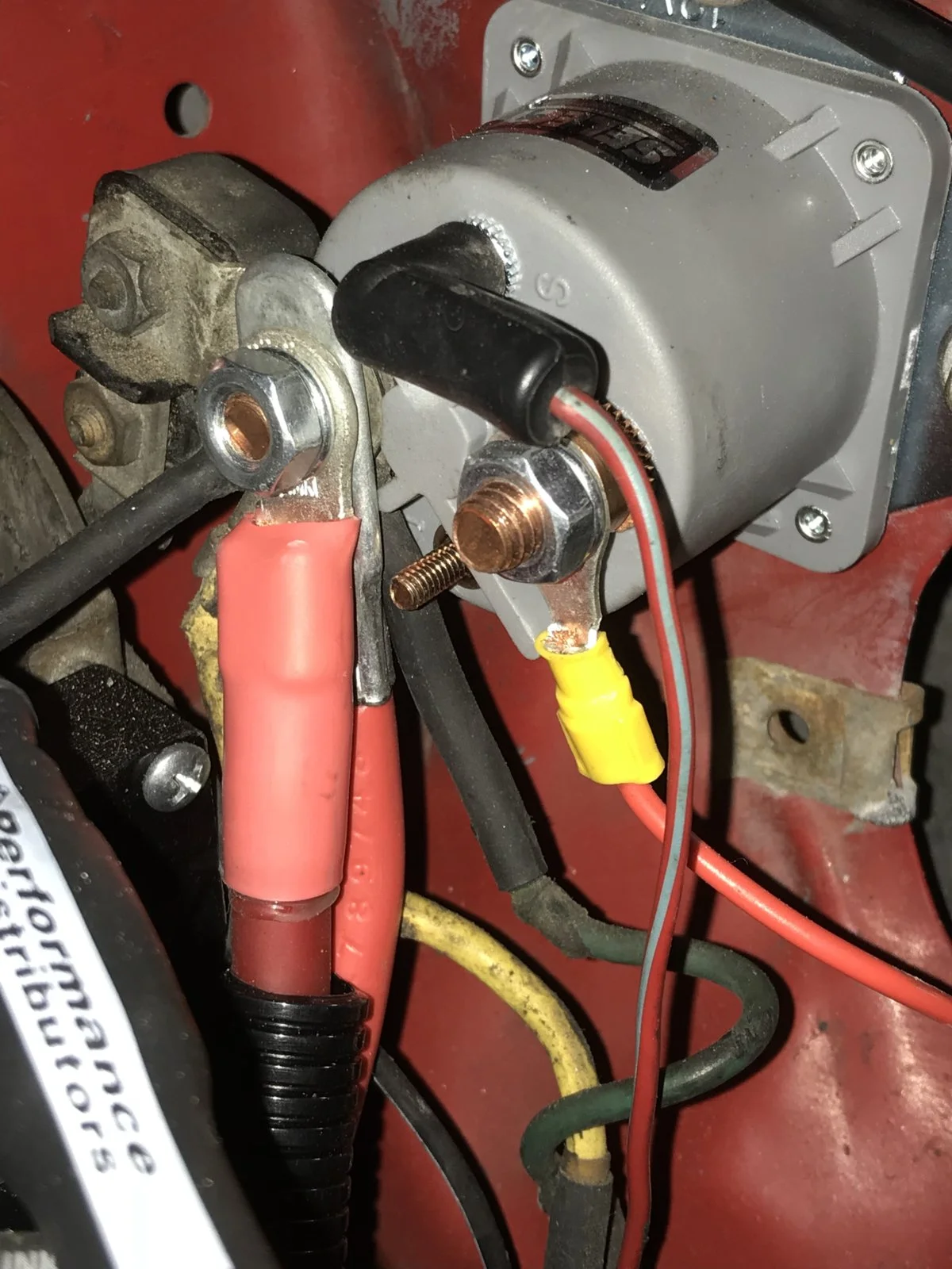

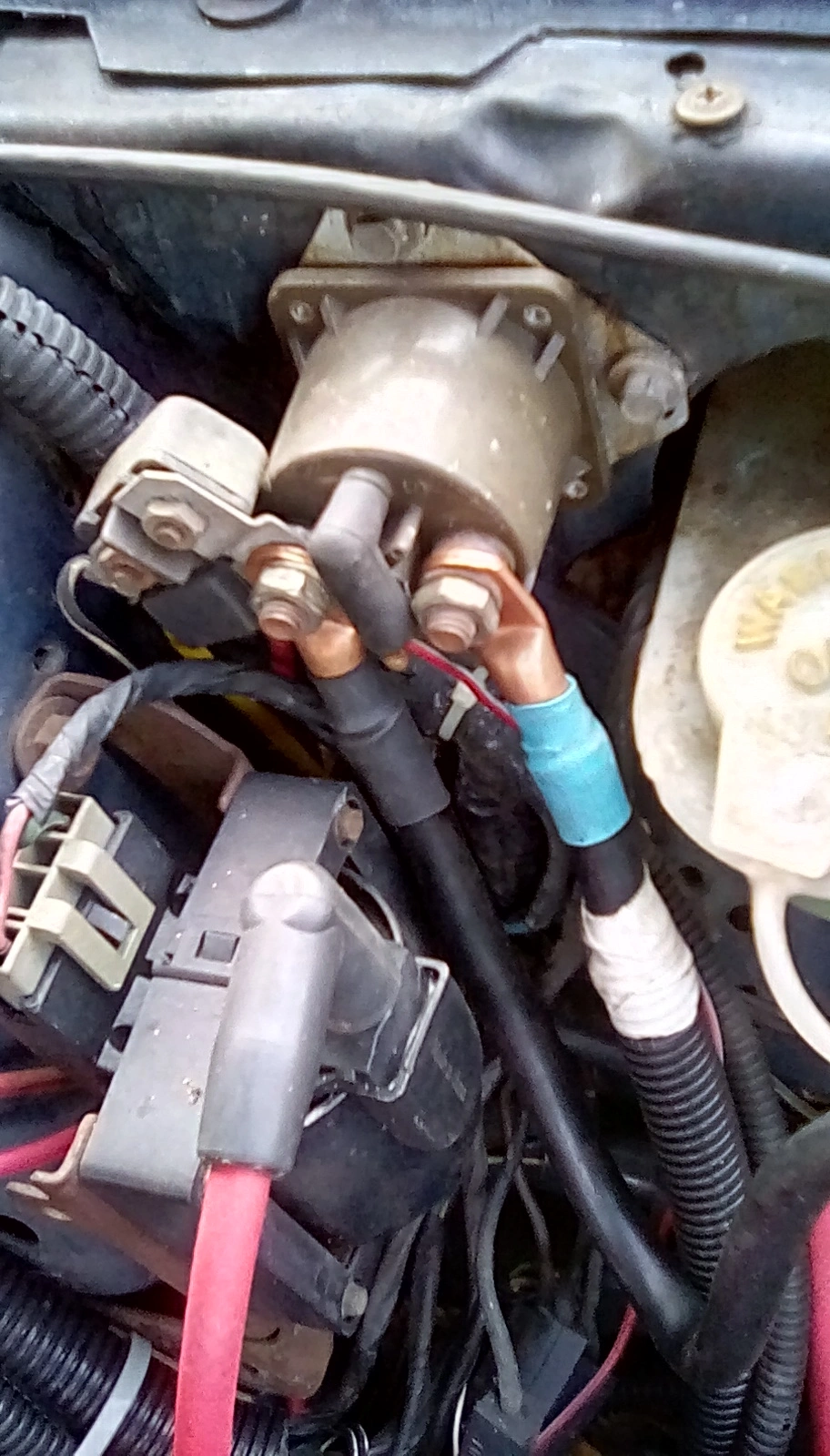

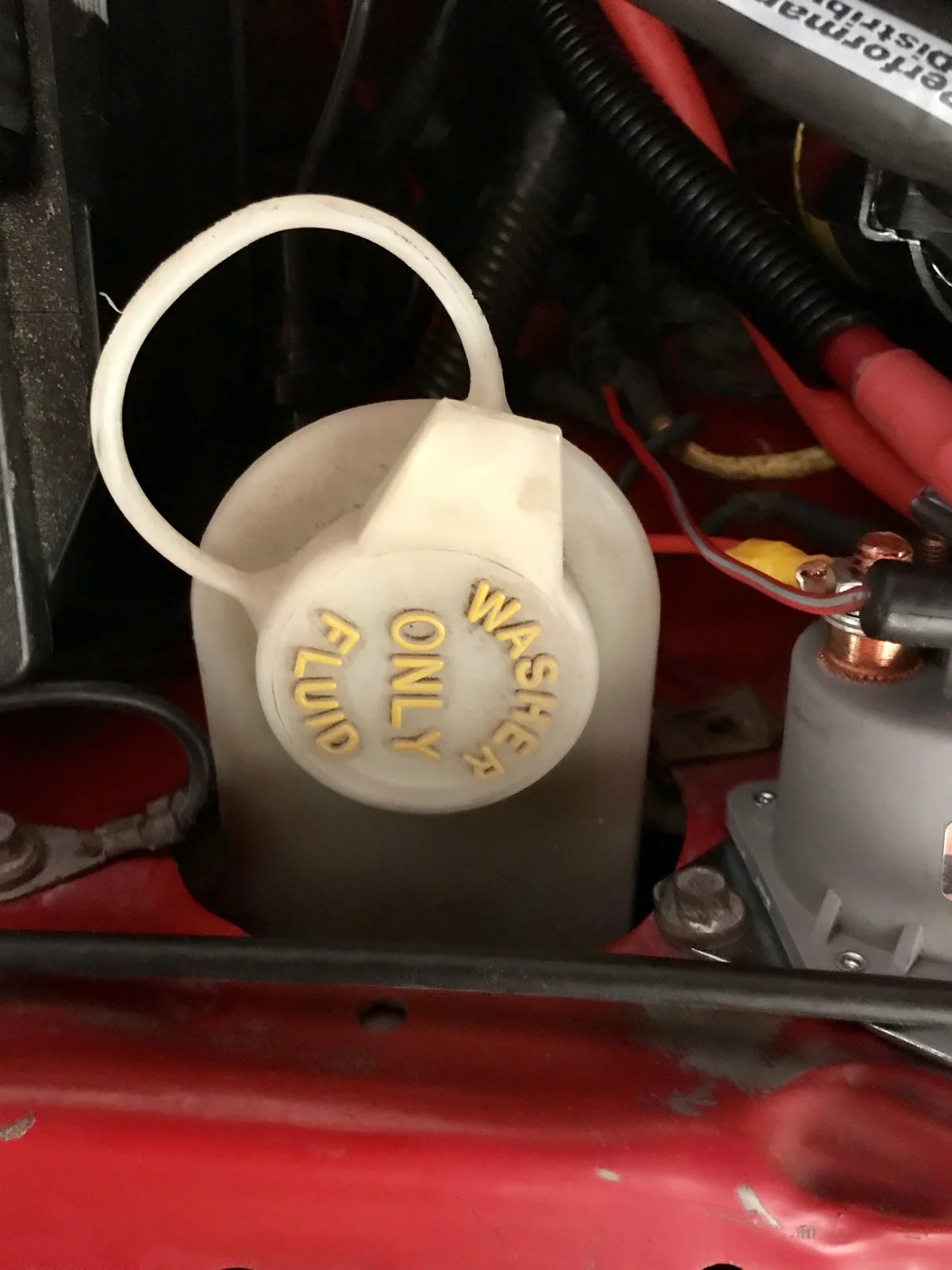

So I believe that’s how I have it set up on mine. I have big starter cable and everything else etc to the left side post and then just the small red cable that runs from the starter solenoid to the fender solenoid which is by itself on the right post.The first time i went mini starter i had an issue where the starter would stay engaged for a while after starting.
The way i fixed it was by putting the big starter wire on the same side as the battery wire on the stock solenoid and running the small wire to the other post of the solenoid.
I found that if its run directly to the red/blue stripe ignition wire it will stay engaged too long....grinding on the flywheel.
Check your wiring..
