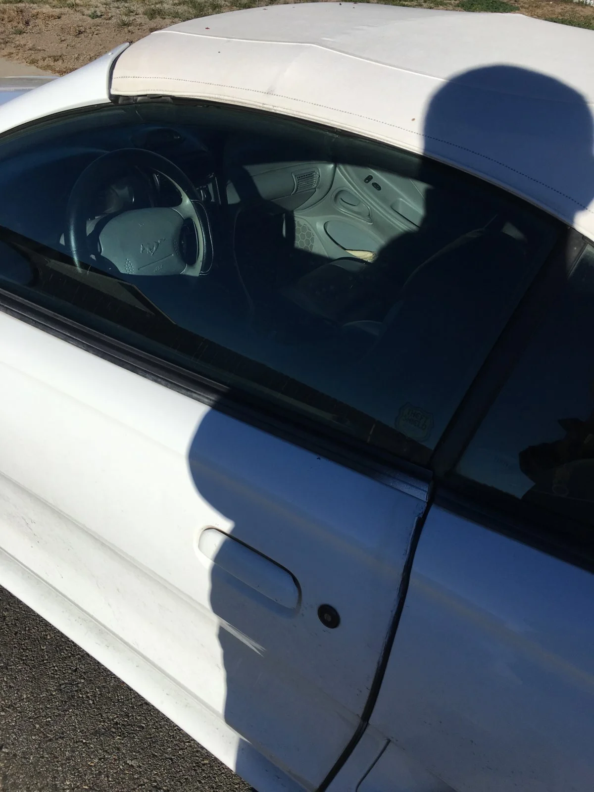

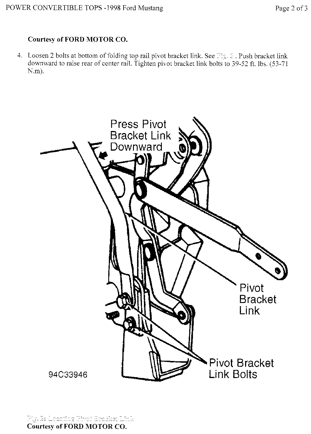

J Jack bear New Member Oct 5, 2018 2 0 1 Alamosa Colorado Oct 5, 2018 #1 Oct 5, 2018 #1 My frame on my 97 mustang convertible sags on the passenger side window I’ve tightened The v-notch? But nothing anyone know other ways? Or clearer instructions.
J Jack bear New Member Oct 5, 2018 2 0 1 Alamosa Colorado Dec 17, 2018 #2 Dec 17, 2018 #2 Anyone know how

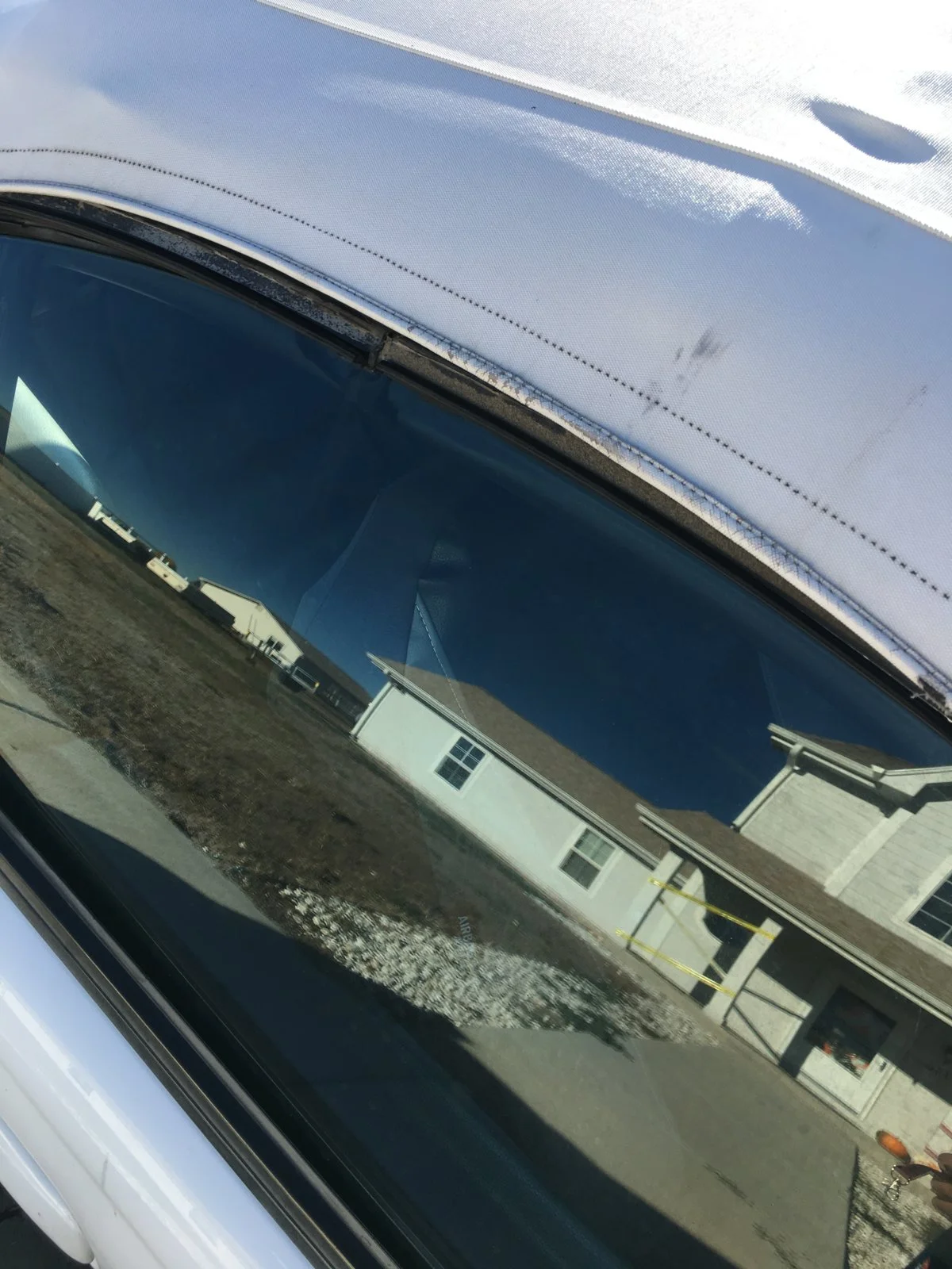

kiddiccarus The first widely accepted Tranny Dirt-Old 20+Year Member Dec 24, 2003 1,793 1,119 143 30 Mins from a Ragged GT Dec 29, 2018 #3 Dec 29, 2018 #3 Is that Crime scene tape in the reflection?
