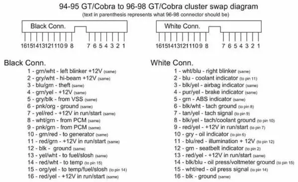

Hello All Fellow Stangers,
I am in need of some hands on knowledge or just stang genius.
I have a stock 95 GTS and the dash wiring was severely molested. So I decided to put in a complete 96-98 GT dash. (couldnt find a 95) I have the original cluster and googled the part number, so it is a 94-95 gt cluster. My Question is: Will I have to repin harness or change the 96-98 dash harness out with a SN94-95 gt harness? I am only asking this question because i am not getting the correct charging from the battery/alternator. I have changed alternator,battery,checked that I had all grounds,checked cluster battery bulb and others and made sure resistor on cluster was reading correct ohms. Any help with this or diagrams would be greatly appreciated. I am out of ideas and frustrated as all get out.
Thanks again for any replies
