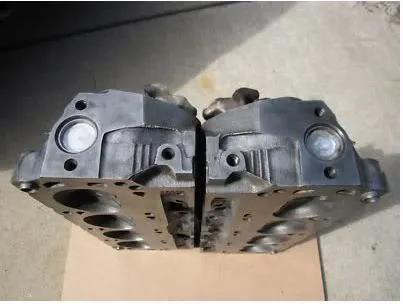

GT40 heads have 3 bars cast into the front or rear sides of the heads.
attachments\604454

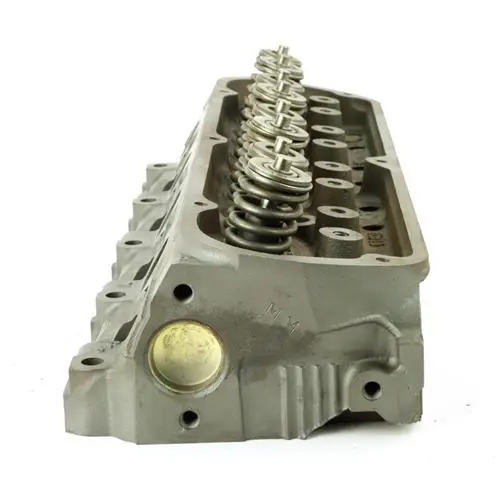

GT40P heads have 4 bars cast into the front or rear sides of the heads.
attachments\589096
attachments\605996
GT40 heads have angled spark plugs, flow slightly less than GT40P. Stock and aftermarket headers fit with no problems
GT40P heads have flow slightly more than GT40. The straight spark plugs mean that some aftermarket headers don't fit properly and spark plug wiring may be very close to the headers and burn easily
