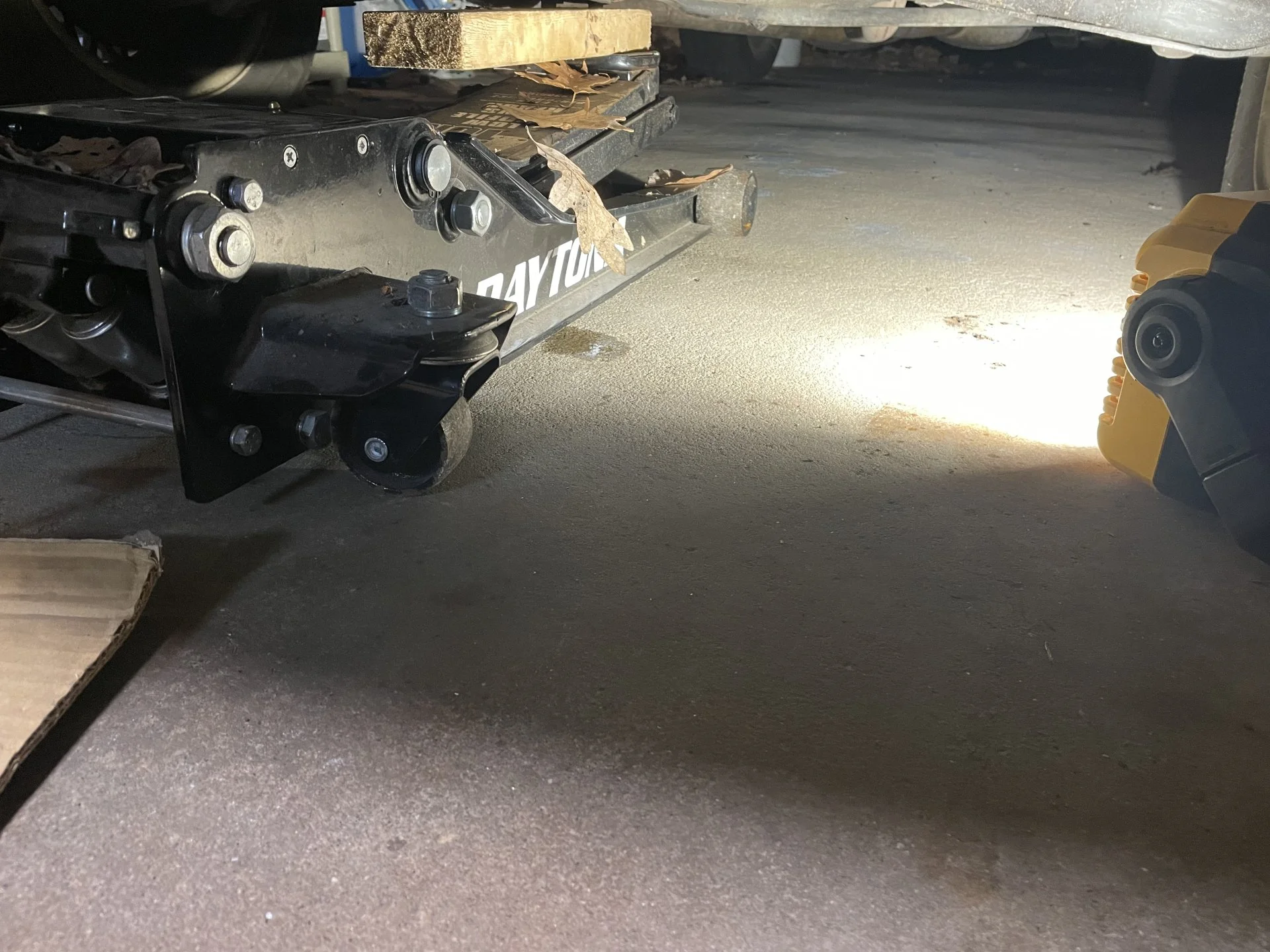

Remember that block of wood I used with the jack and the k-member? Well, it decided to stay on the car and come in the test drive with me. Made it out and all the way home before I took it off

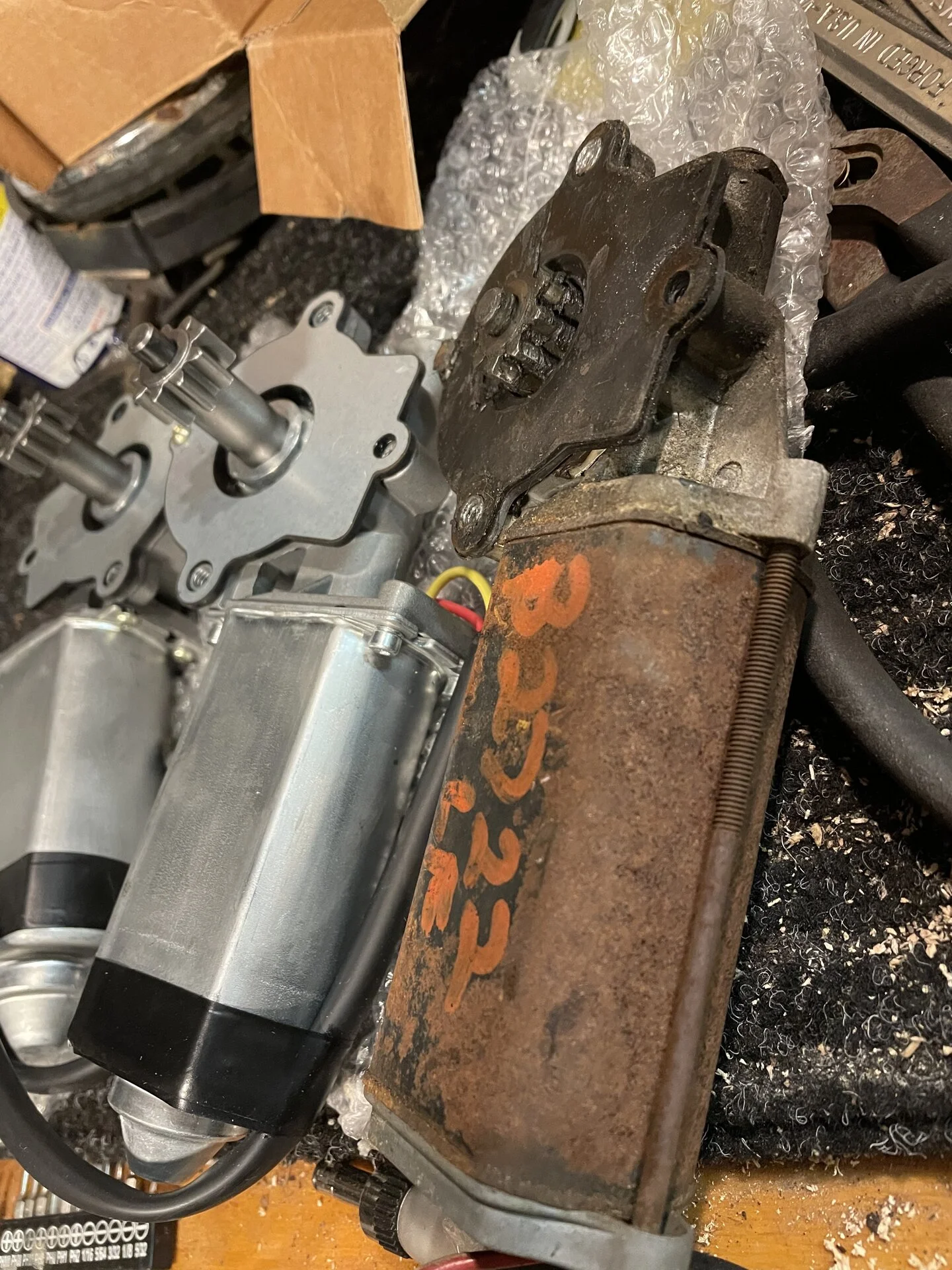

Starting to work on the power window motors

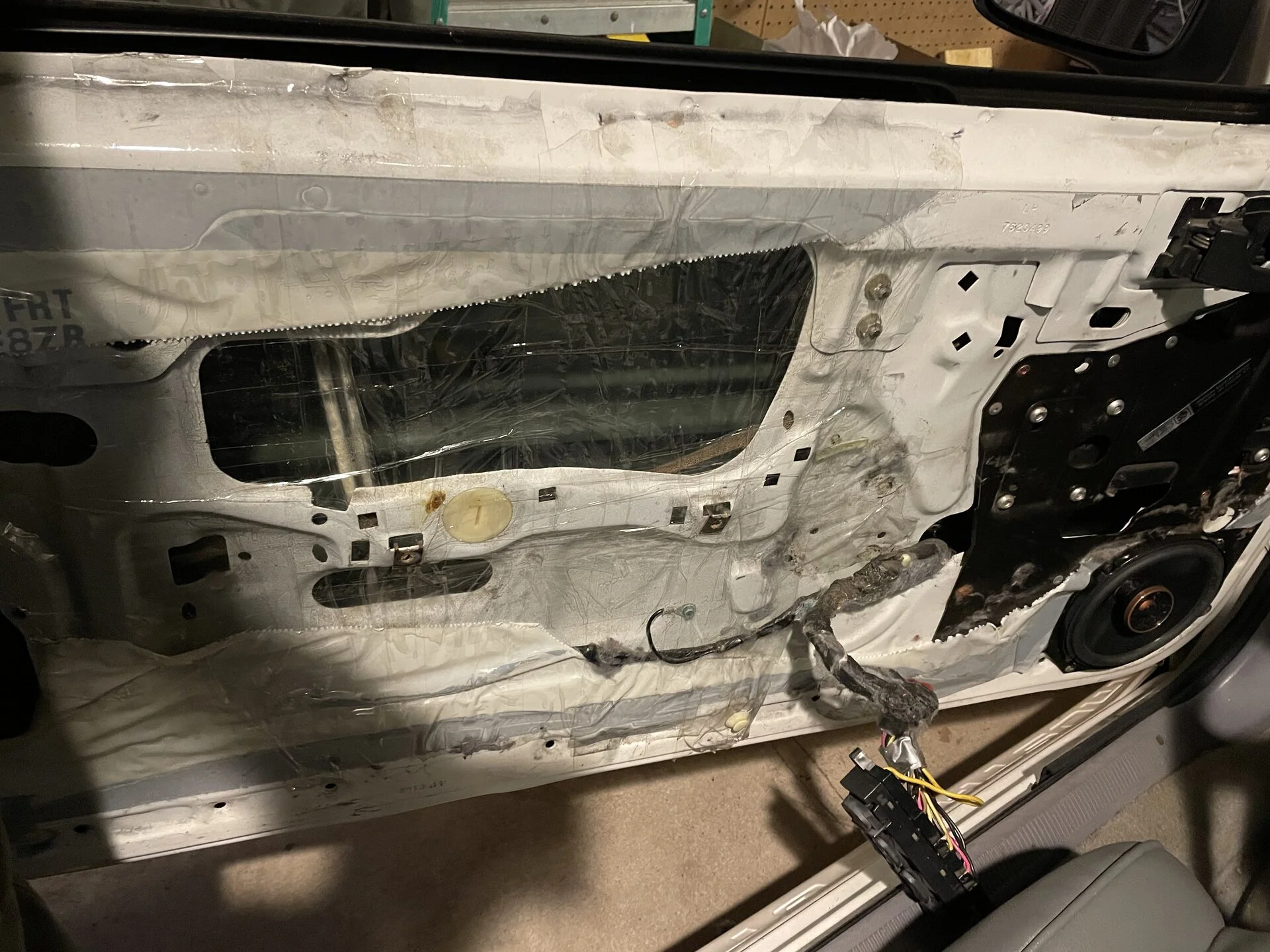

1. Windows all down. Only 1 driver rear motor even turns over. The rest are dead. What’s the best way to bring up the windows?
2. Here is my naked door. Should I have some sort of material or deadening? Is that stuff worth it?
That stretch wrap is not factory. Usually only a craft paper/tar paper kind of vapour shield under the door panel. They usually get destroyed and not put back on.

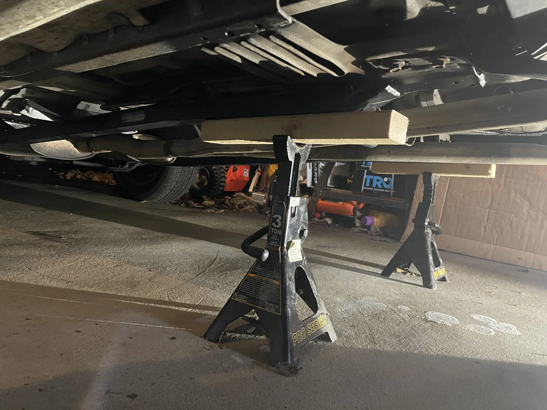

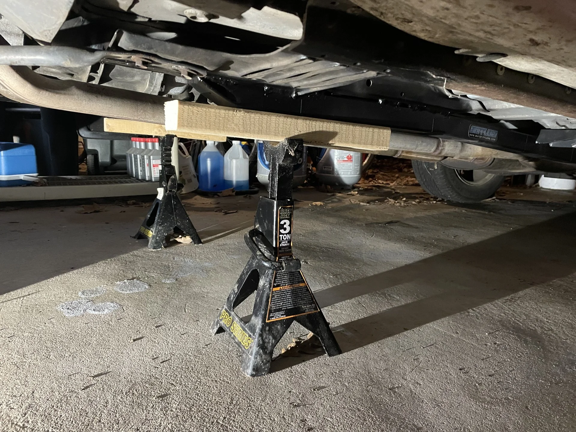

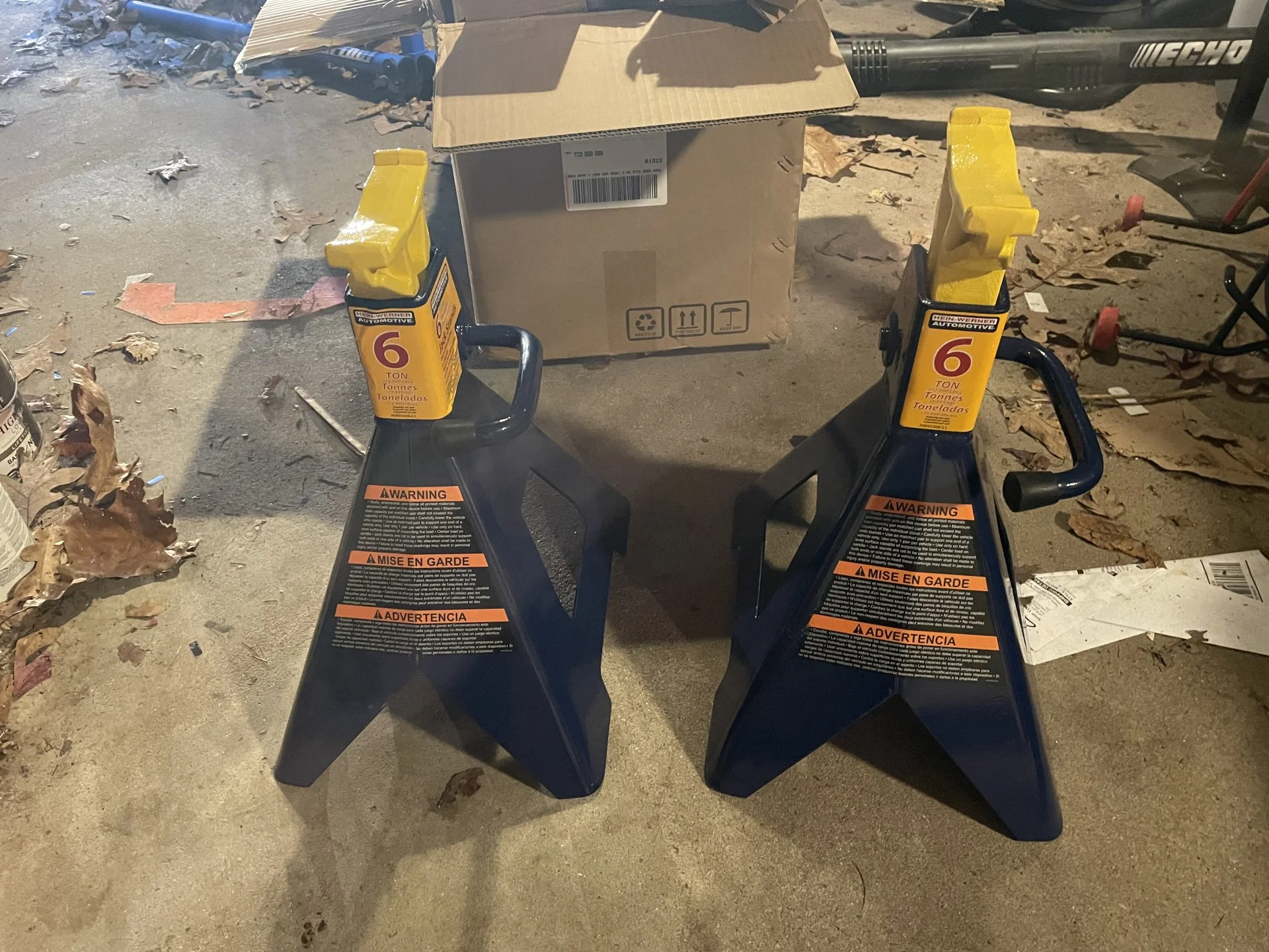

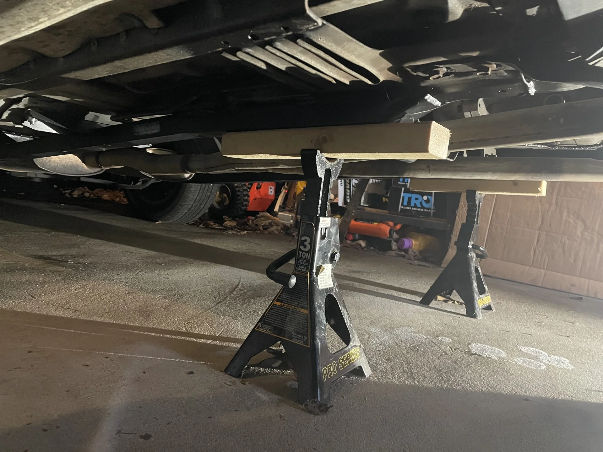

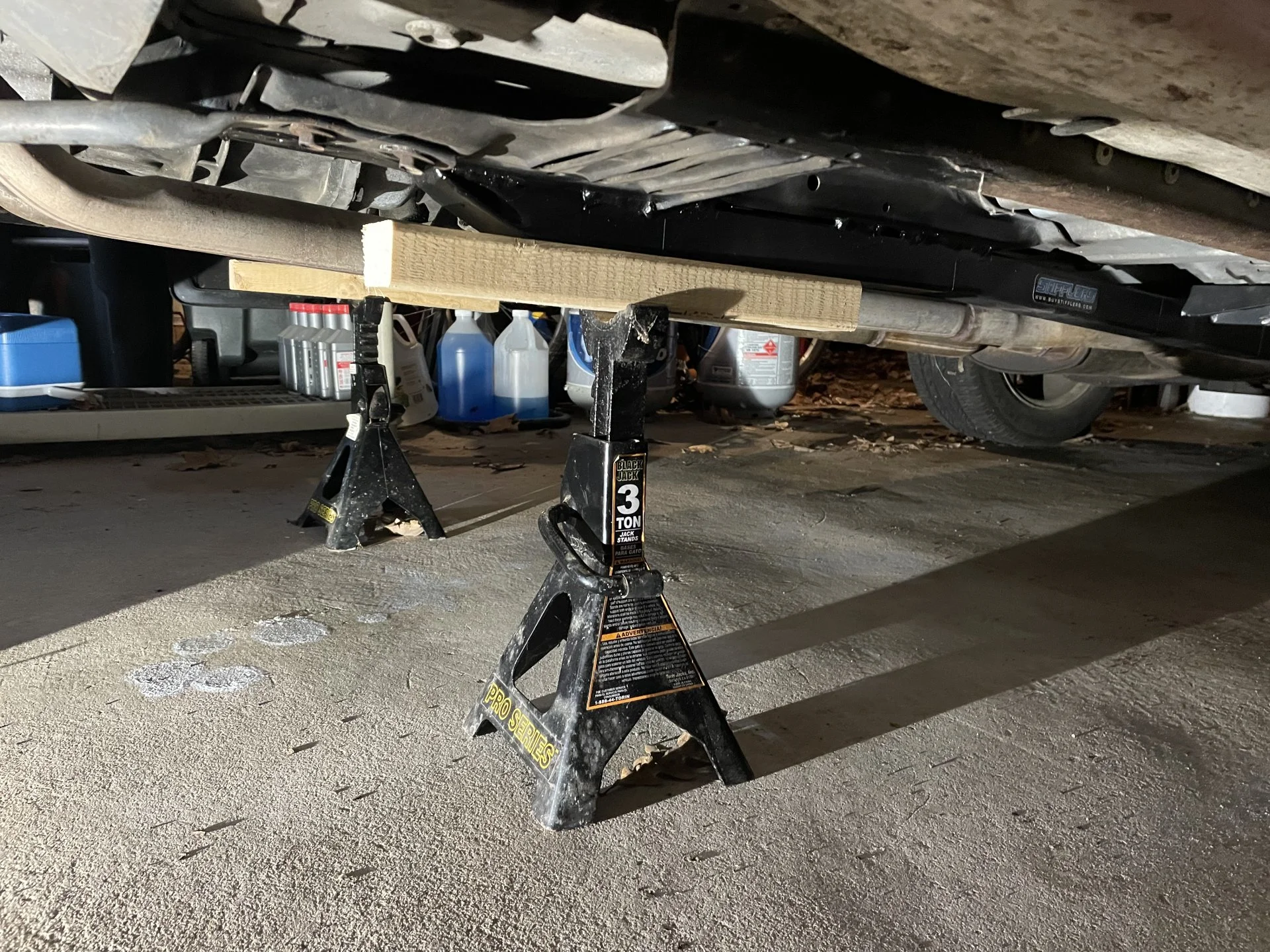

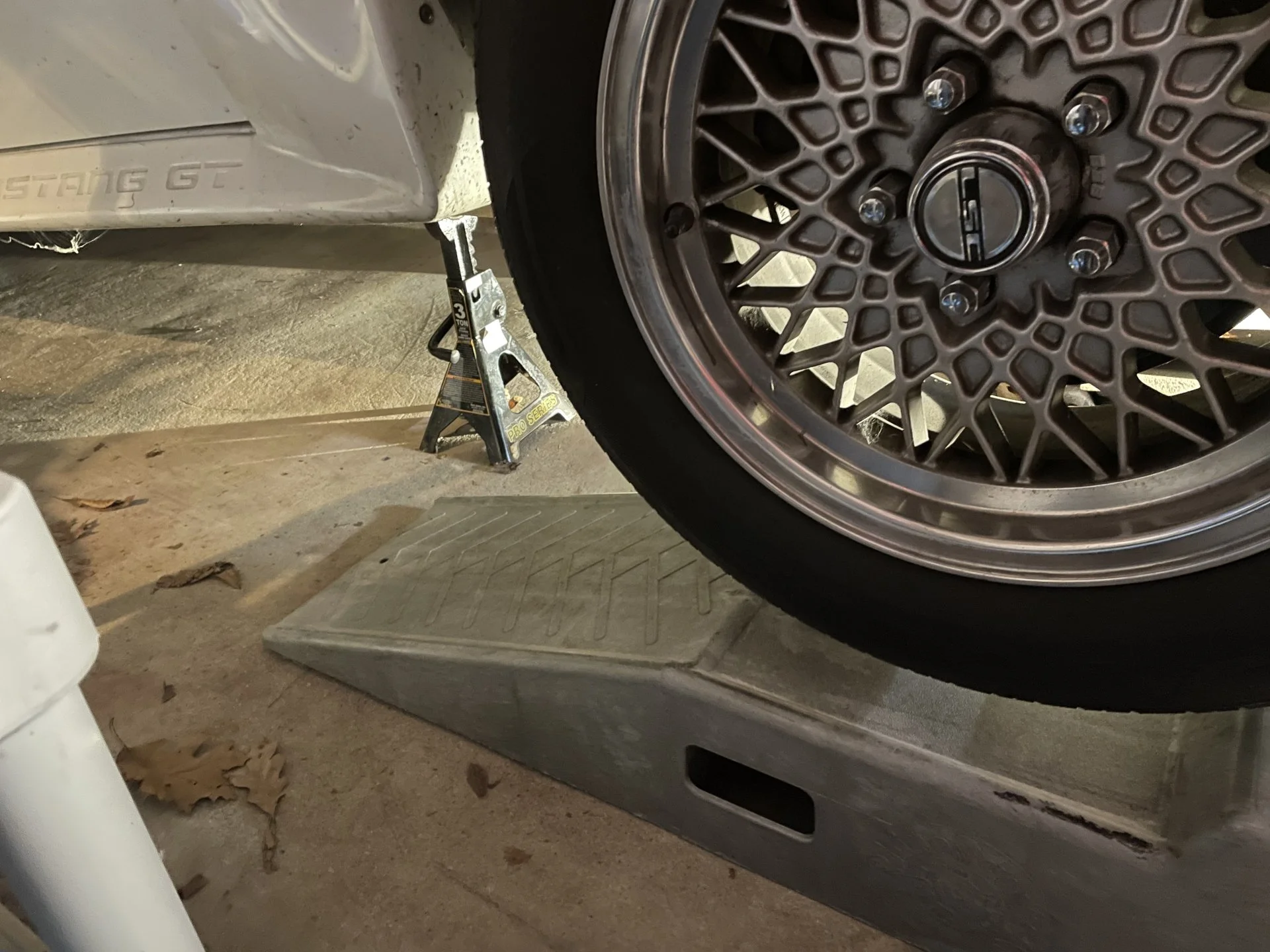

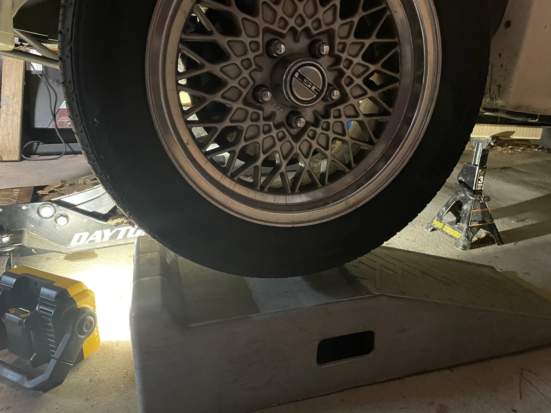

Rate my jack points.
Yea, the 6 tons were way too big. Maybe I’ll use those in the rear.
Also added the ramps just to be safe. Assuming I will want to take off tires at some point, which is why I didn’t use them for starters.

The good news is that I finally finished the summer beer. I hope that explains the level of procrastination I am capable of.

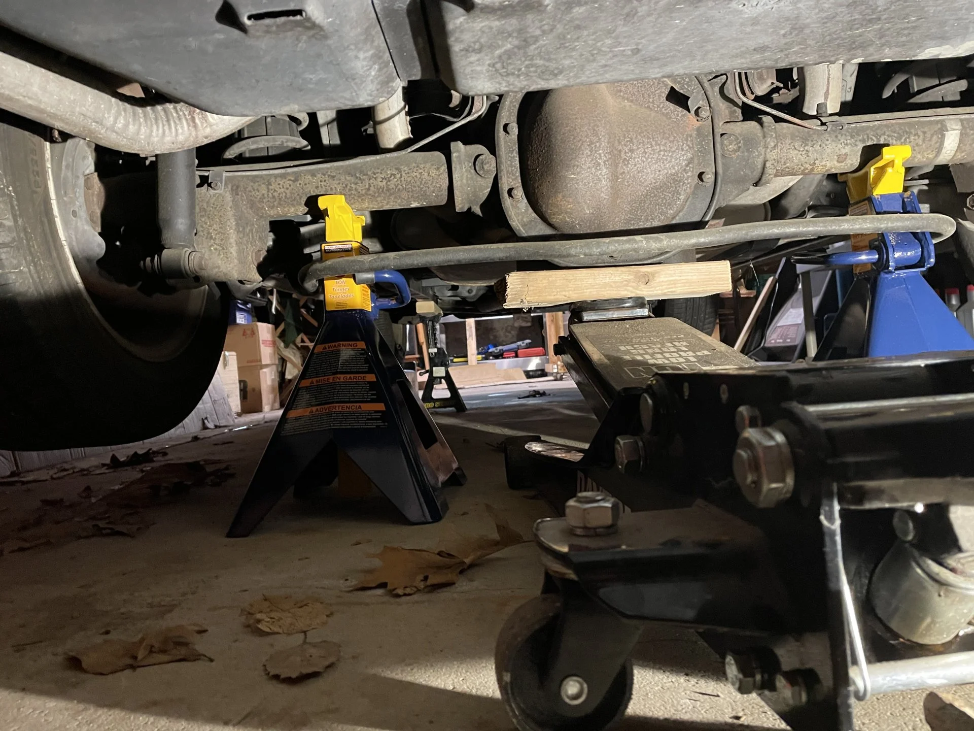

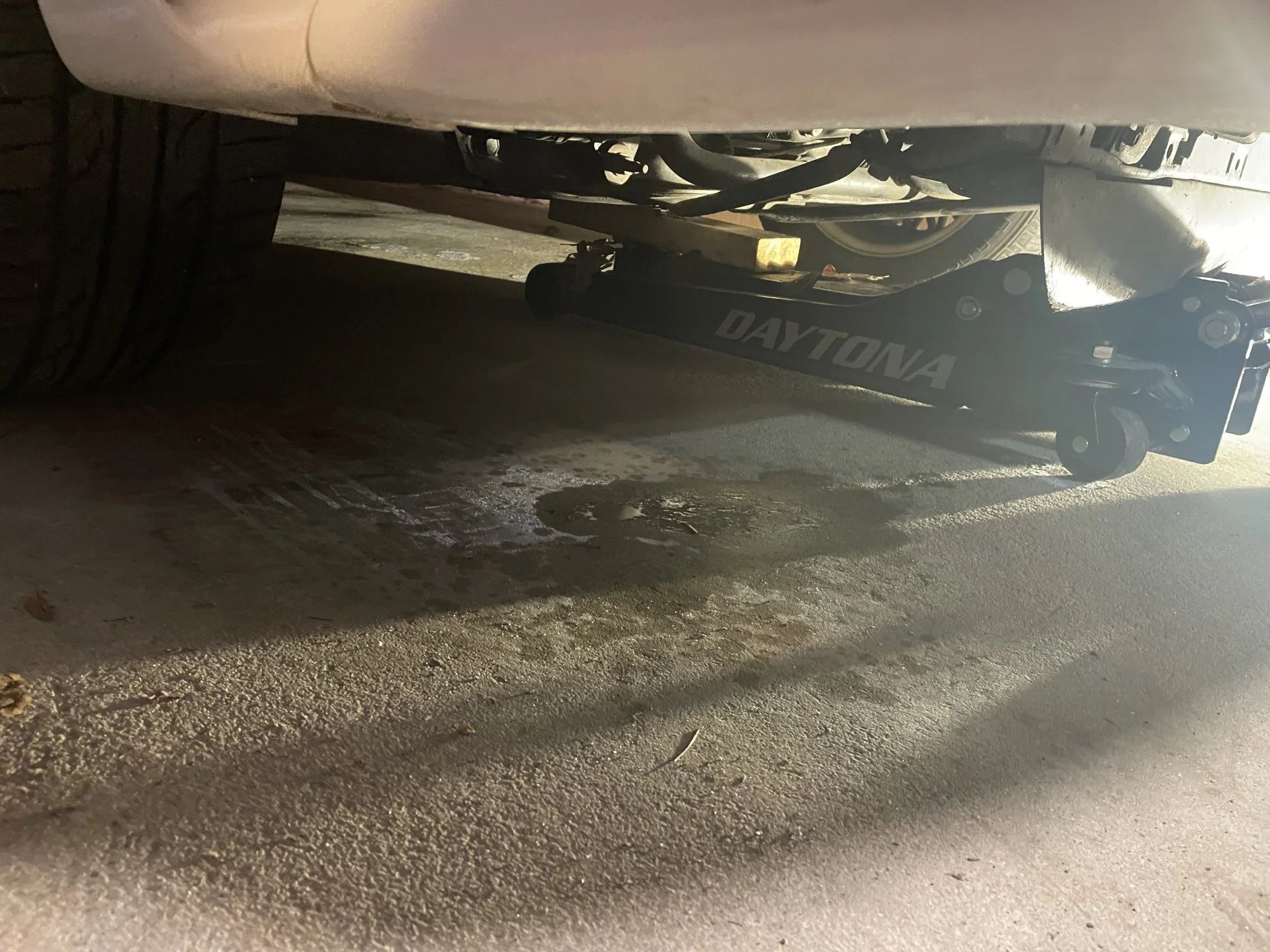

Jacking up the rear from the pumpkin. Though I read about the 1 degree of negative camber that could cause the fox body to blow up. I say bring it on!!
I’ve hit the beer point will I won’t be going under the car. I think I have a safe level of paranoia when it comes to vehicles falling on me.
