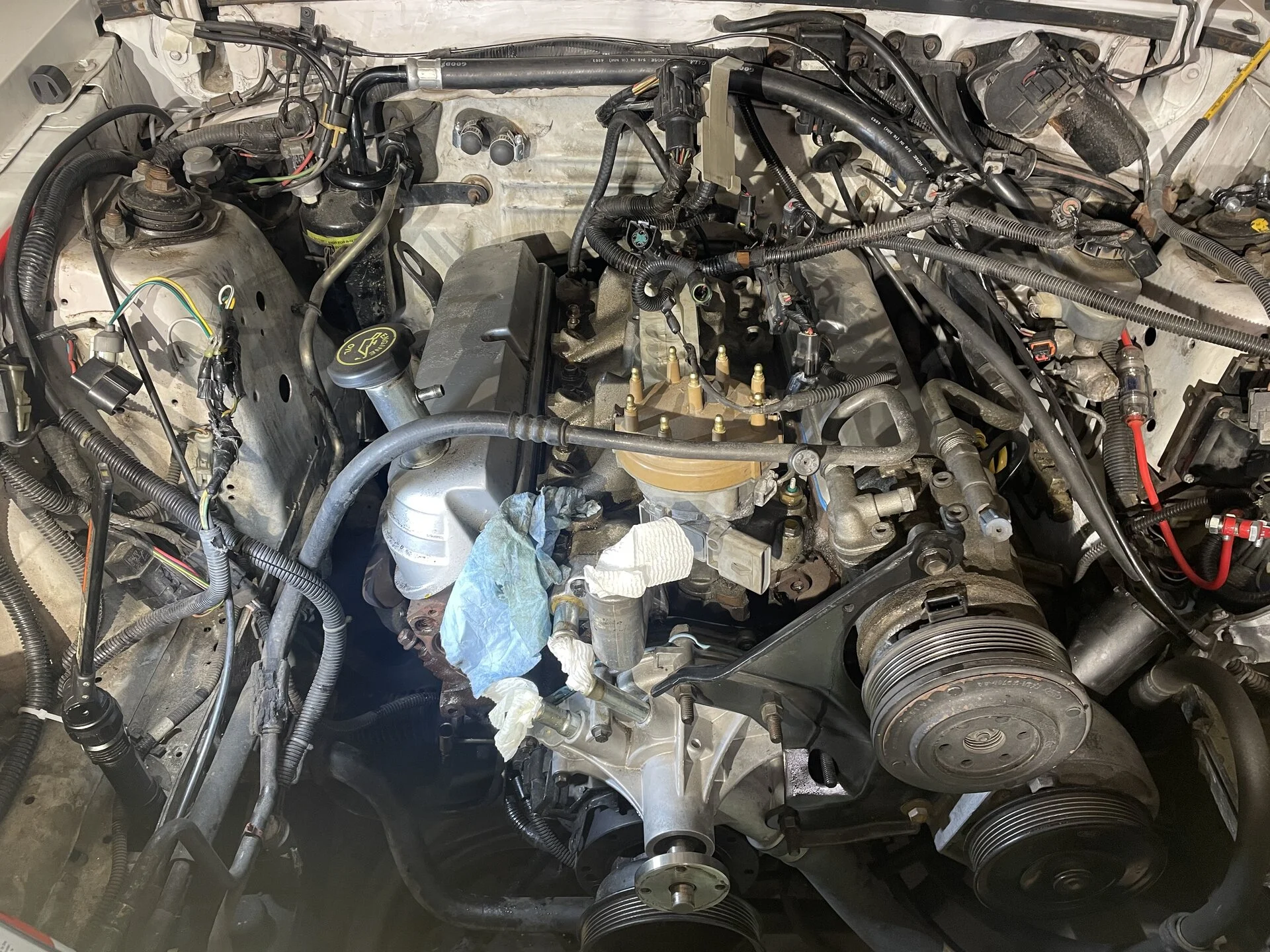

Progress Thread Snow - 93 GT Vert. Prepping for sale

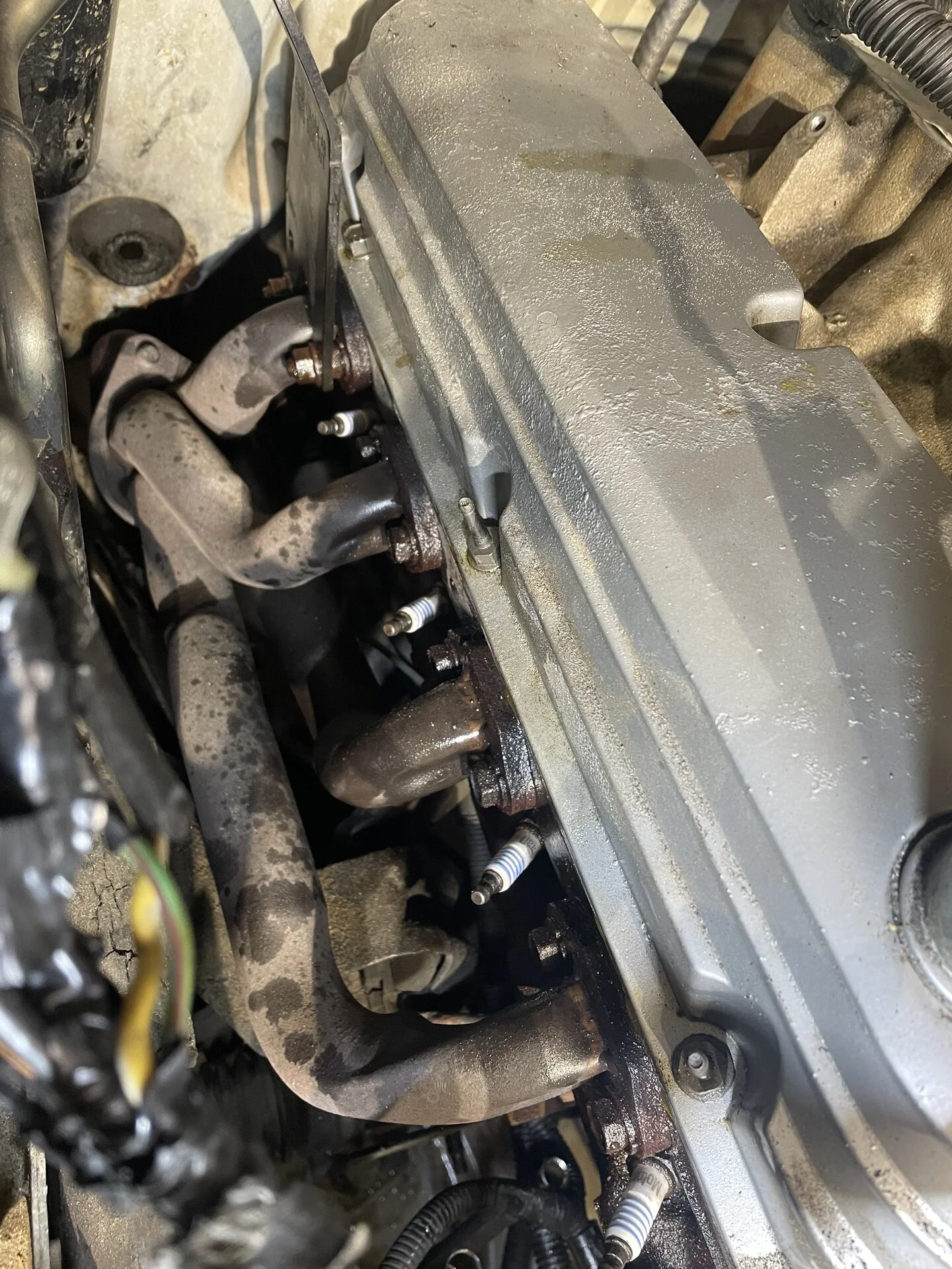

Should I expect the exhaust headers to actually come off? Looks completely rusted.

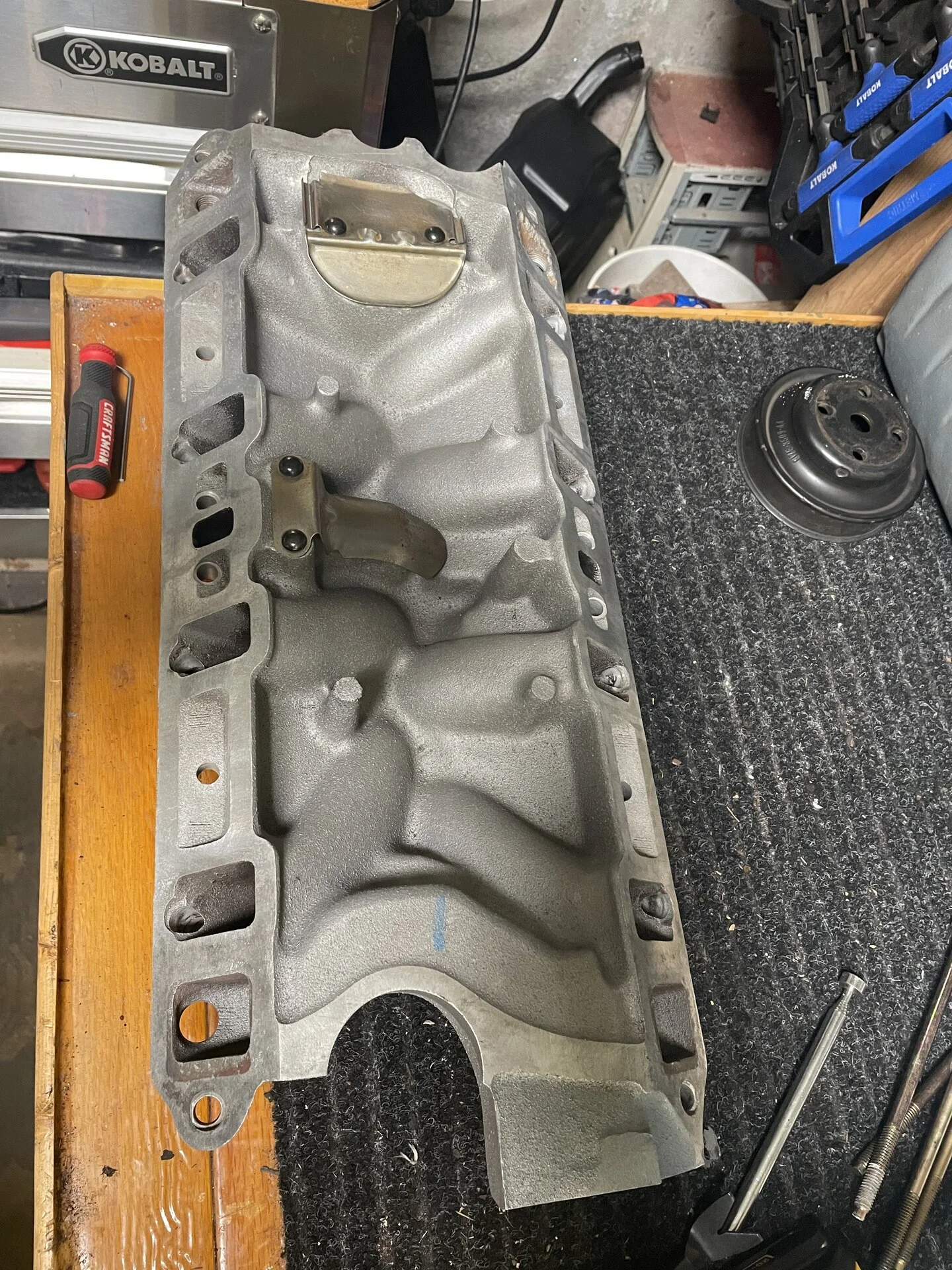

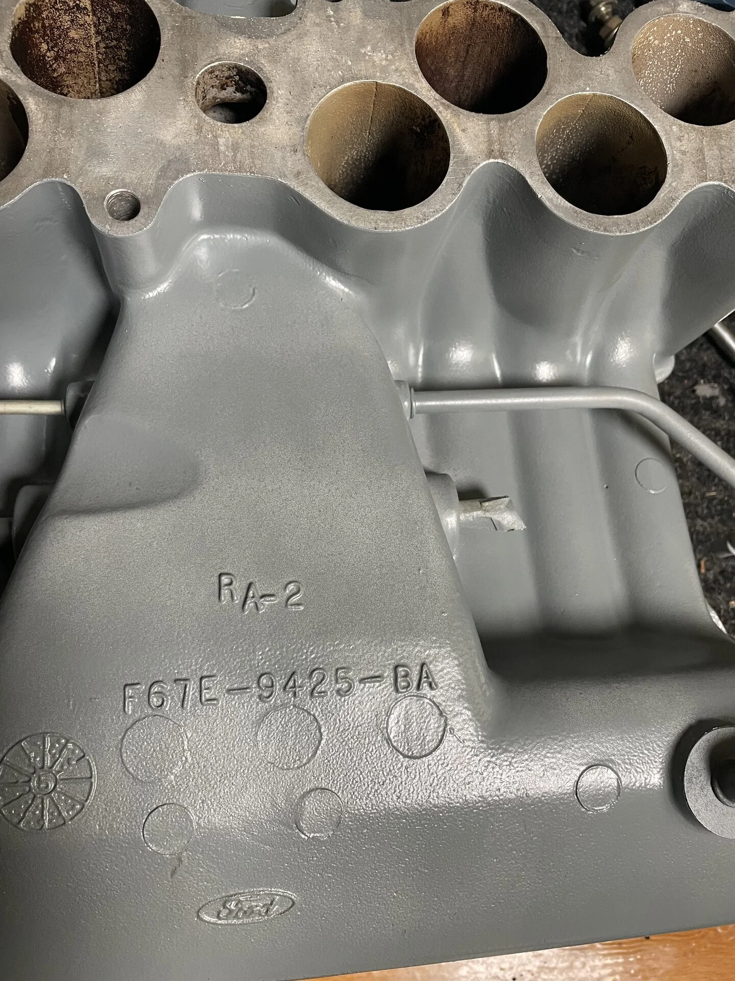

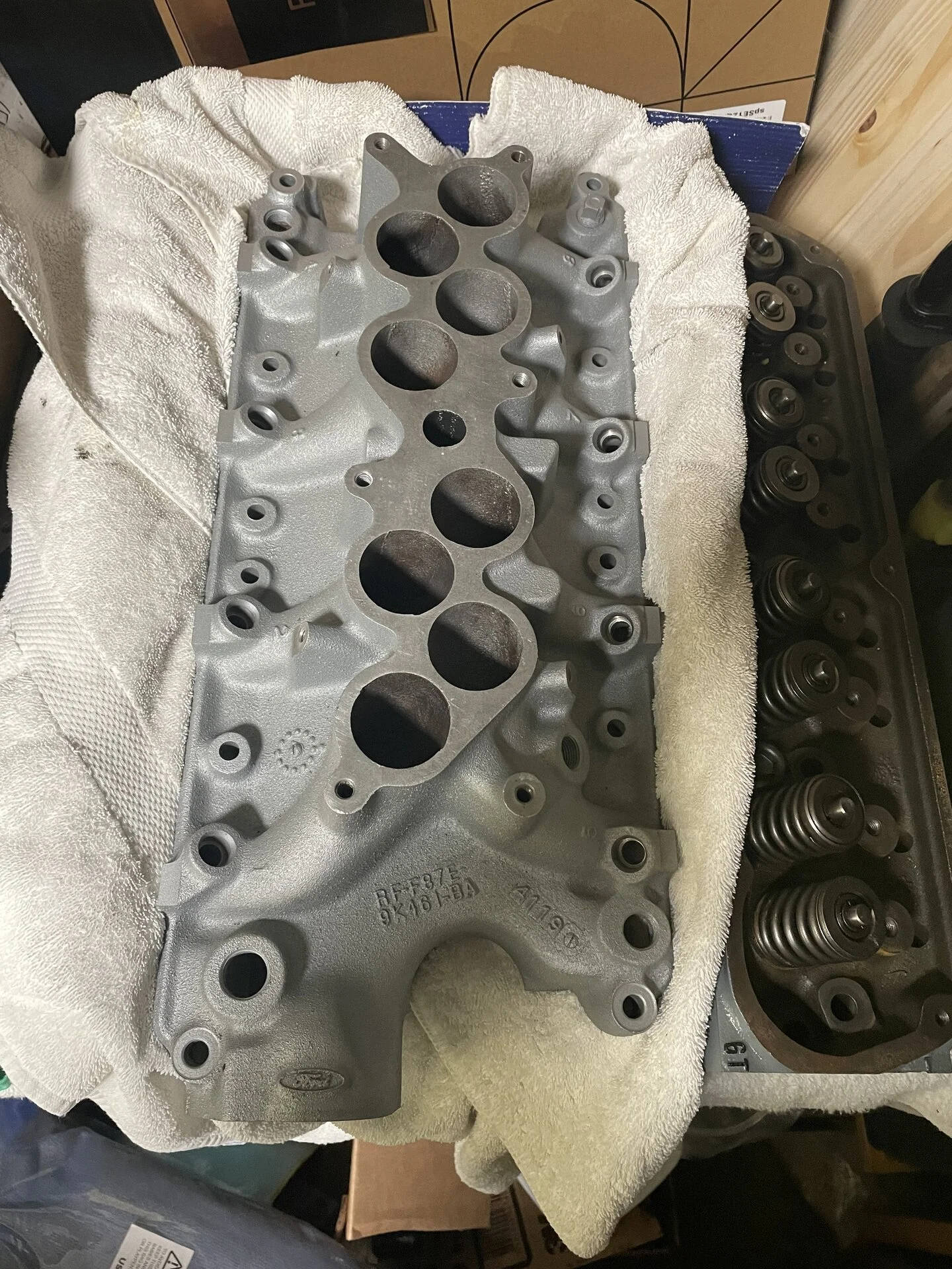

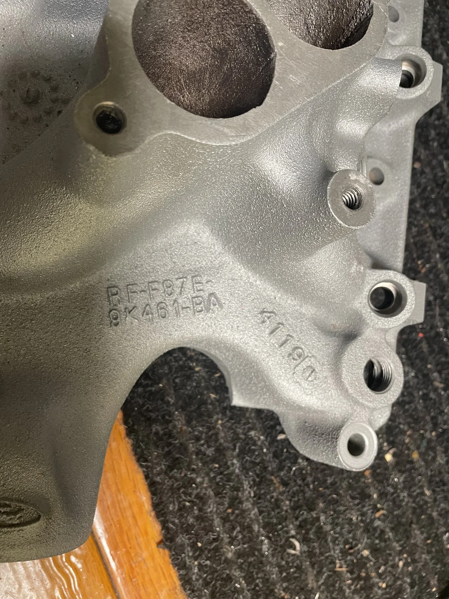

Early EGR style explorer intake. Circa 1996/1997.
