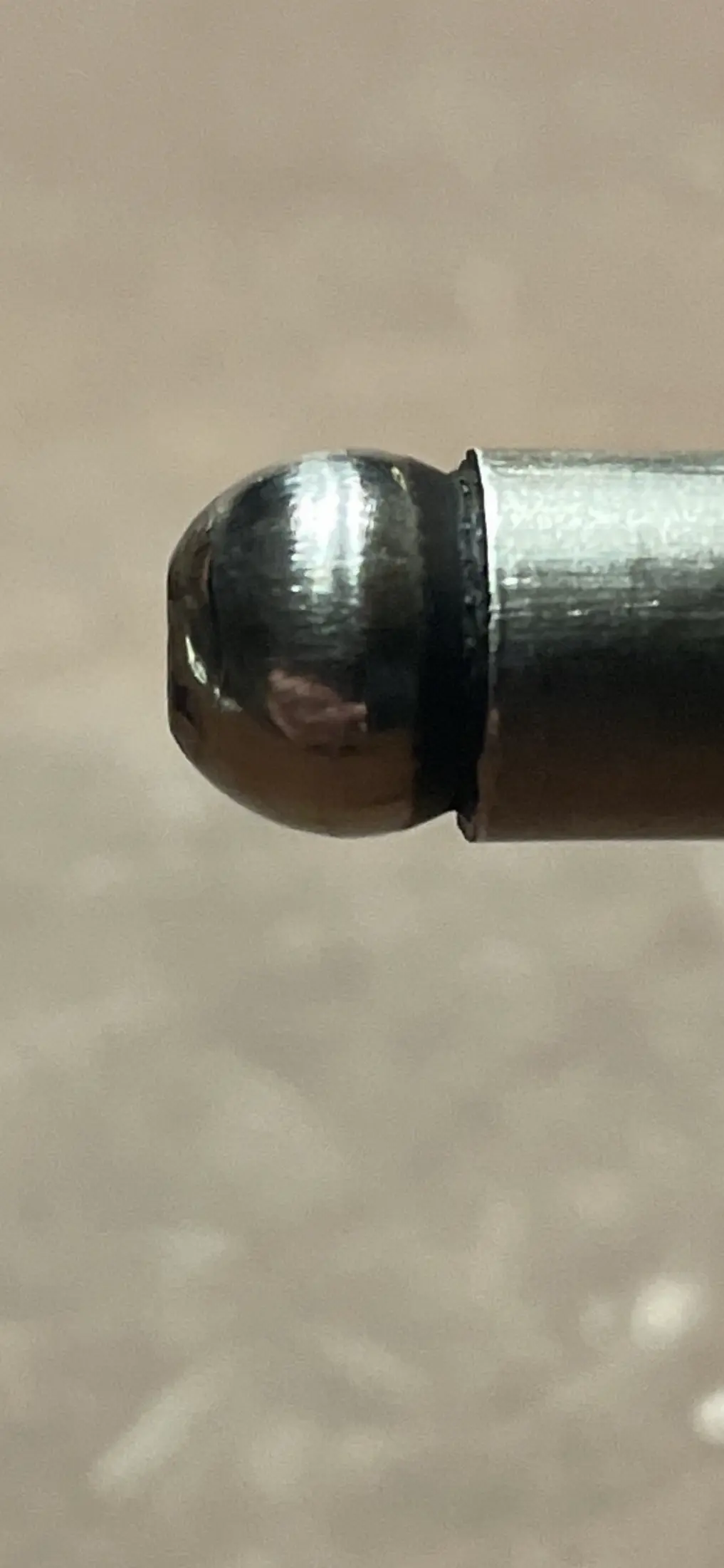

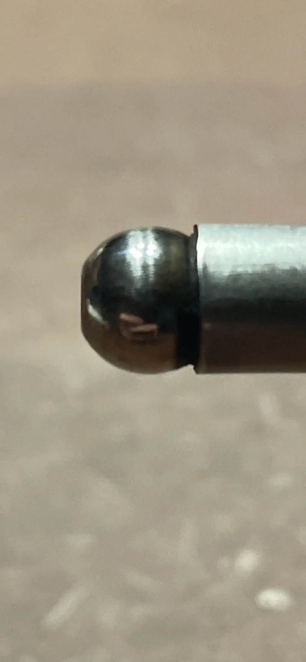

So am I missing something? I don’t see any difference on the ends of these. Here is a zoomed pic of both ends of a single pushrod. Should I be seeing something here?

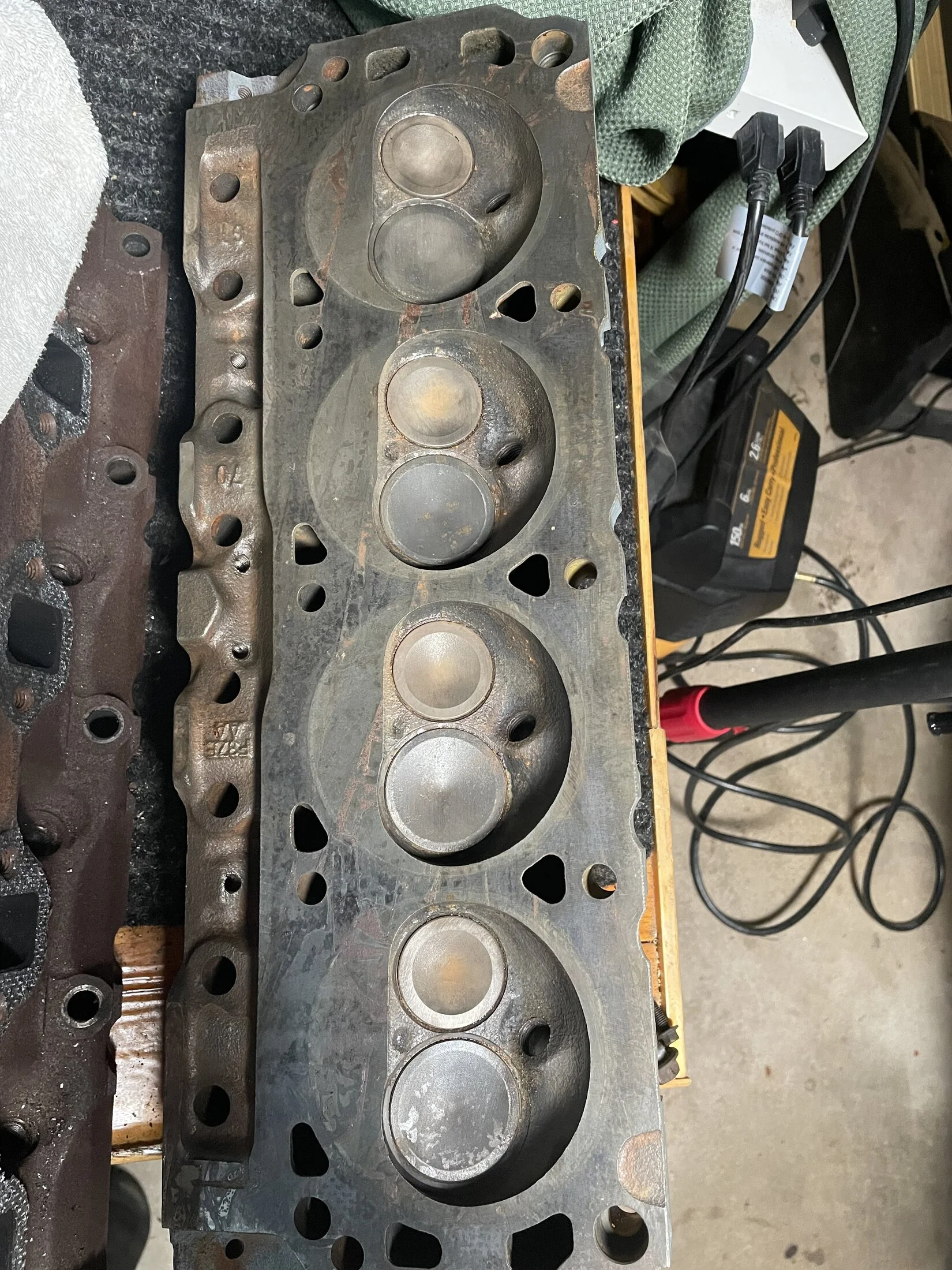

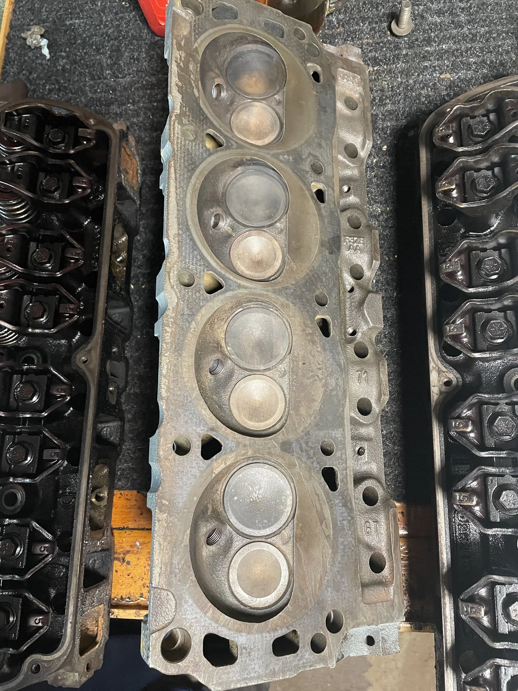

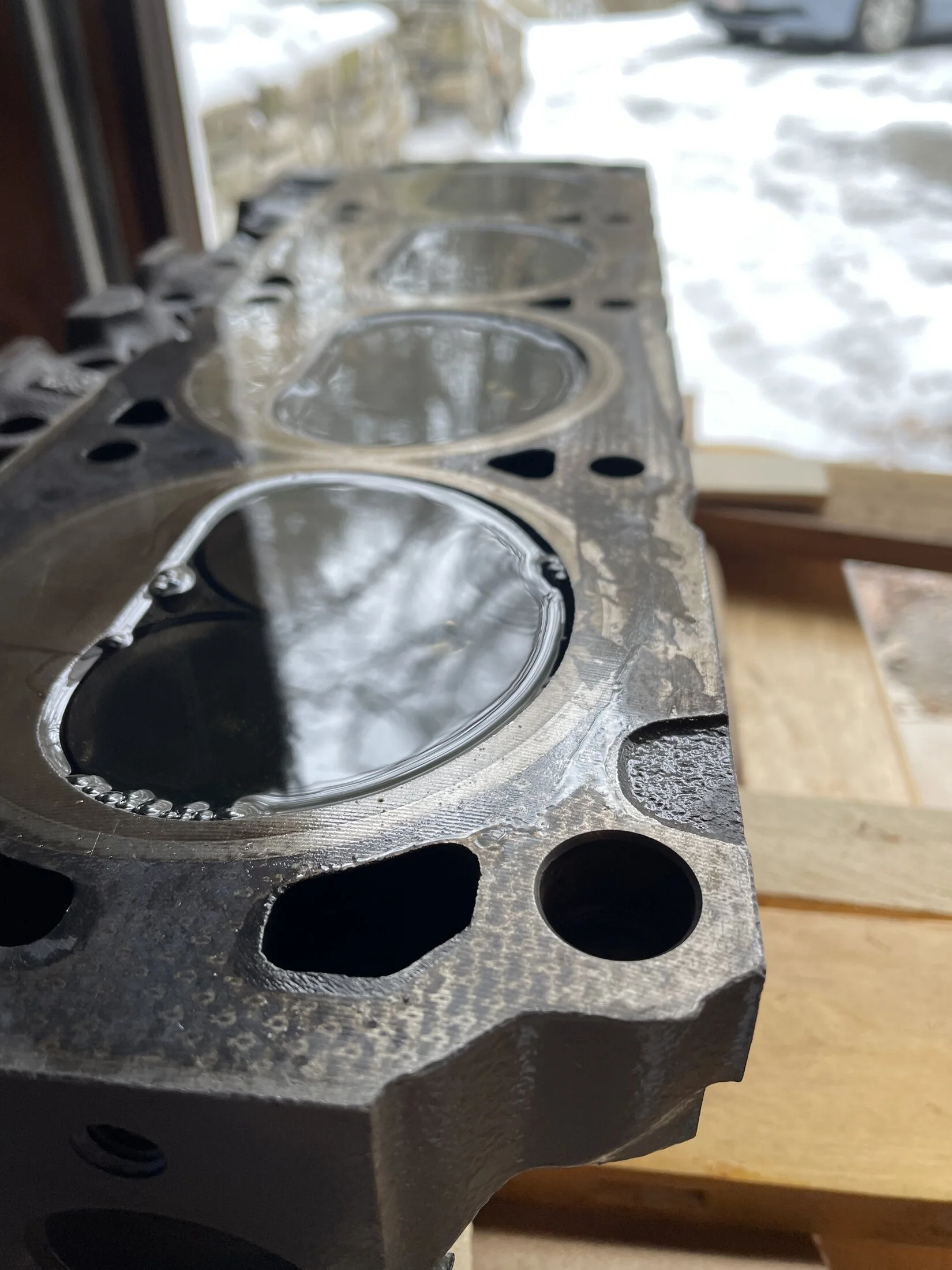

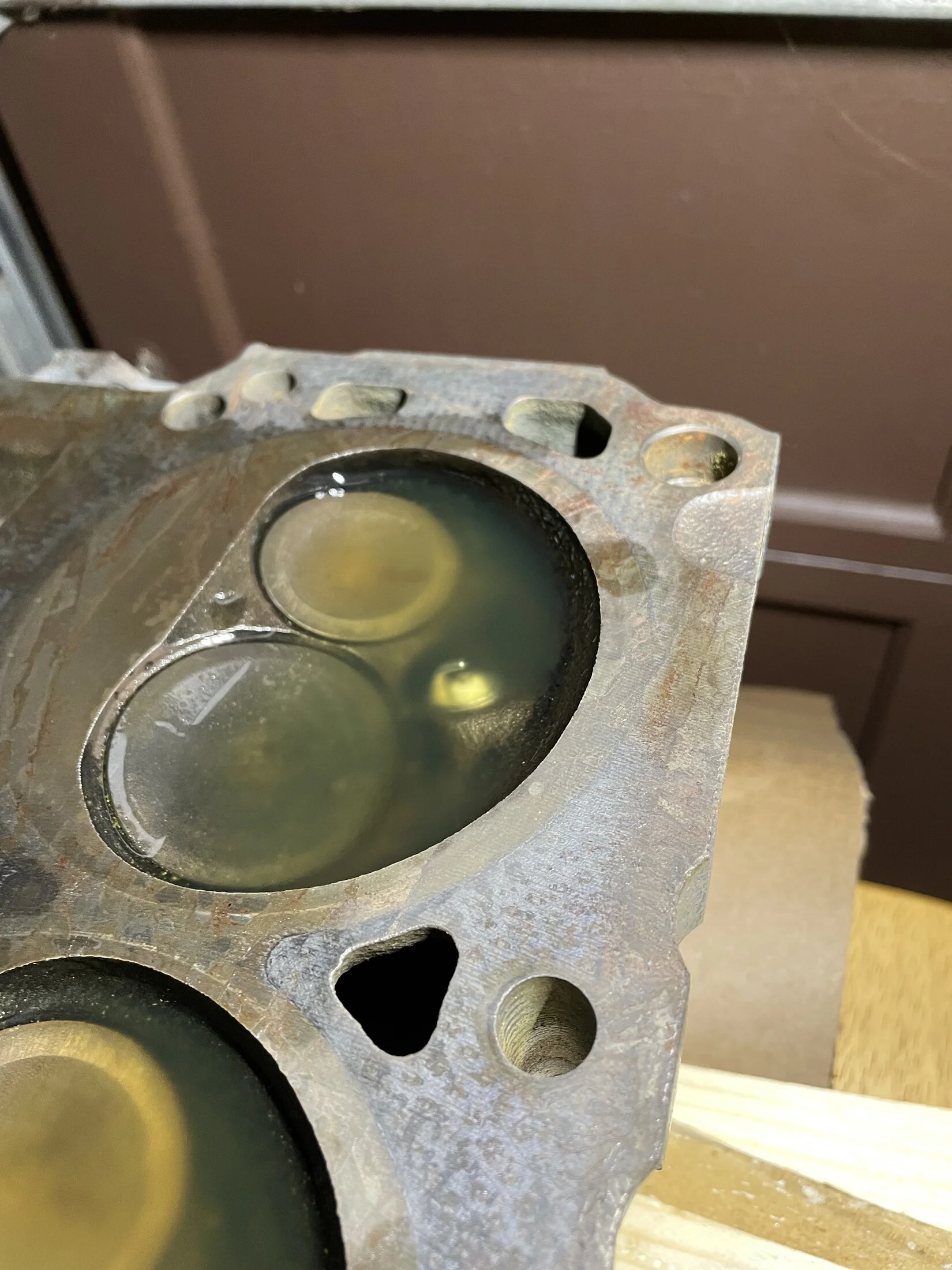

Bottom of both heads. Next gonna reread gasoline test.

So there is no difference in the push rod ends in a small block ford I.e. they can be installed either direction.
Put the spark plugs from your old heads in these so the gas doesn’t go out the hole for the plugs.

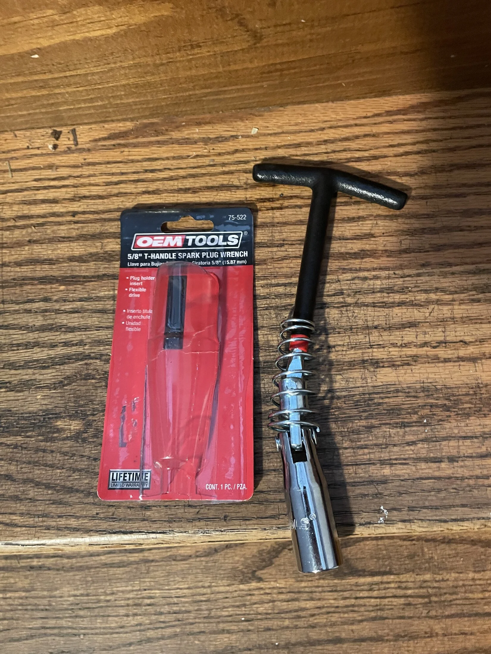

I’m a sucker for new tools. Picked this up at AZ a week or so ago cause I got annoyed at the angles of the heads and plugs in the 302. This will also help with the boat engine as not as much side room to get to them. Gonna use it to put in the old plugs for this hydro test.

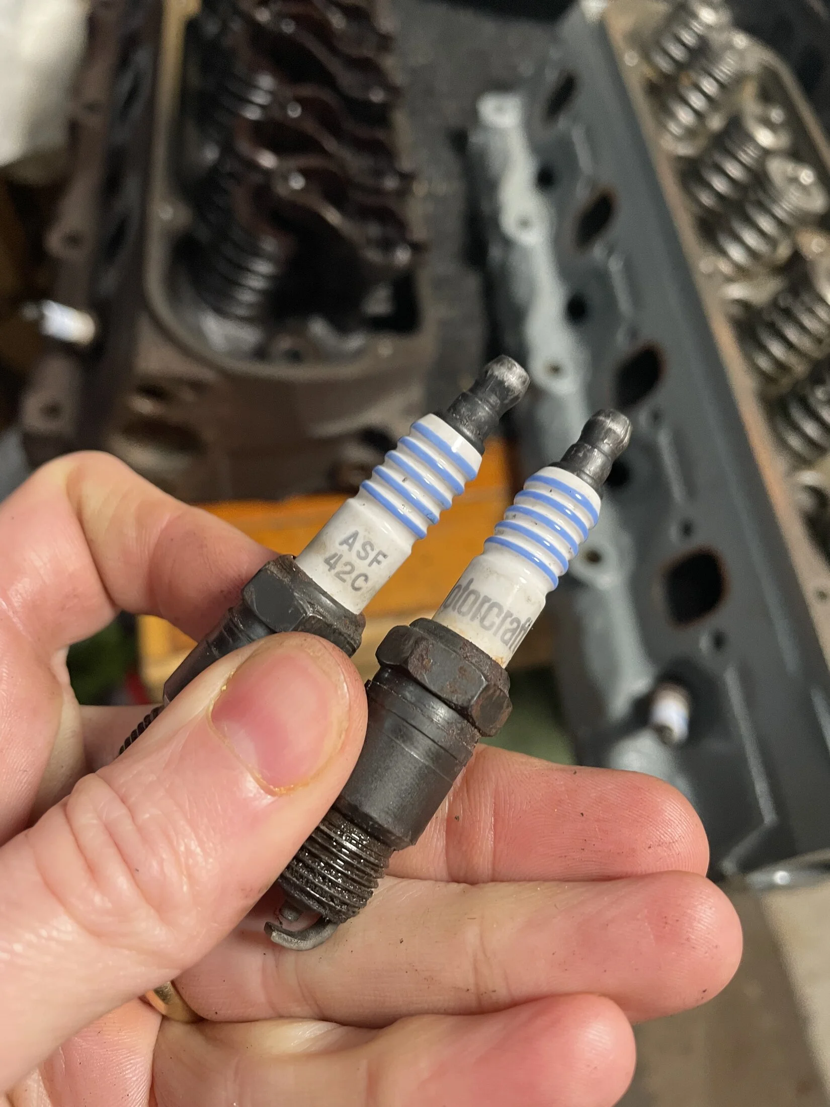

Anyone have any idea why the Motorcraft ASF 42C plugs which fit in the stock heads don't fit into the GT40 heads? It seems that the shaft is too wide and the plug wont start threading. Am I missing something? What am I doing wrong?

JAA said:
LOL!!
Because they're different plugs. Go get some for a 93 Cobra.

I believe the recommended plug by Ford for a GT40 Y or X head on a stock motor is a AGSF-32C.

I went with the Autolite 104 Copper.

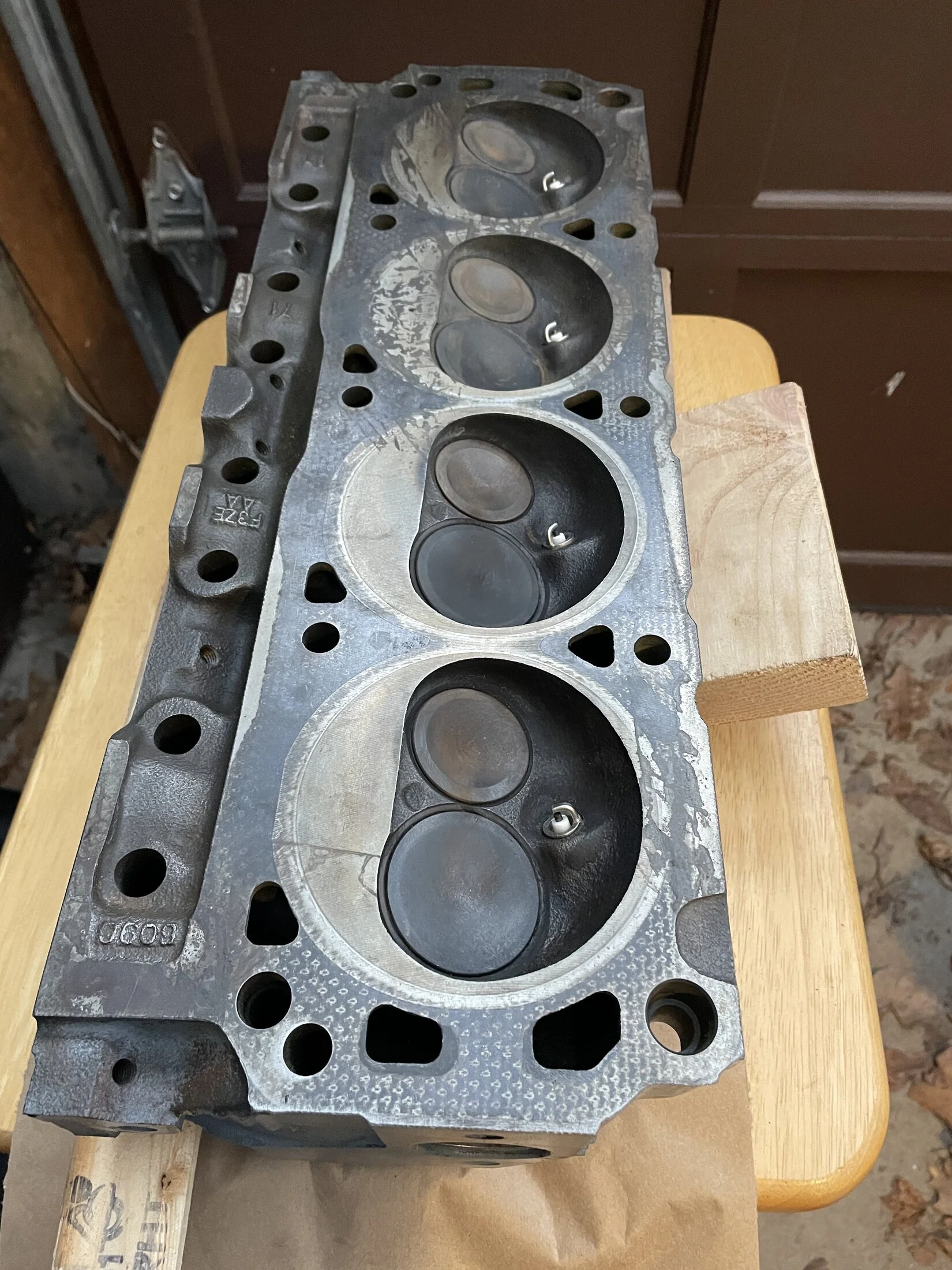

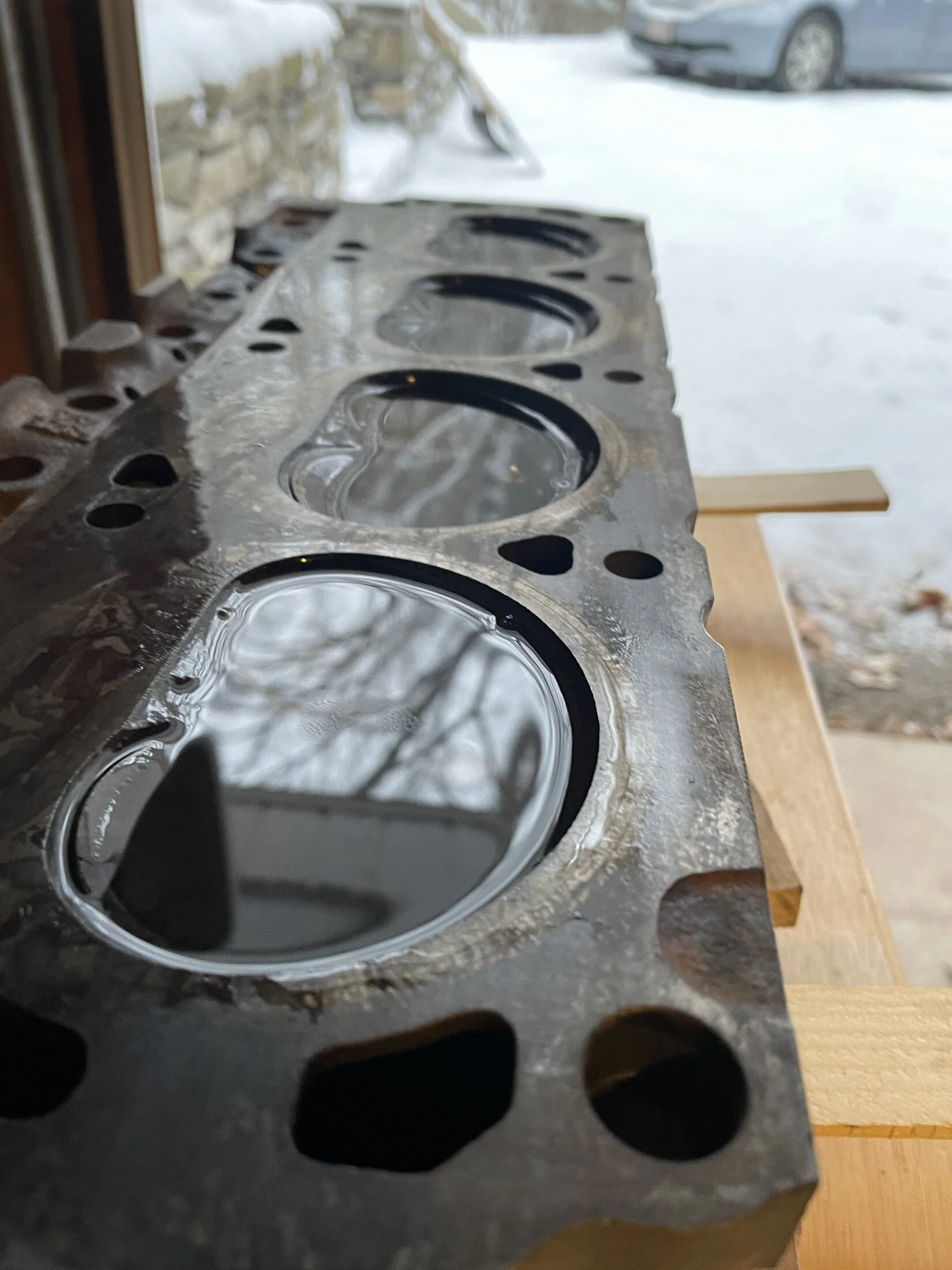

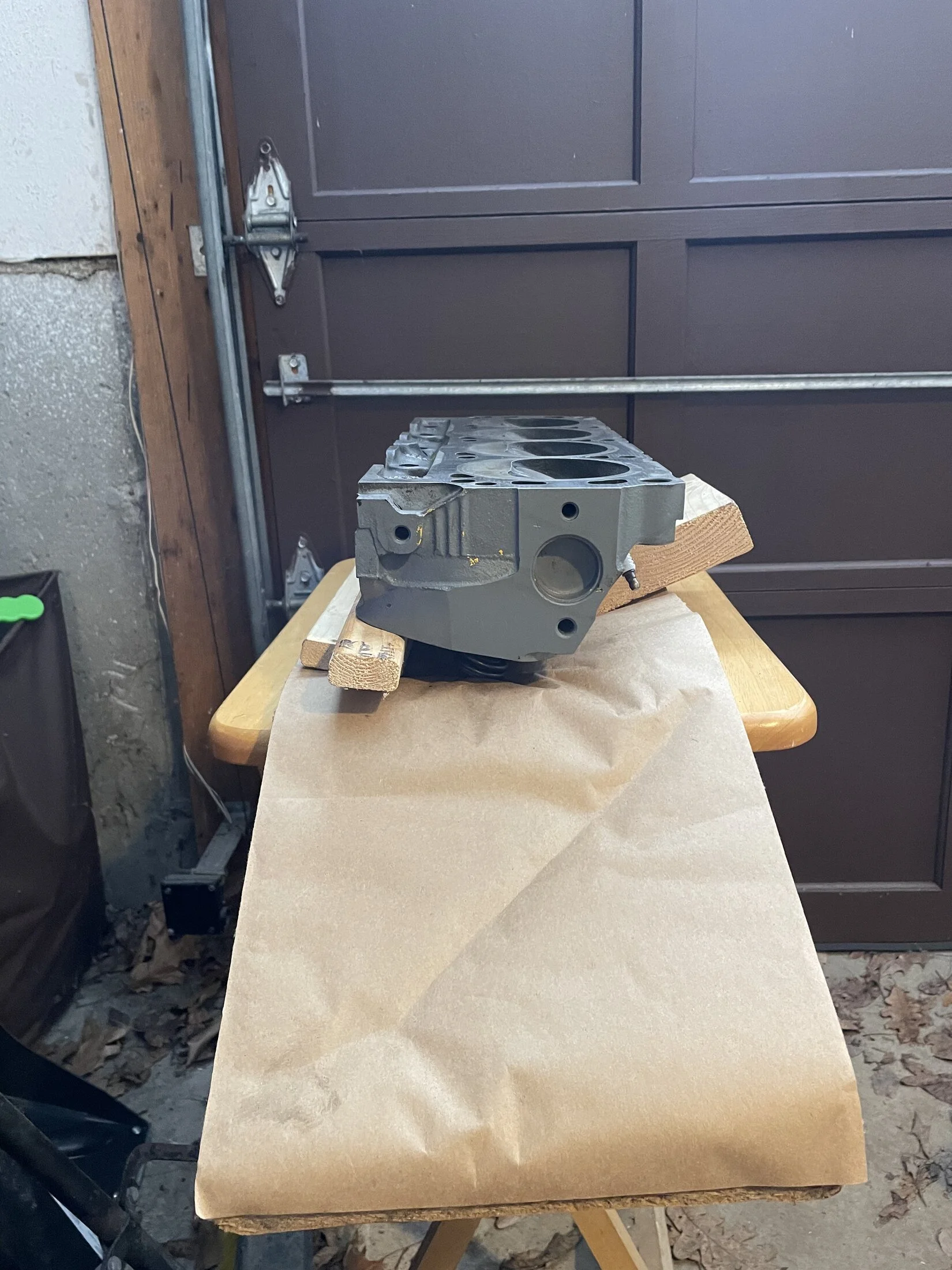

Here is my little DIY setup

Not as level as I thought

Ok, I think I got it level
PS - took like 3 minutes for my wife to say “I smell gas”. I figured I could have kept that garage door shut for at least 25min

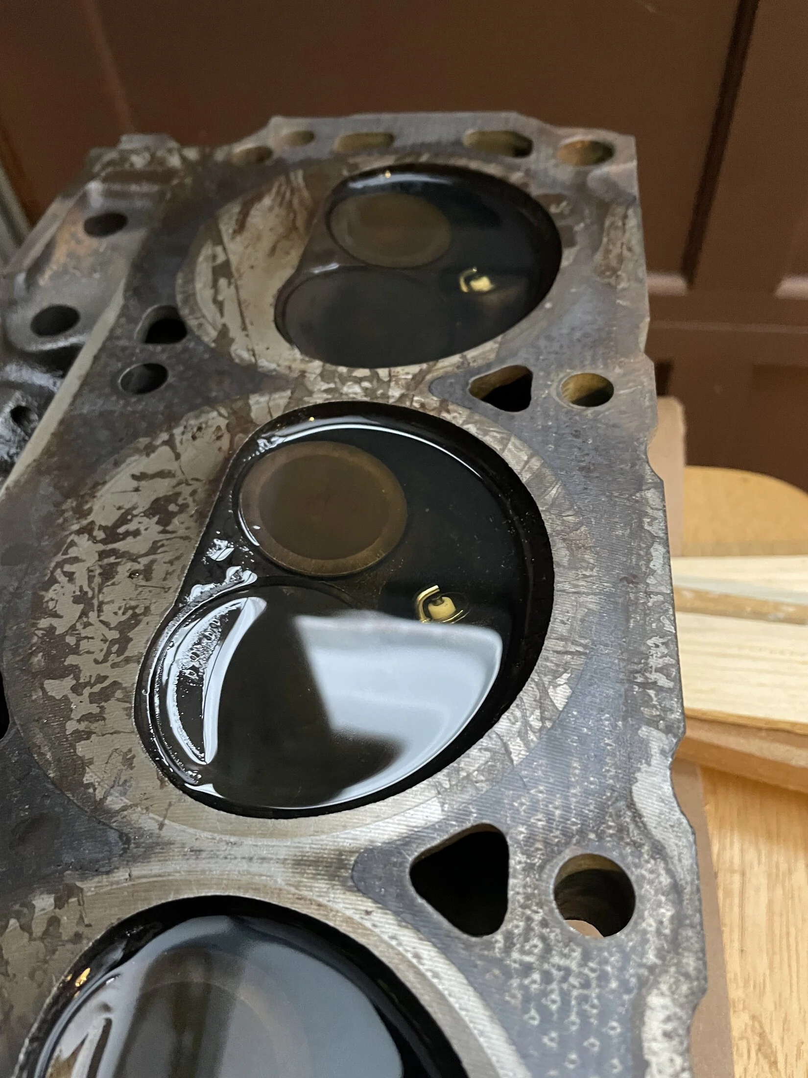

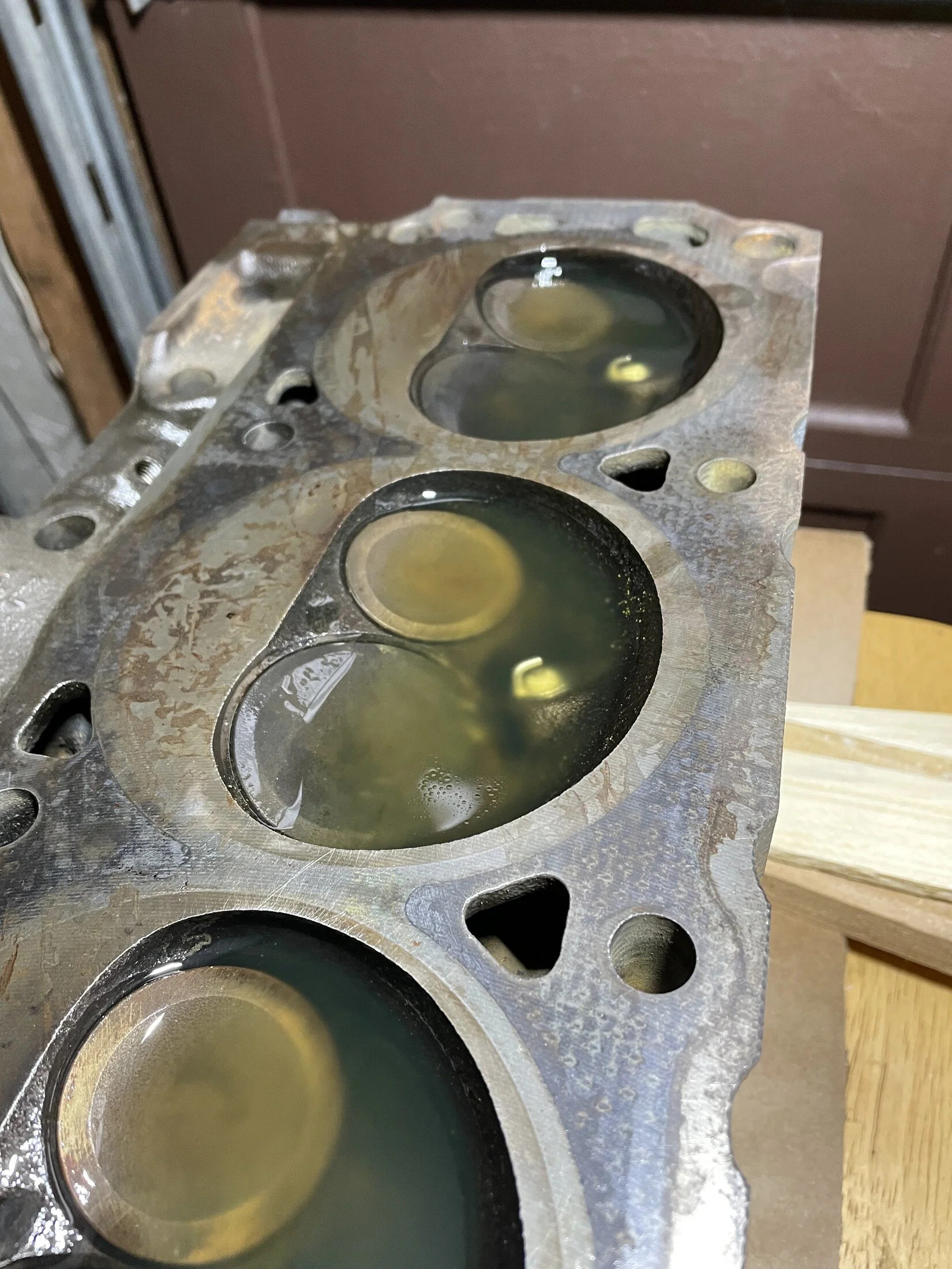

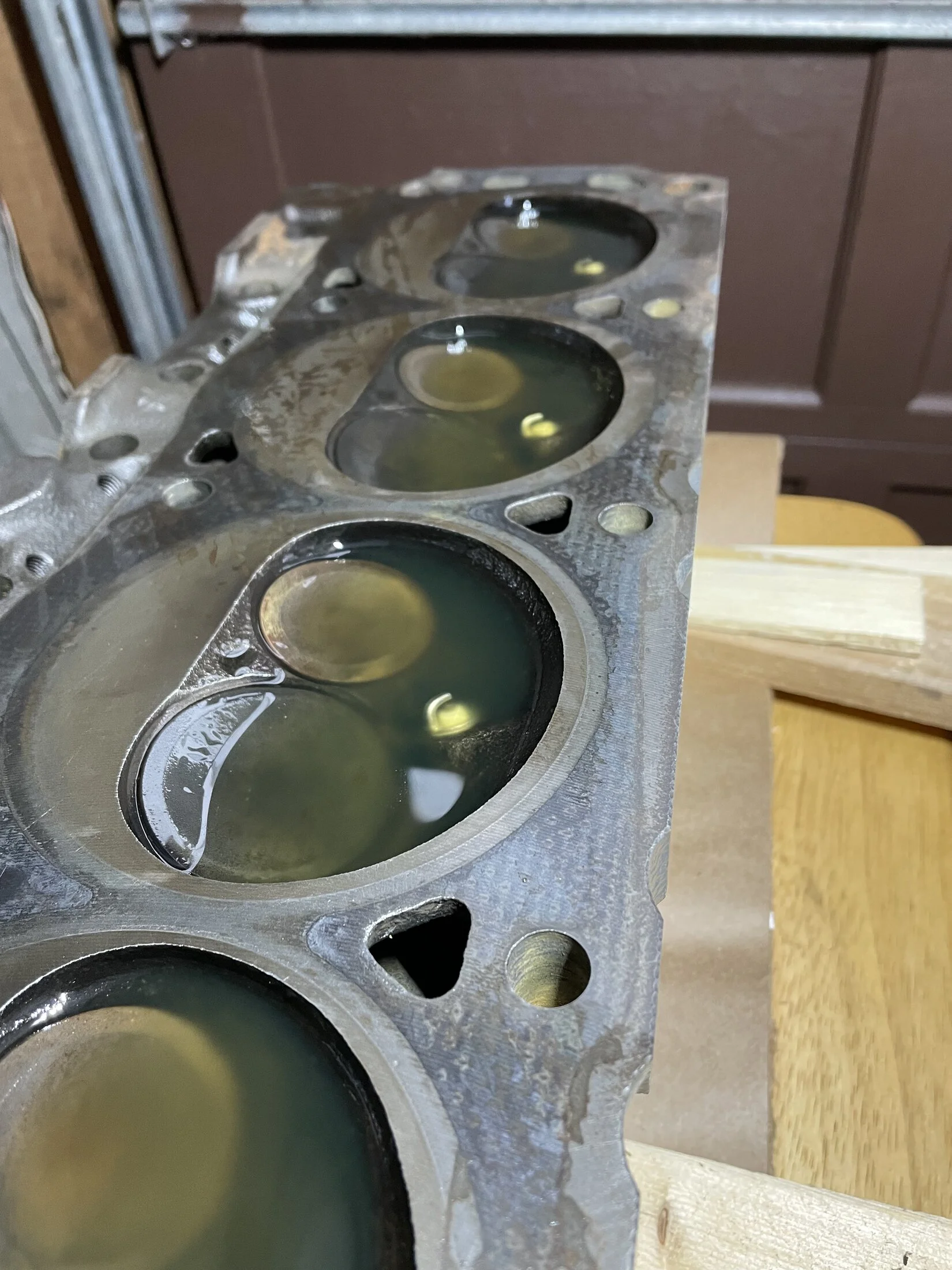

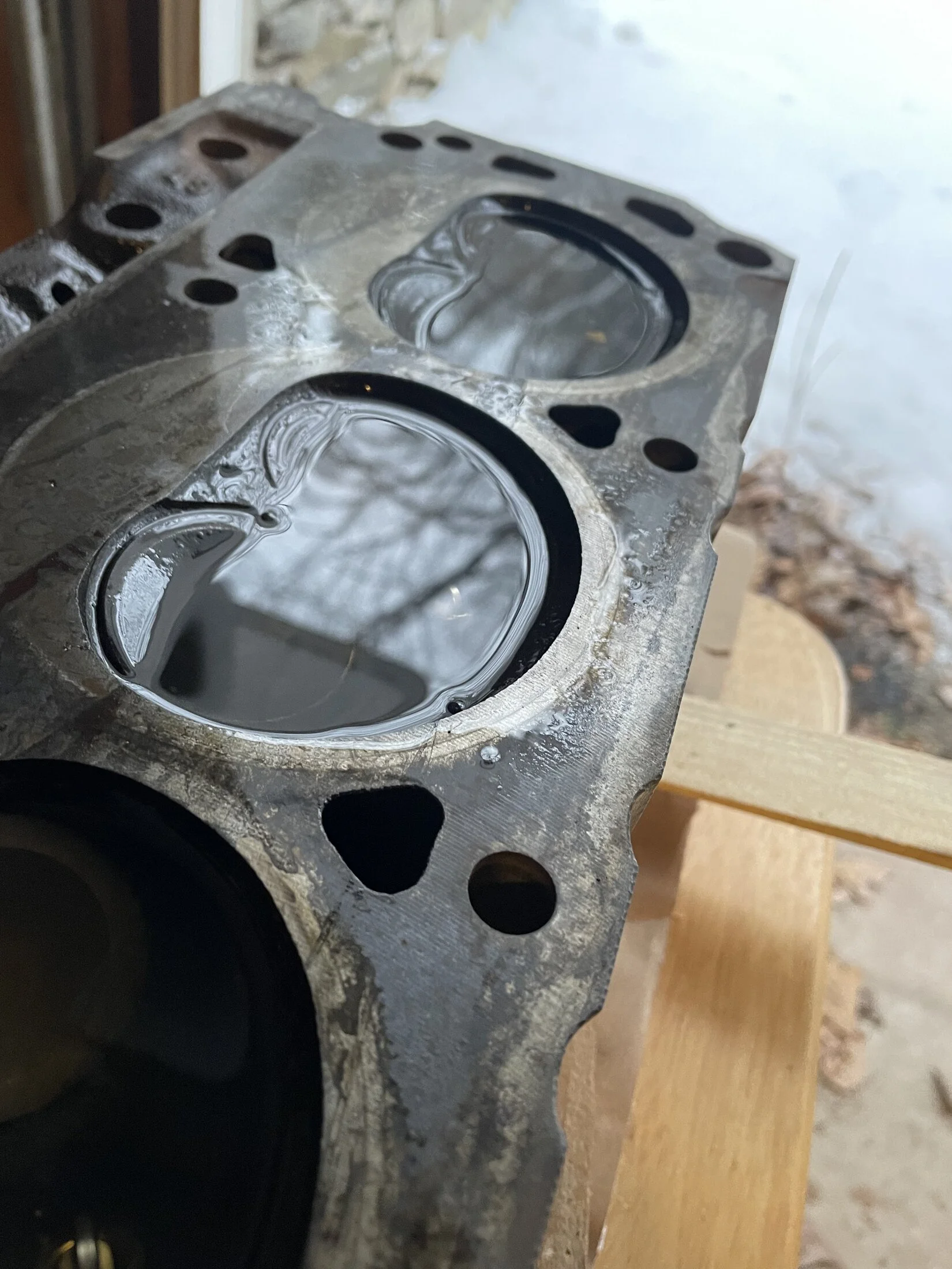

45 min in. Looking leaky

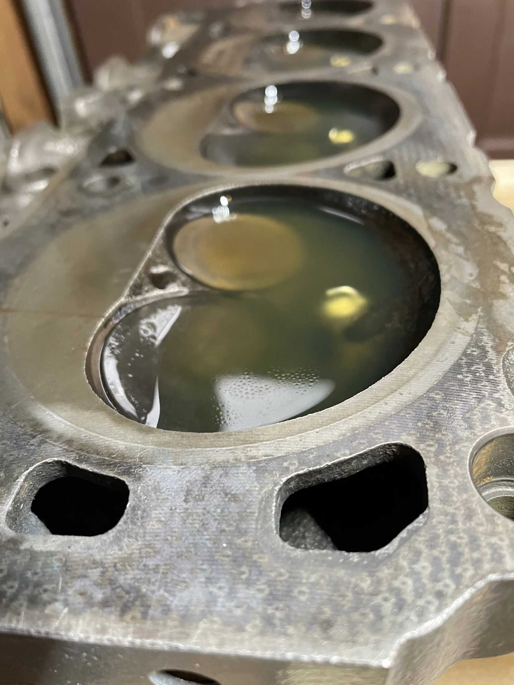

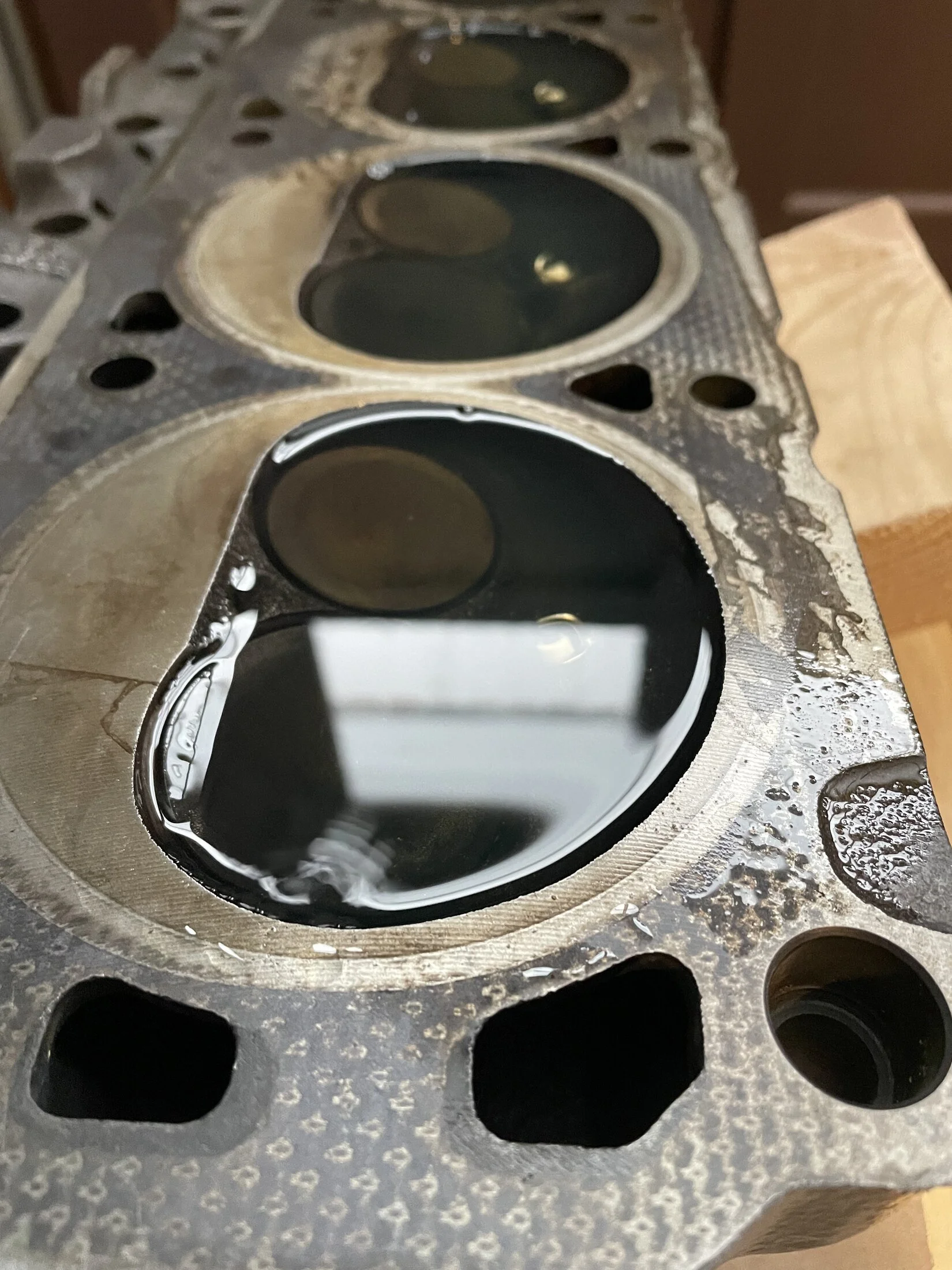

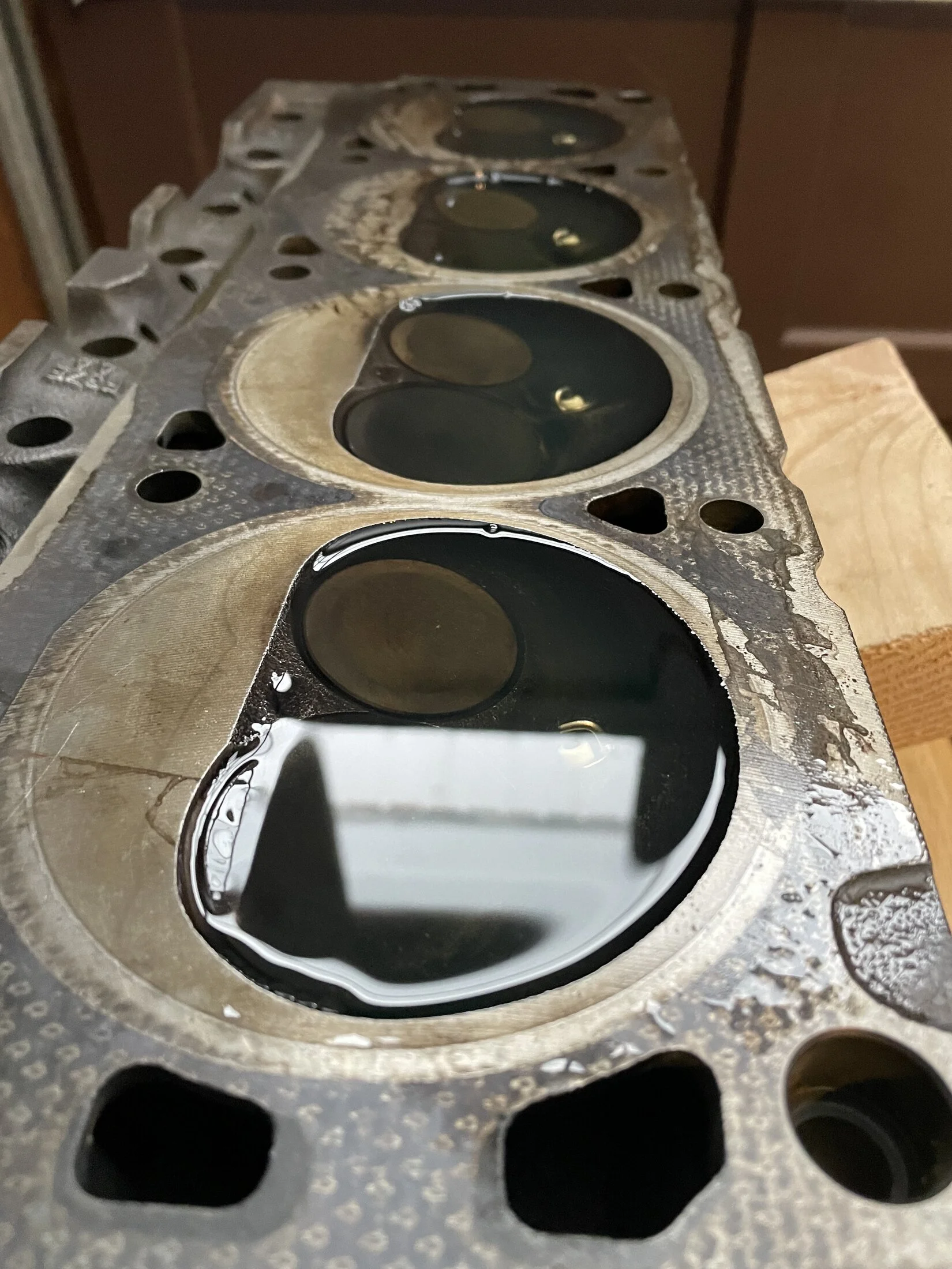

After 1 hour. This means all cylinders are leaking, yes? Also means complete valve job required?

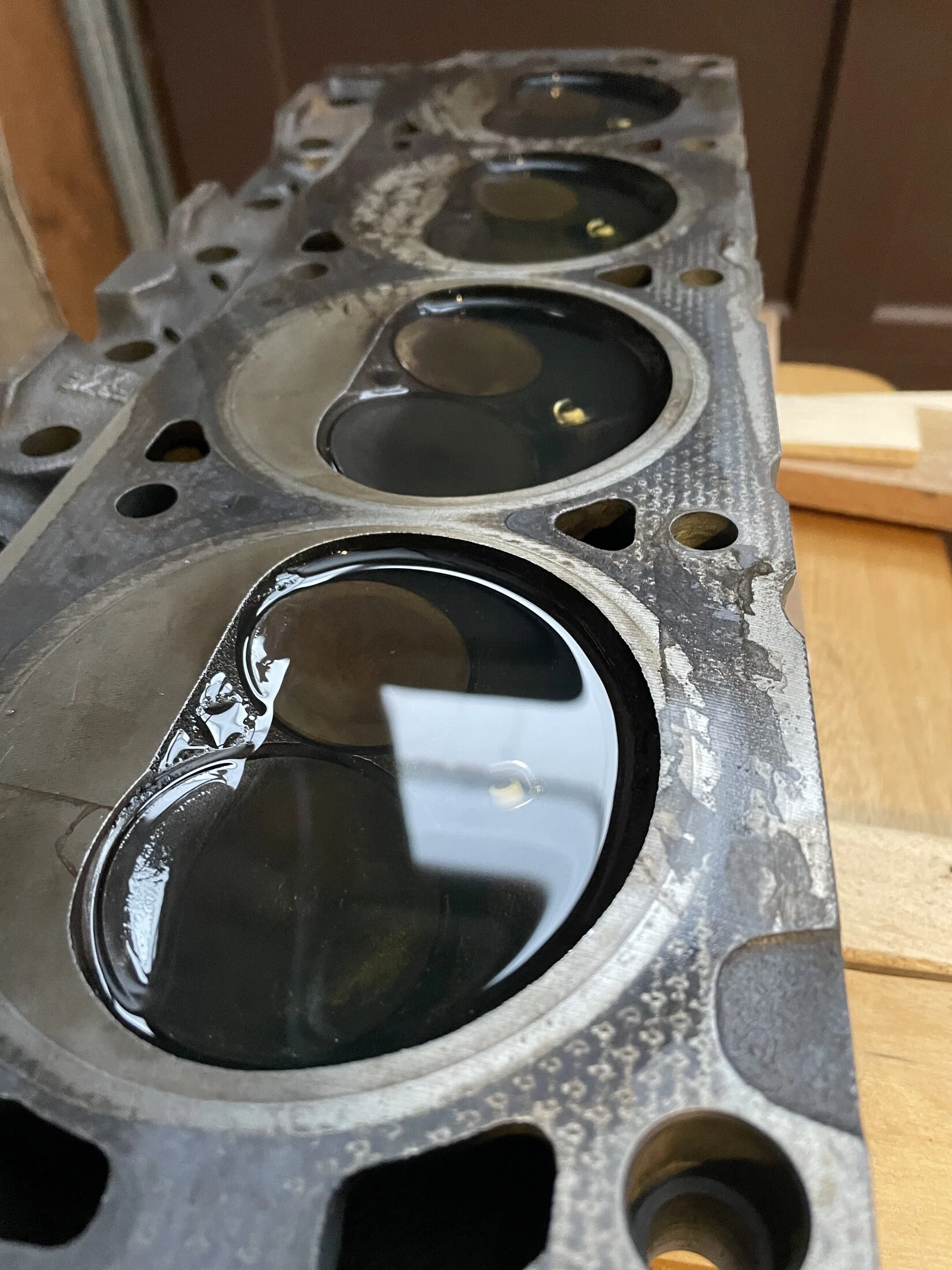

12 min to go on 2nd head. Where is the gas going?
