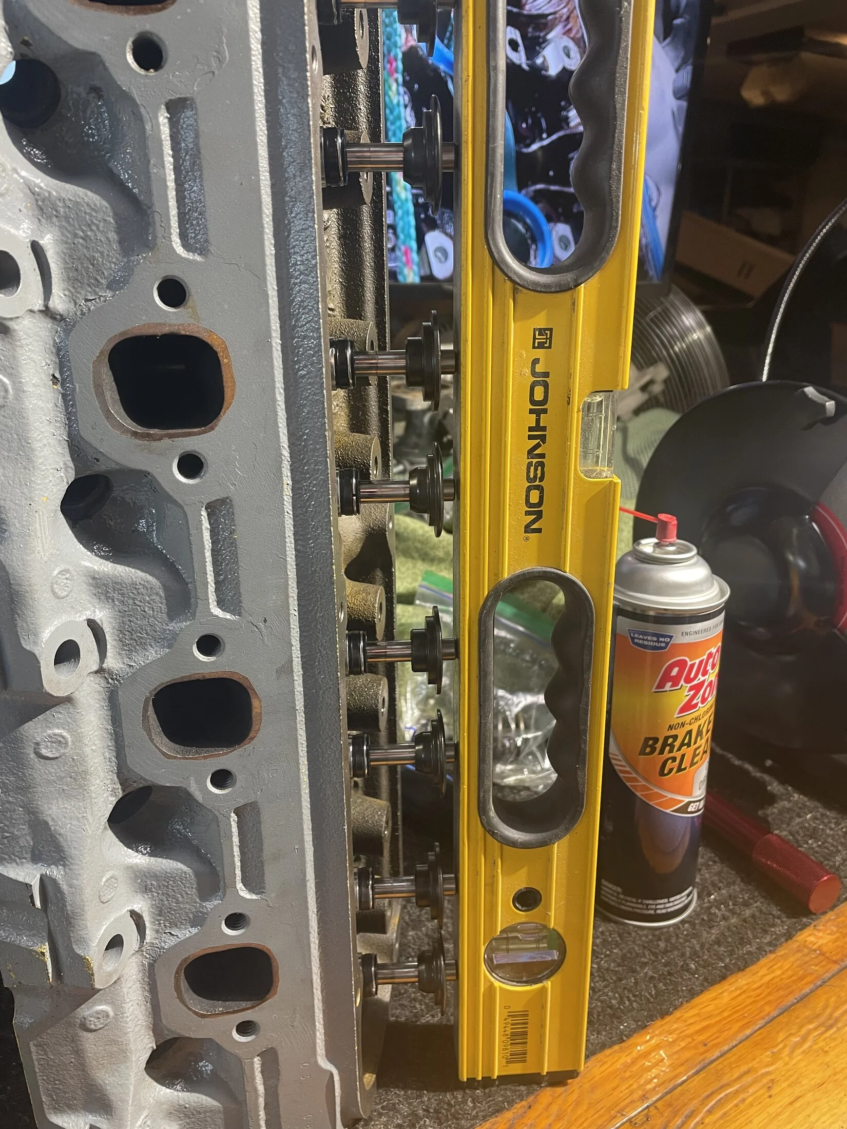

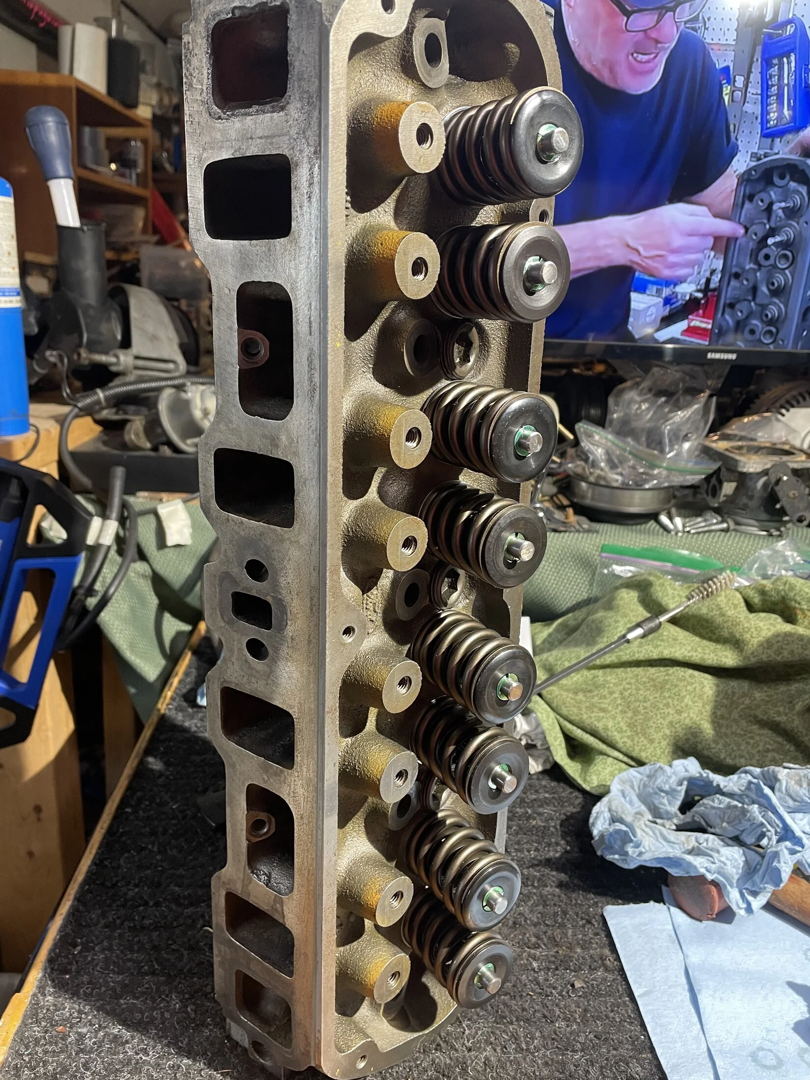

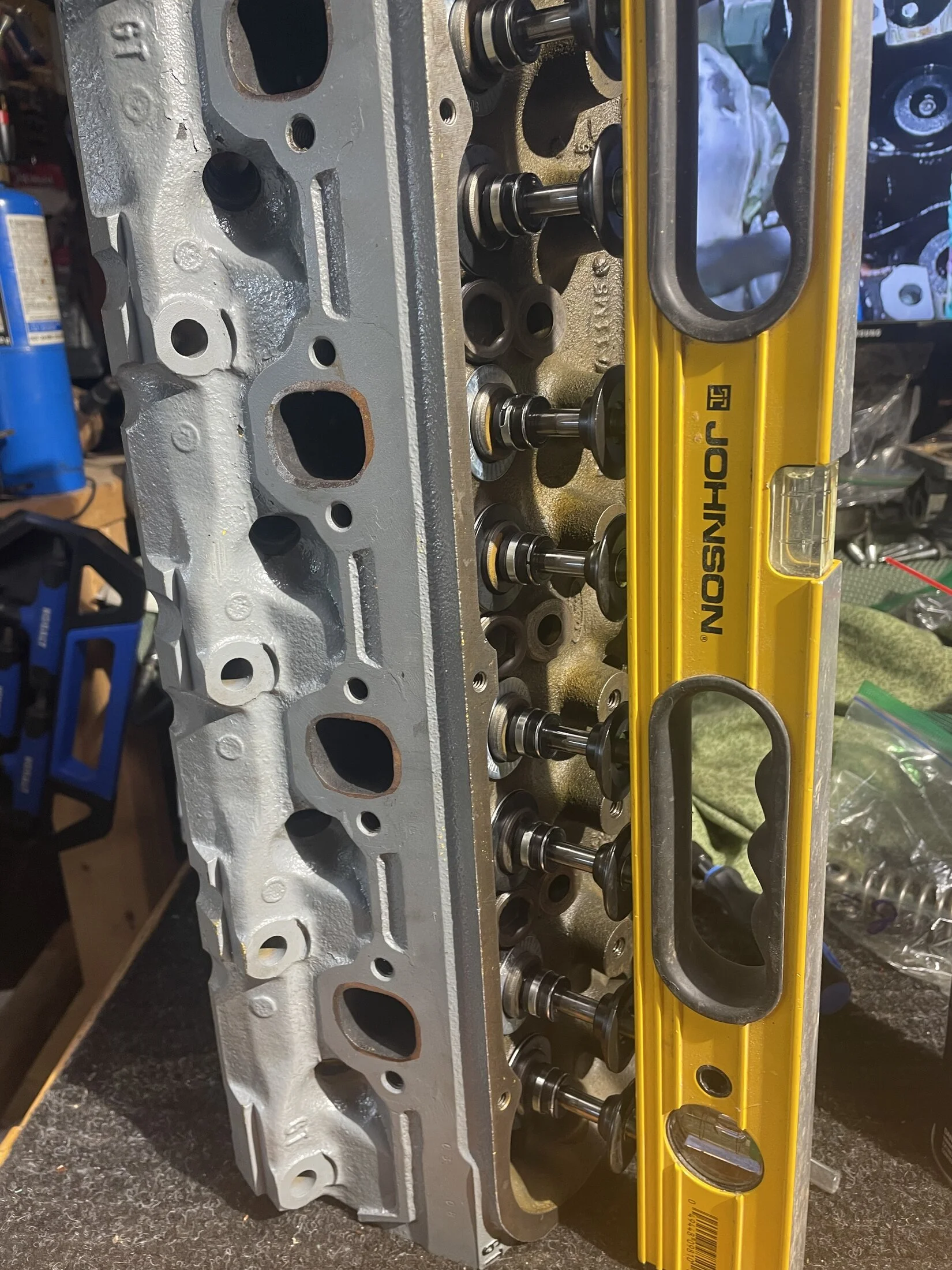

All shims set (for now). Single silver per exhaust. Intake single silver and 2 blacks. All within 1.800” spec

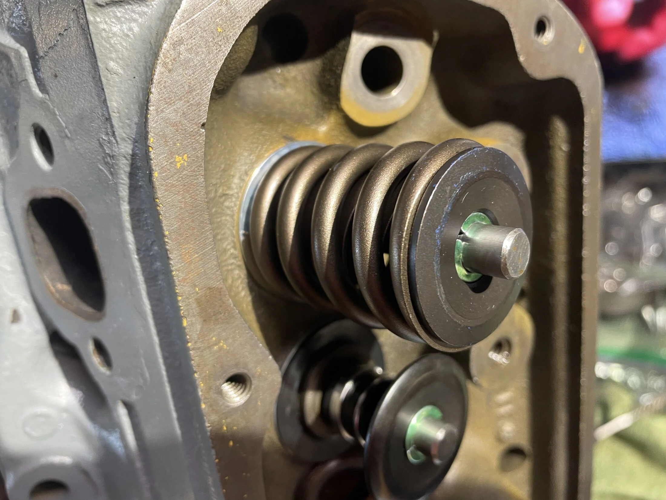

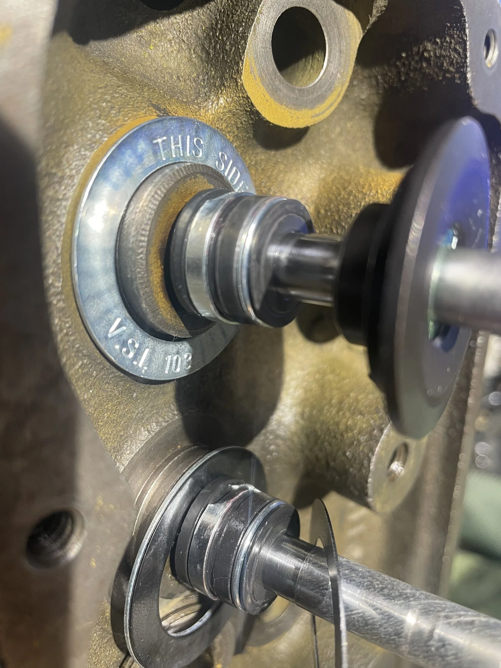

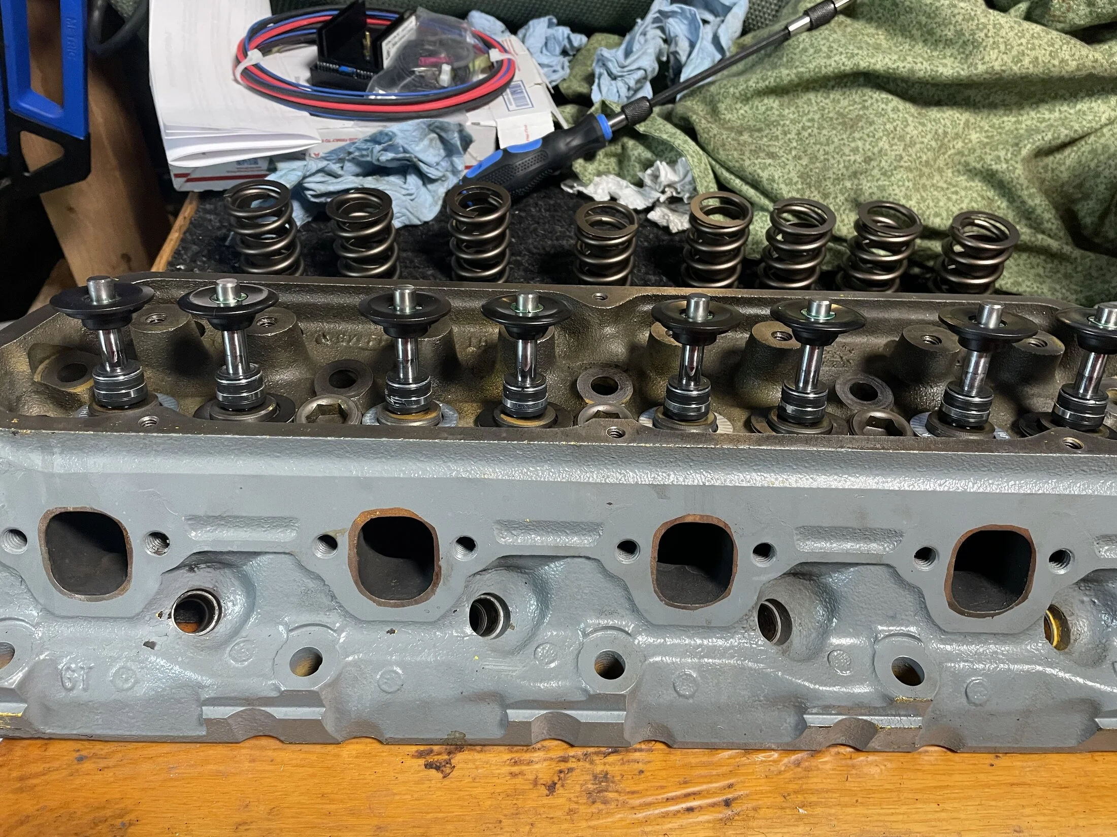

Are the valve seals supposed to fit flush with the valve guide? Mine certainly arent

guides in

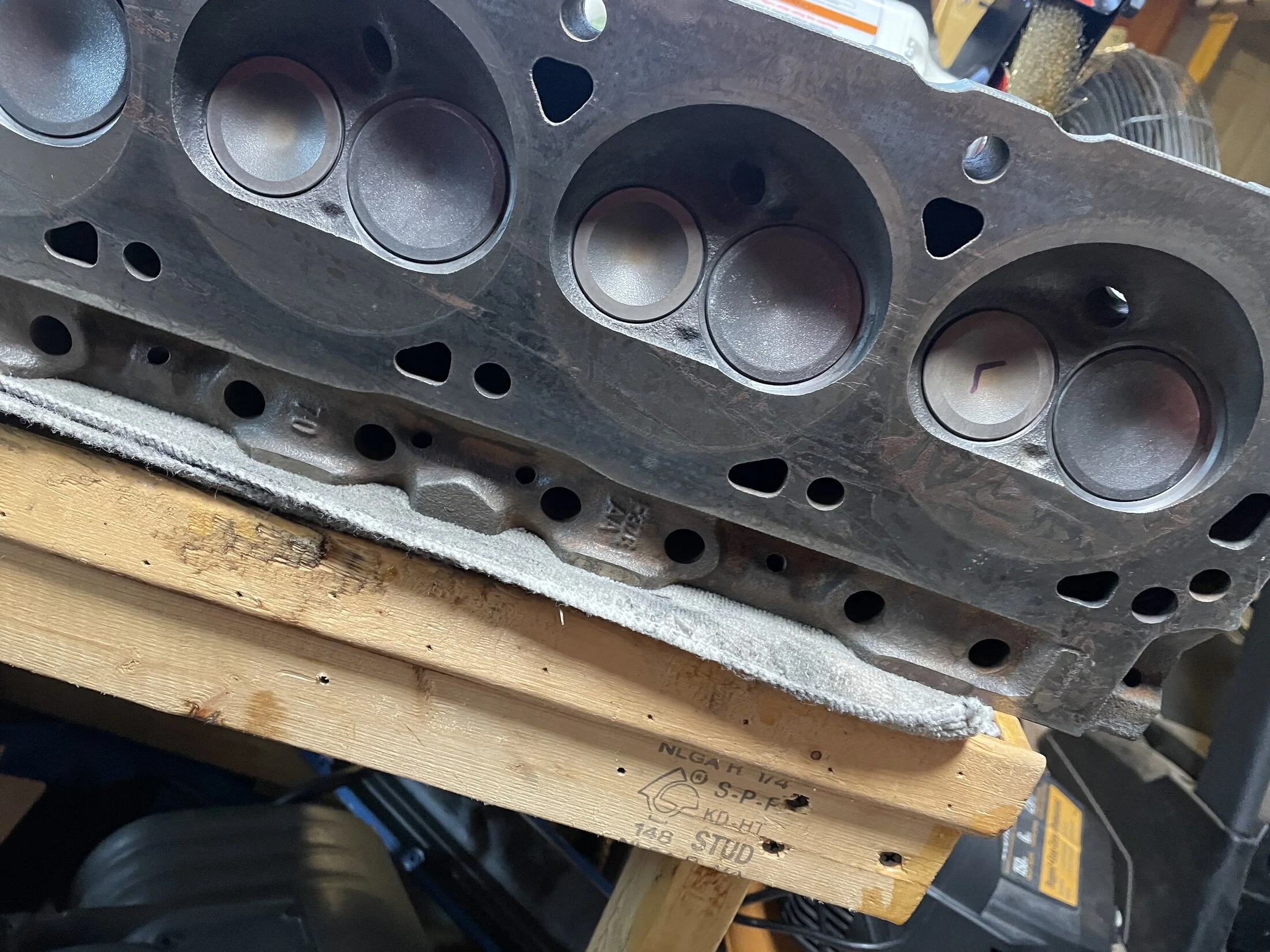

Do I do a hydro test? Do I want to ask questions I may not want answers to?

Depends on how good you think your valve job is. My guess is they will be good to go but measure twice cut once comes to mind here.

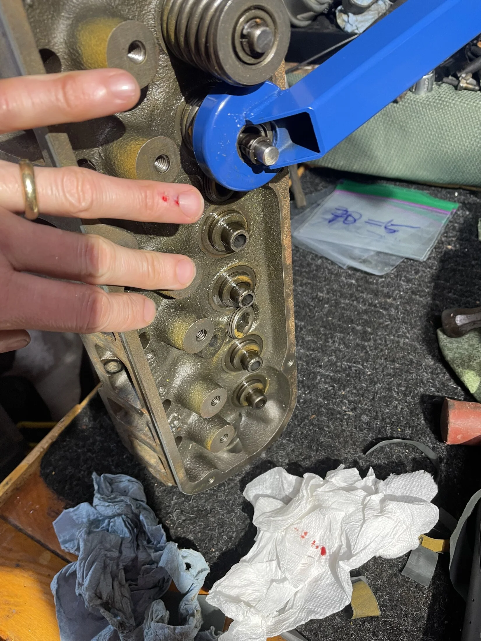

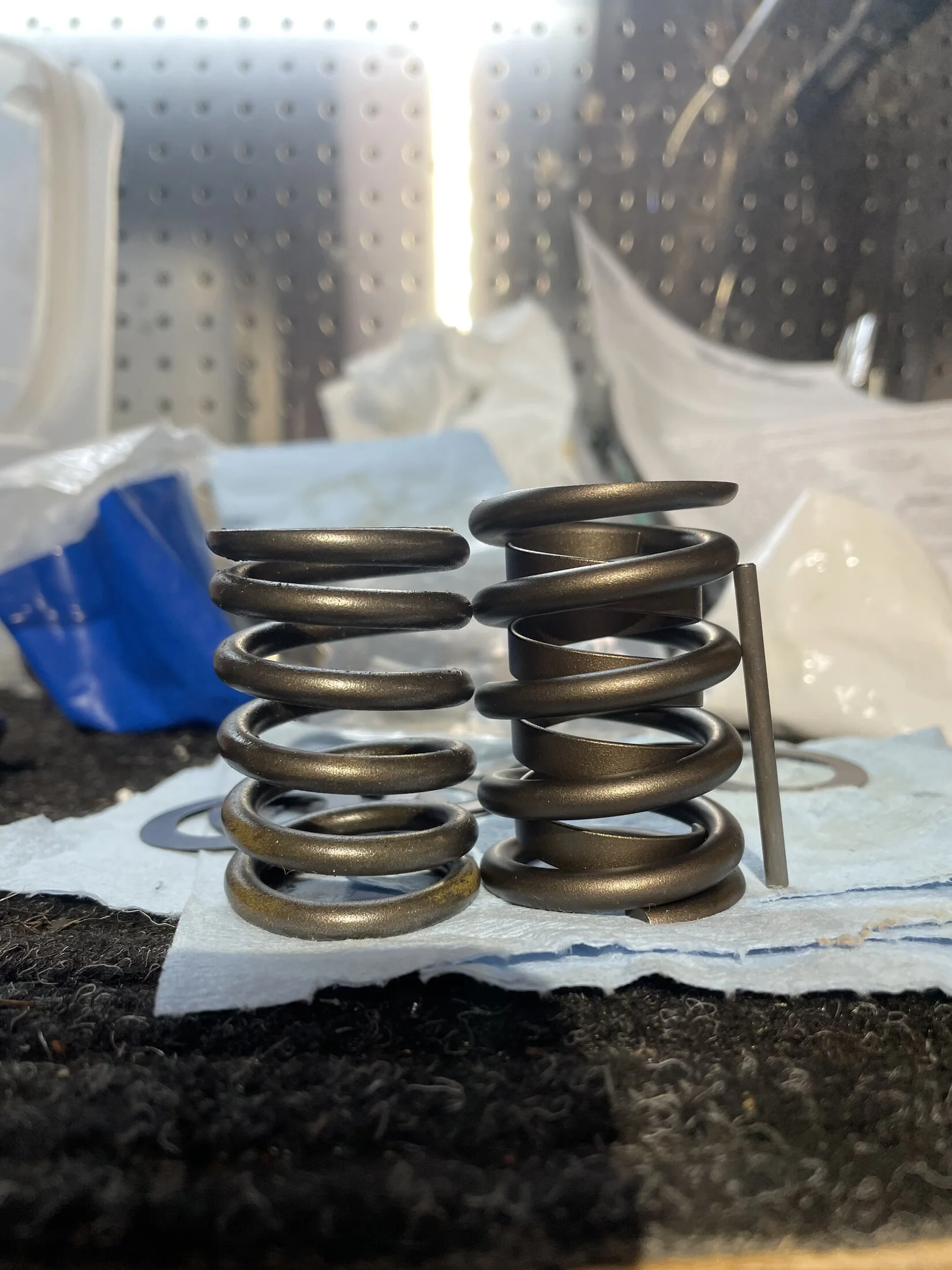

Of all the ways to hurt myself. On a stuck spring, once it gave I jammed myself on the handle side of the compressor. Who would have thunk it

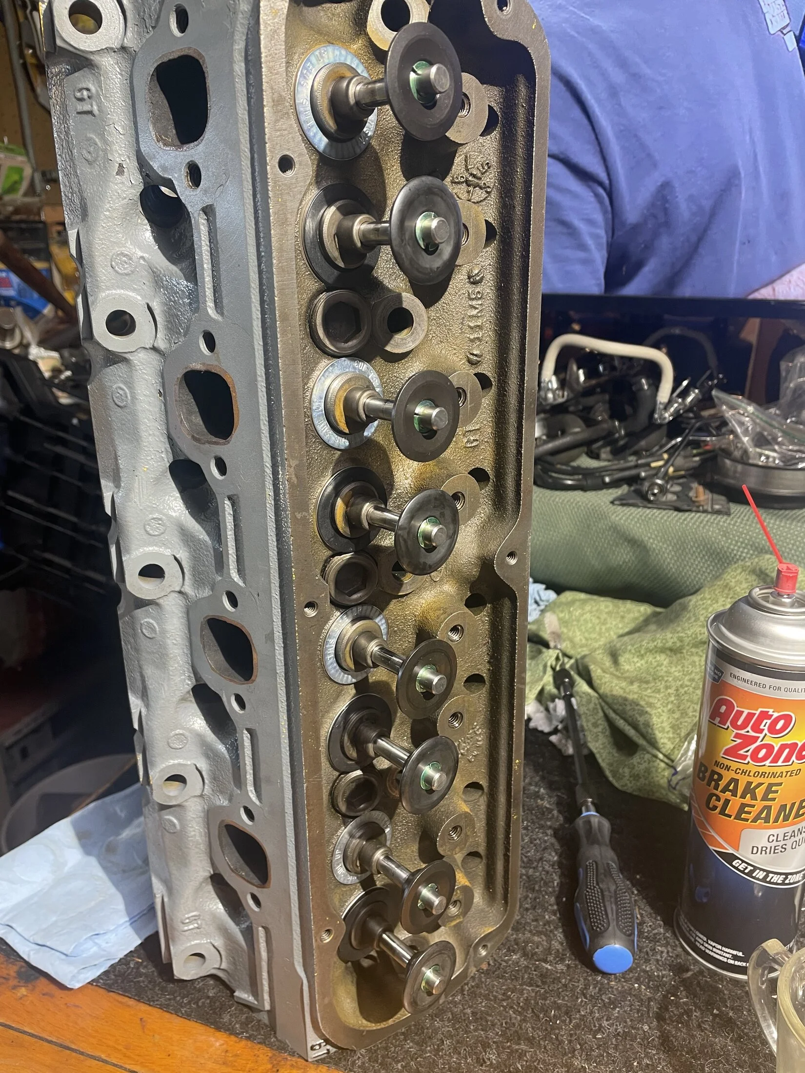

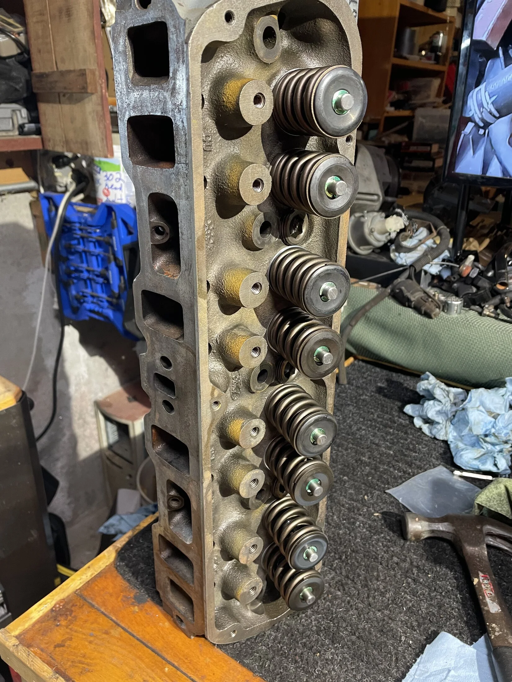

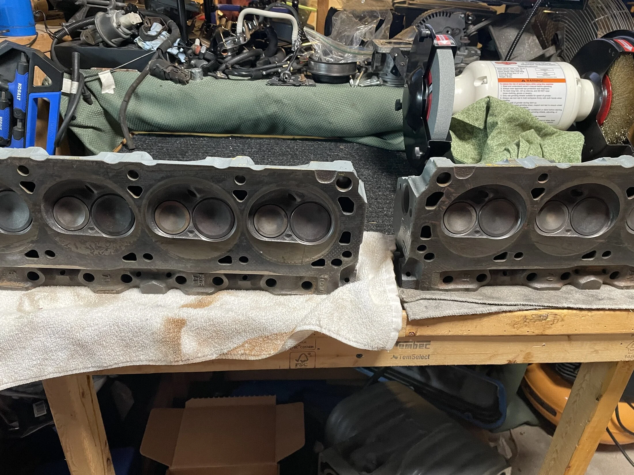

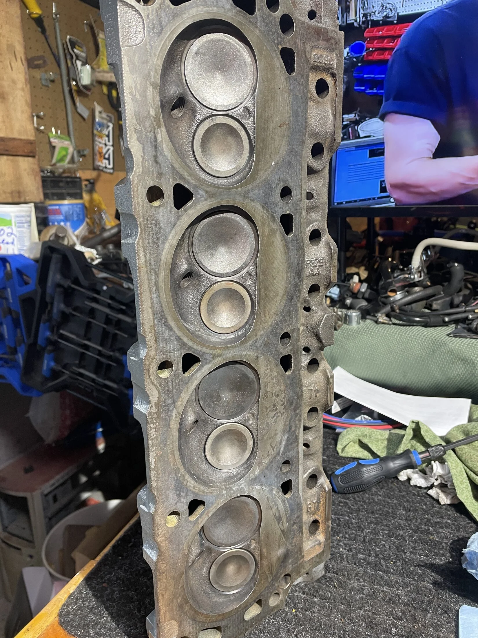

2nd head done. Time to hydro test both :reaper:

Hell yeah man! Looking good and evidently the blood sacrifice to the Mustang gods paid off.

I’m afraid to do the hydro test.
Oct 28, 2001
6,135
4,220
183
Claremore, OK
Mar 12, 2023
#519
  • Mar 12, 2023
  • #519
It pours the water and gets a cold beer...

so far so good. One exhaust valve of the bunch made bubbles and failed the 80psi air
