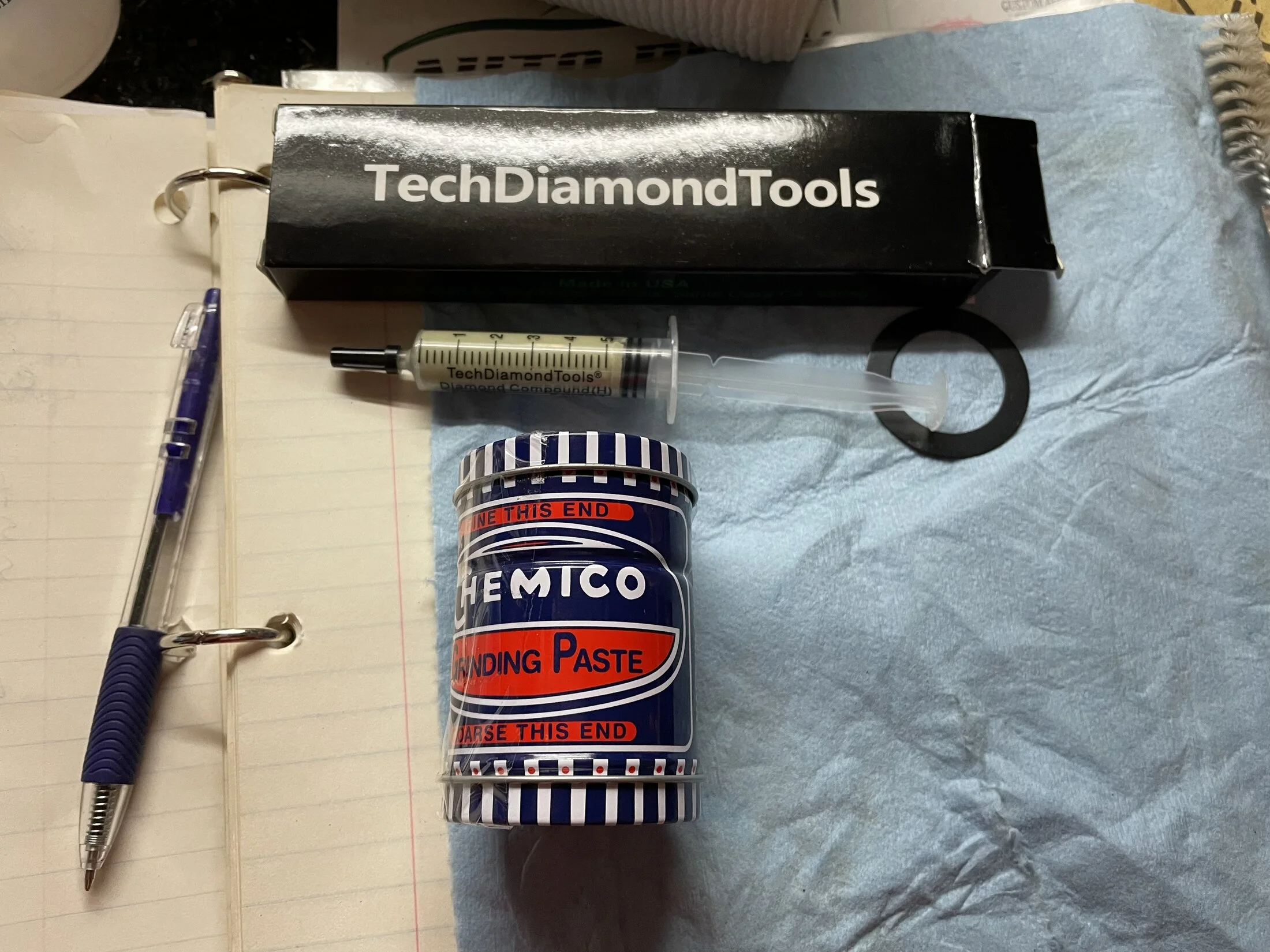

I had used the basic stuff: https://www.summitracing.com/parts/ptx-80037
Went with both of these. They will give me a three step process.

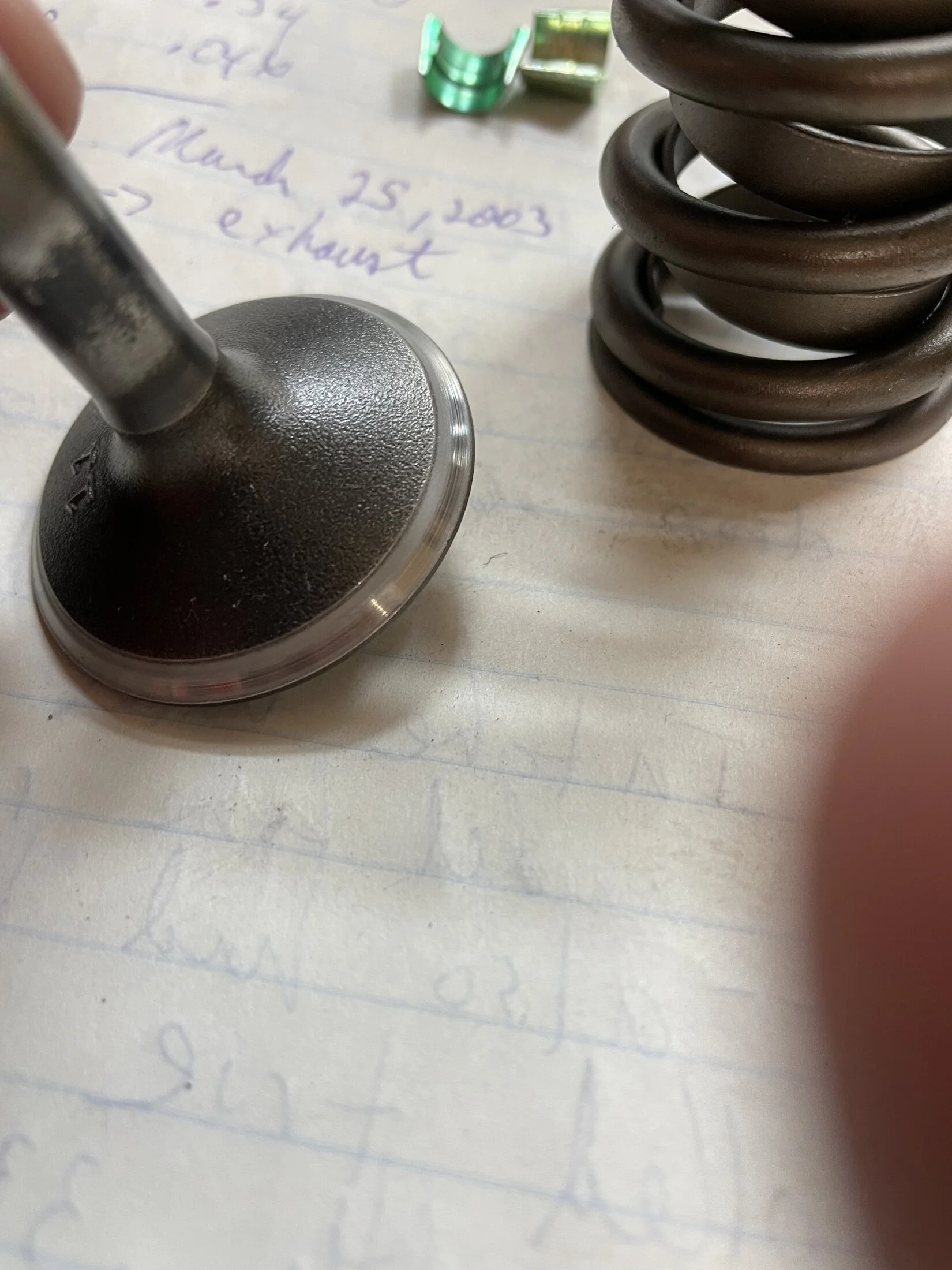

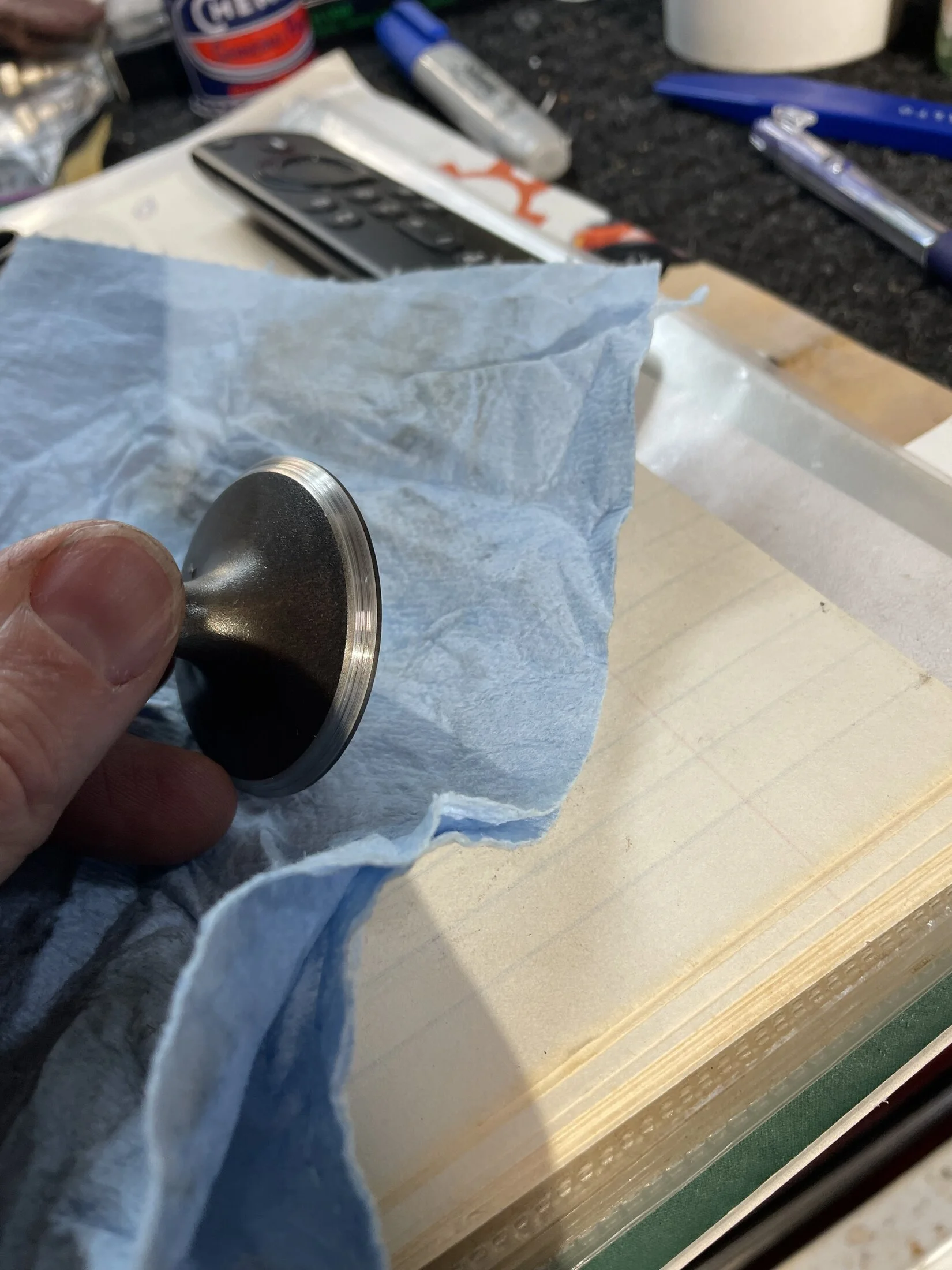

Lol - that 800 grit certainly puts on a polish!!

Good news
Forgot to take a picture, but that leaking exhaust valve is now good.

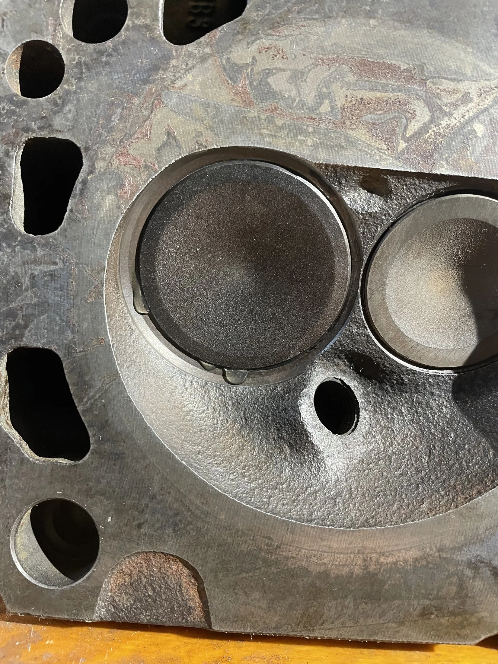

30 minutes in, not looking good

One thing I am going to do for giggles is to hydro test the stock heads I removed. If my lapping is as good or as better as those it’s a different convo.

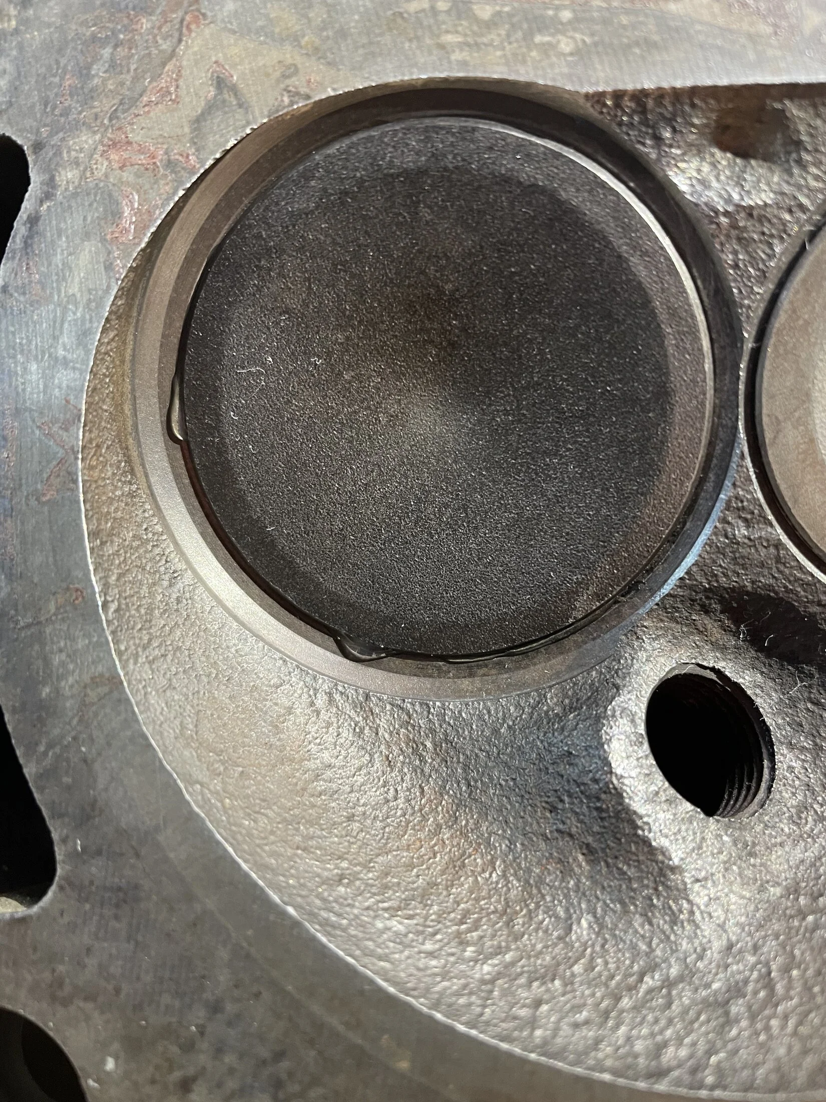

1 hr

Really tried to polish this one up

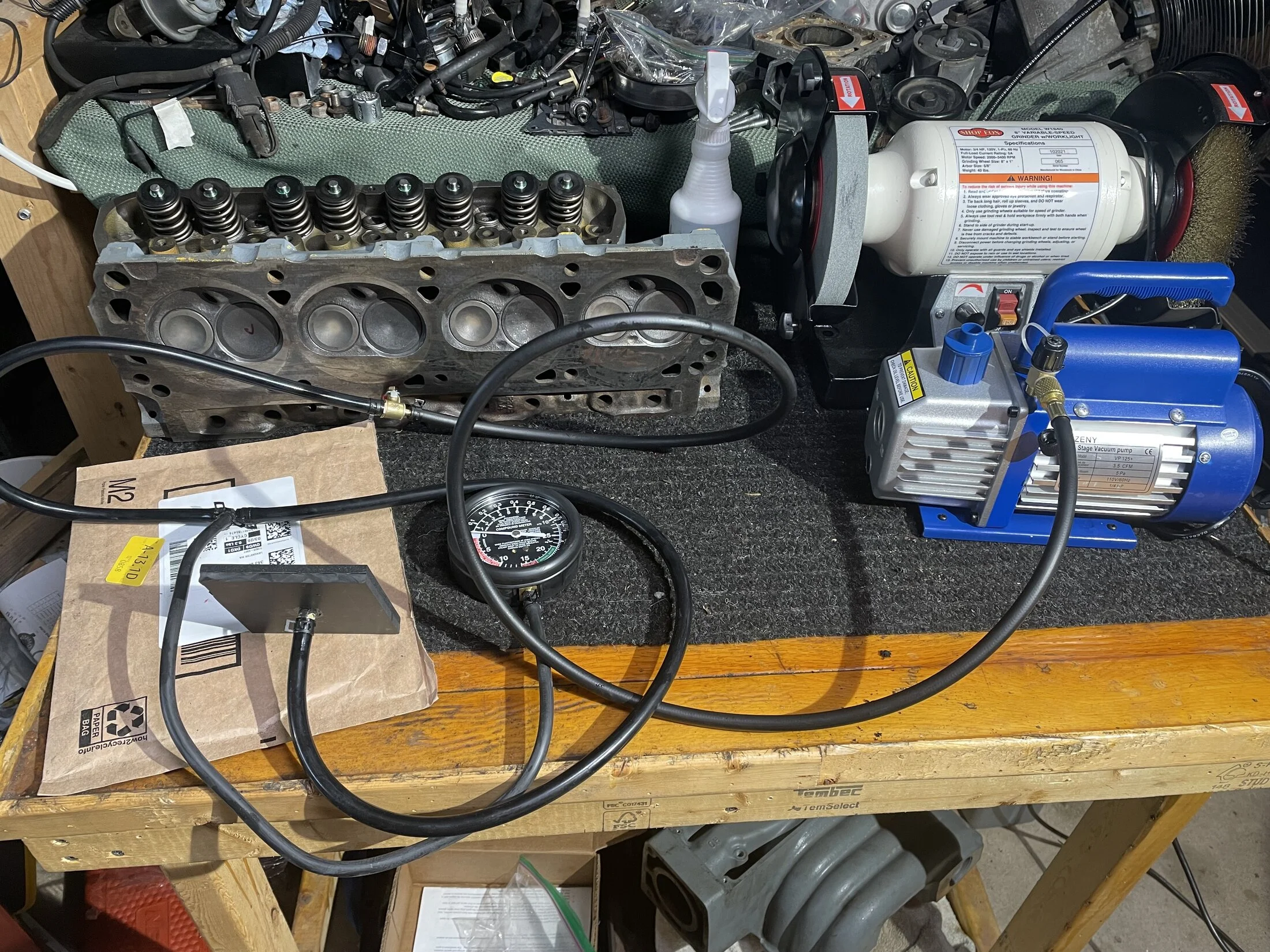

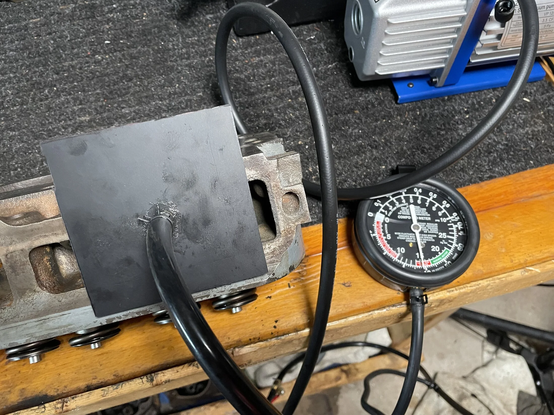

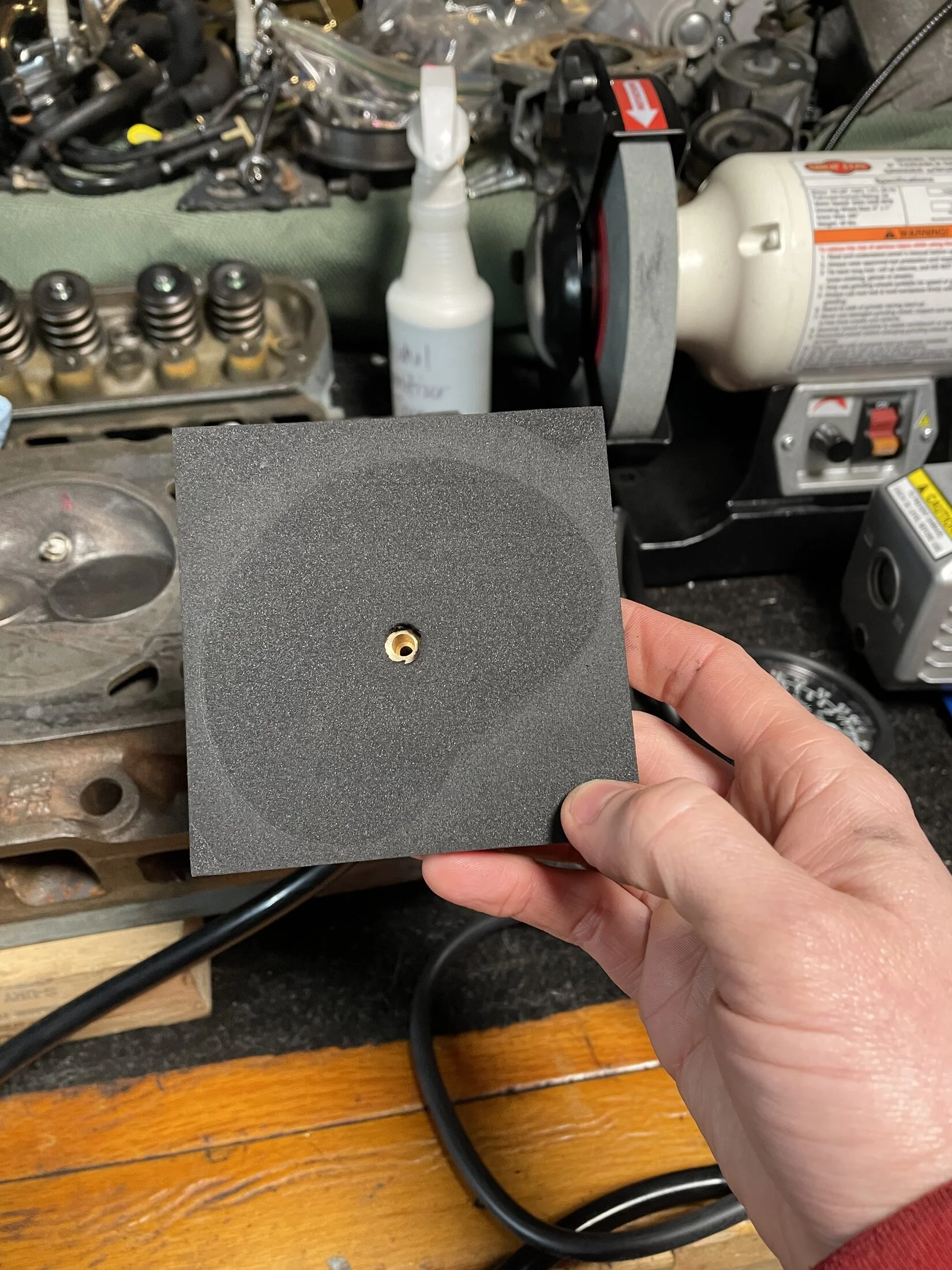

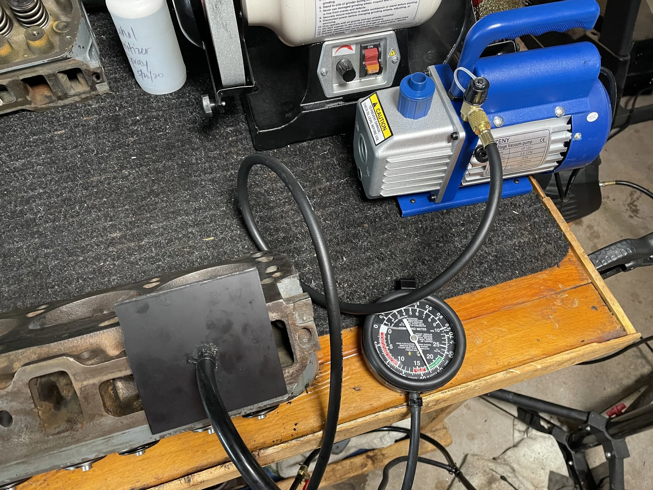

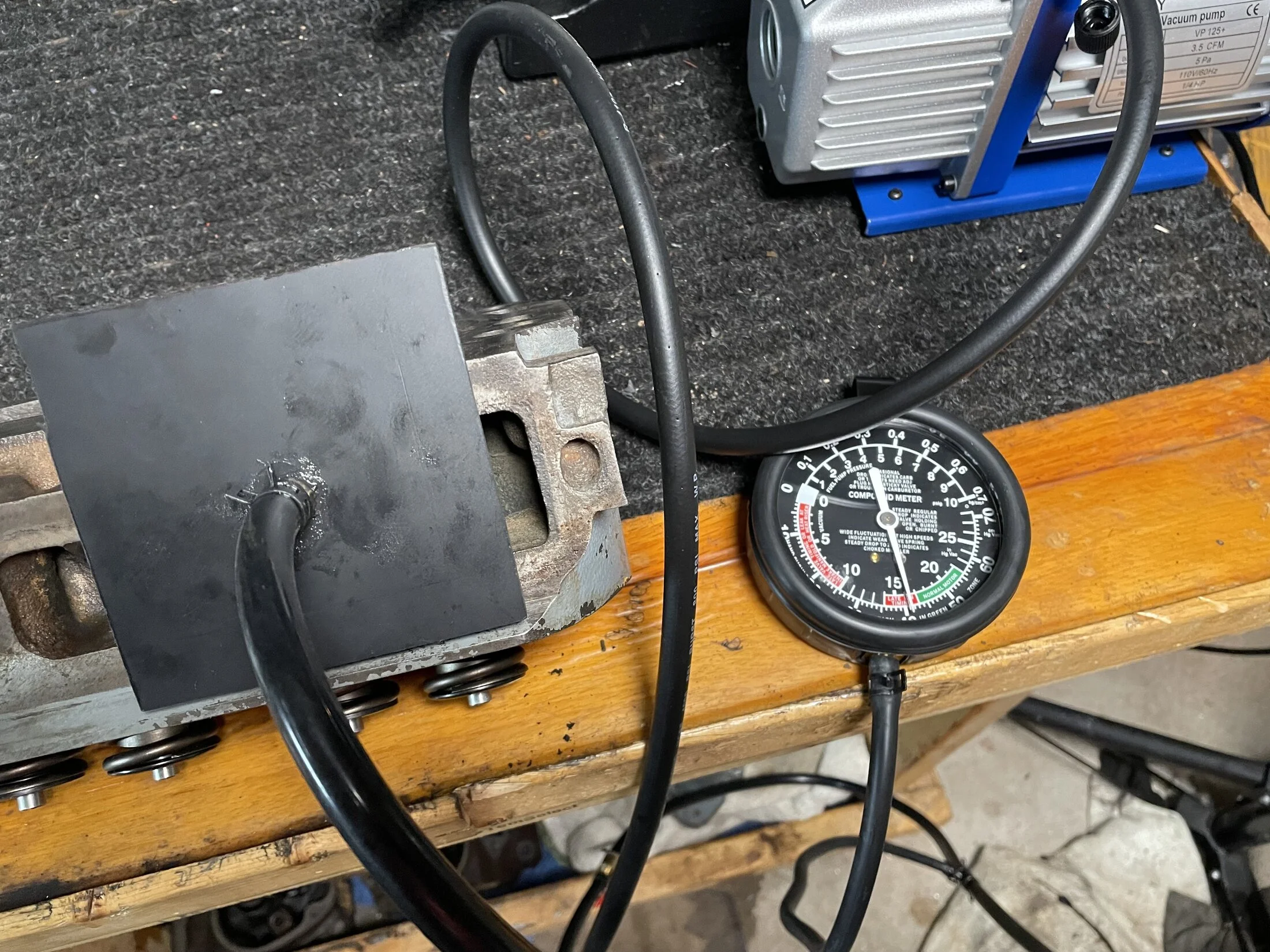

Yes I did it. Ive always wanted a vacuum tester and perform a leak-down test
Im going to put in a spark plug and test both valves.
Setup
With vacuum running
Valve shut off
10 seconds after valve shutoff
JAA
5 Year Member
Oct 2, 2018

True story - just broke the vacuum gauge. Those plastic things are such garbage.

Initial data
GT heads are 70 and 71. Original e7 are 23 and 24 (for reference). I feel its reasonable to say the GT head I finished and measured this way is better than the e7. Next step is to redo the other GT40 head and measure.
HeadCylinderpeak HgAfter 10 seconds (Hg)seconds to 10 Hg
70117.516120
70217.115.2100
70317.51696
704181680
711
712
713
714
23117.51580
23213.911
233191320
23417.115.253
24118.11544
24218.468
243181215
2441886
Reactions: Monkeybutt2000

Final values
Mental note, and for others who stumble on my hot mess here. The torque of the spark plug plays a significant role in keeping vacuum (as you can see by head 71). Do not just hand tighten those plugs. Im confident this directly translates to actual performance also when folks are changing plugs in general.
70117.516120
70217.115.2100
70317.51696
704181680
7111816.2105
71219.817.3126
71319.117151
71418.616120
23117.51580
23213.911
233191320
23417.115.253
24118.11544
24218.468
243181215
2441886
JAA
