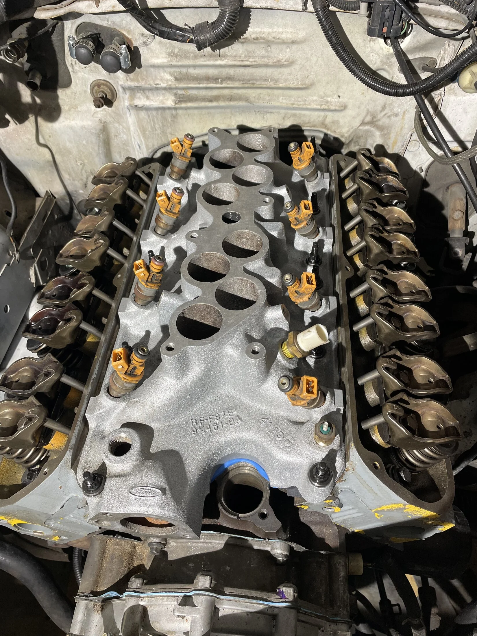

Let’s just say things didn’t go as planned. So crazy how easy it is to go off track on something you have been planning on your head for weeks.
I’m sure it’s fine, just annoying in the moment to watch yourself make some basic mistakes.
Though it’s one of the reasons I enjoy working on cars. The finality and accountability of your work is incredibly simple. There is not too much ambiguity in this type of work. Either you got it right, or you don’t. And then you have to tear it all down and do the exact same thing again. Simple.

I decided to go with the ends as manufacturer recommended and it was what my block previously had.
First mistake - if you degrade the integrity of a RTV tube, don’t try to “make it work”. First, always have a unopened spare. Or if needed, run to the store. A simple hole in the side of the paste tube screws everything up.

When installed exhaust headers I have a bunch of bolts and studs. Is there a method to where the bolts vs studs go?
limp
5 Year Member
Oct 4, 2020
MY experience is stock exhaust manifolds tend to use studs, where headers are ALOT easier to do with bolts.....

The studs go into the outside holes, the idea is/was the outside gasket hole were slotted, install studs, hang the headers, drop the gaskets from the top onto the studs, install bolts, tighten as needed.
A lot of members just use red high temp gasket stuff, at least some claim to.
All I use on my turbo headers

I thought I created a list here of next steps, but I cant seem to find the post. Ill retype, I believe this is whats left in which order
  1. The lower intake coolant, et al fittings.
  2. Exhaust headers and down pipe
  3. Heat pipe
  4. Valve covers
  5. Fuel rail / injectors / lines
  6. Upper intake
  7. EGR spacer
  8. TB
  9. Remaining Vacuum connections
  10. Distributor / plug wires
  11. Radiator / Electric Fan
  12. Accessories / AC delete / PS Pump and lines
  13. Battery
Any comments on scope or ordering?

JAA said:
Gasket shopping list:
  • 2 of these: https://www.summitracing.com/parts/fel-9333pt1
  • https://www.summitracing.com/parts/fel-ms95952
  • https://www.summitracing.com/parts/fel-1404
  • https://www.summitracing.com/parts/arp-154-3601
Any got a AC delete and Smog delete serpentine belt they like? I believe its either 72.5" or 73". Im having trouble finding a part number. If I cant, ill prolly just go to AZ to get what they have. Maybe these?
  1. Amazon product ASIN B08SNX7SRY
  2. Amazon product ASIN B08SP9CWP1
Deciding against under drive pulley's for this go around. Going to save some money there. Frankly, if Im going to spend more money I want it to be on new roller rockers.
What else am I missing? I havnt decided about the MAF and TB yet. I will wait until ive got everything assembled to figure that out. Might be more money there
How is it possible, with all the super amazing Fox Body knowledge here, that no one ... and I mean no one ... noticed my mistake? Whats this, 2 months later and I find out?
Funny part is the pic checked out as they fit my 1986 Cobalt 21BR. I just replaced them this spring.

Is this the right exhaust manifold gasket? Im not sure about the down pipe/flange o-ring gasket stuff? Is that needed? I do not recall removing any of that when I disassembled.
https://www.summitracing.com/parts/FEL-MS90000
Don't buy any of that. I like the Percys mls gaskets for the headers.
