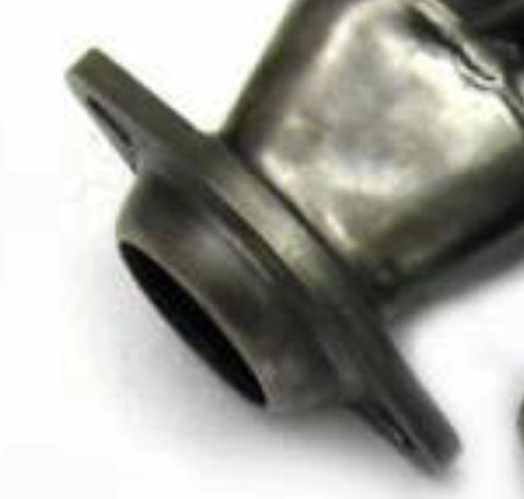

If factory style I believe all of your exhaust should be fire cone joints and look like this

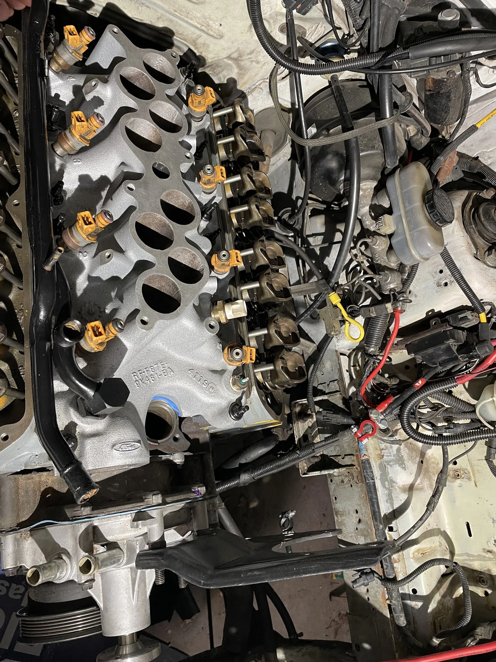

So with these arp studs on the lower intake, what do I do about the heater tube?
Stock is a stud and nut torqued down. Then heater tube bracket and another stud.
The arp studs didn’t come with another nut, the stock ones don’t fit. In addition, the arp nuts are a bit beveled?
Thoughts? Obviously I could just put under arp nut, but I’d have to remove the nut and retorque. The beveling of the arp nuts leads me to believe nothing should go on top.

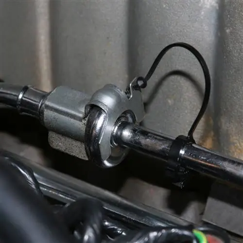

What does everyone use for Fuel Line Rail Clip and Tether? Return and supply lines are different?

I just put a flat washer on top of the hex but then put tab of the heater core tube on top of that and used another nut to torque it down.
If you do not know what the thread size is on the stud just remove the nut and take that with you to a hardware store and you should be able to match it up. Reinstall the nut and torque.
Are you talking about the clips that hold the fuel line to the fuel rails? Like this:
yea - those fuel caps. One of my tethers snapped cause they are cheap plastic. The sell for like $15 and $25 respectfully. Are there any DIY work arounds?

I have not run a tether since I swapped the car to a V8 back in 2002 so I am of no help. When I need to I pop the clips off and put them on top of the radiator otherwise known as the small parts holder.

Not sure if they were meant as a safety feature but more of a "pop the clip off and not loose it" feature.
I do not have a set but I would not throw them away if I had them either.
