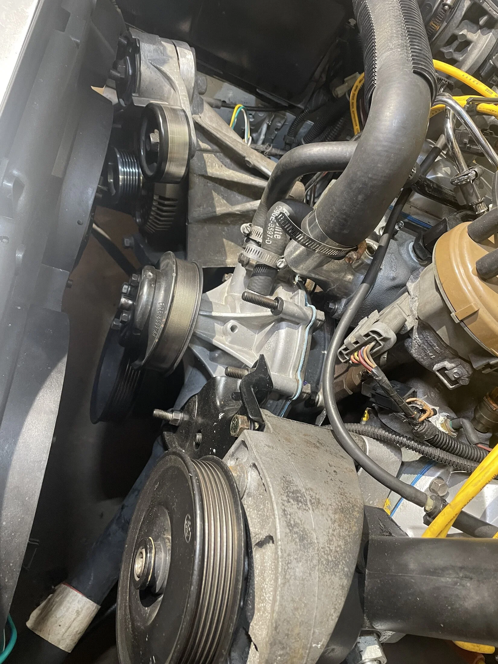

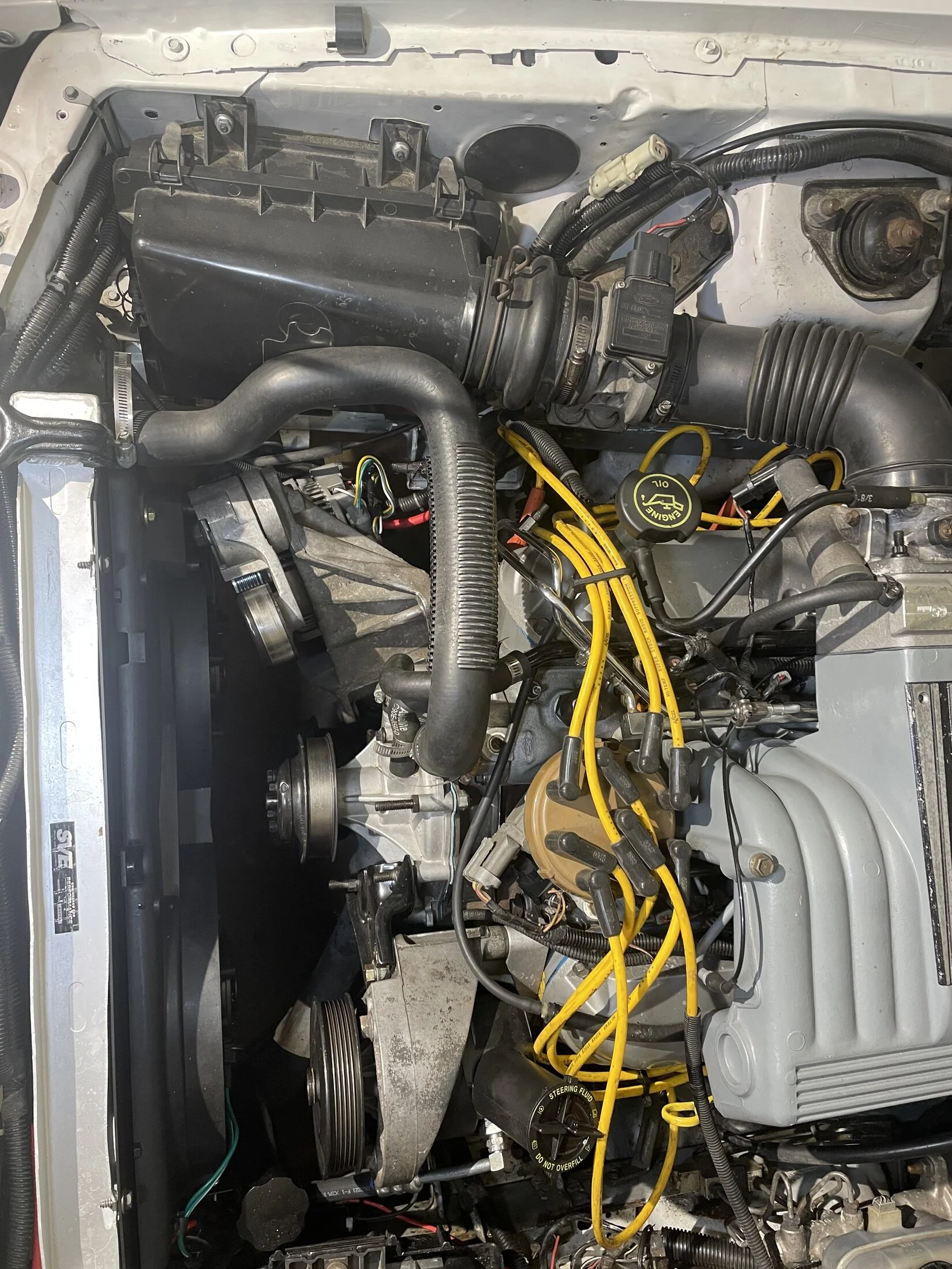

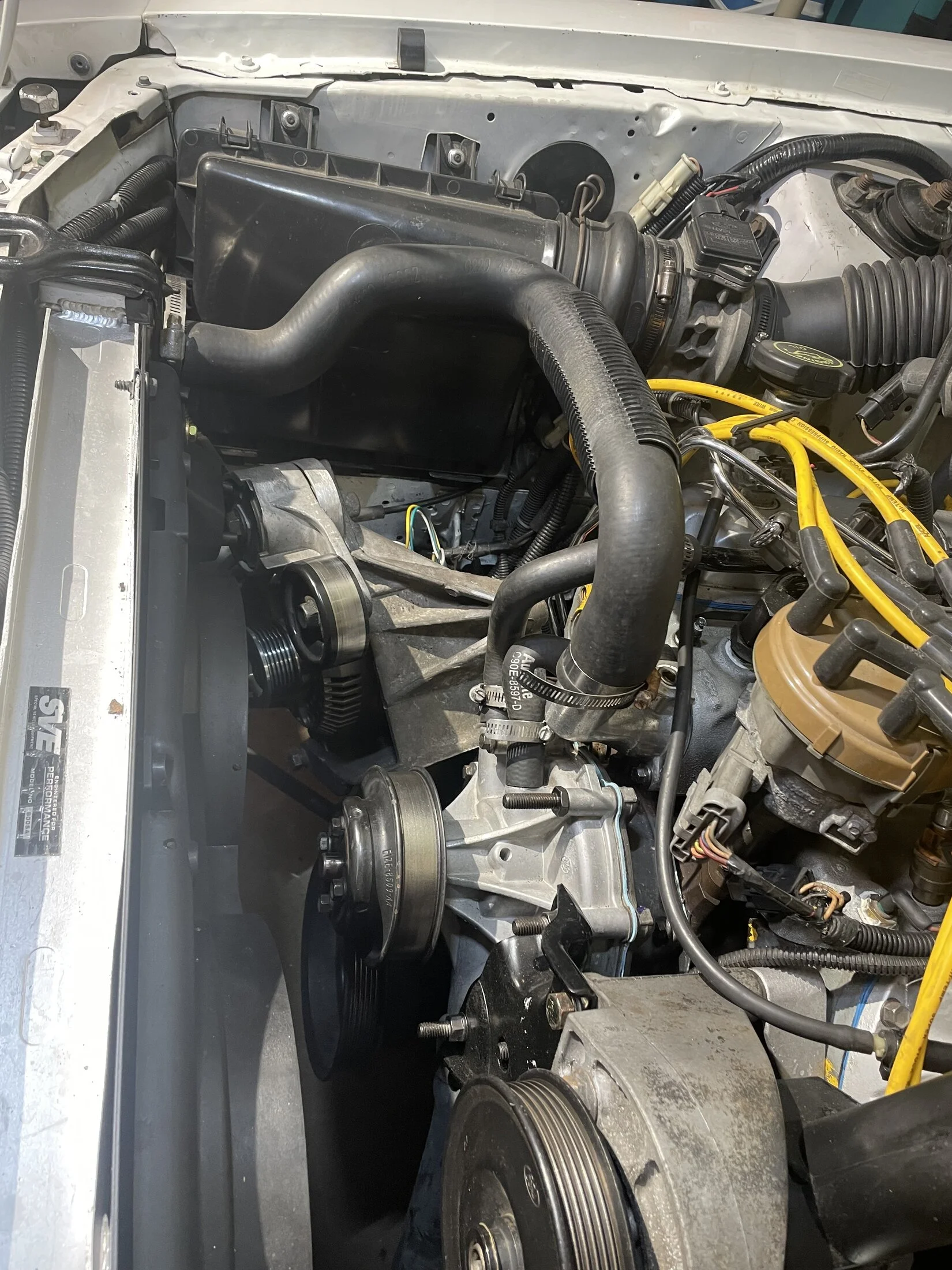

Oof

What the hell happened? I see a broken bolt so did the whole accessory bracket pop loose and go into the radiator?

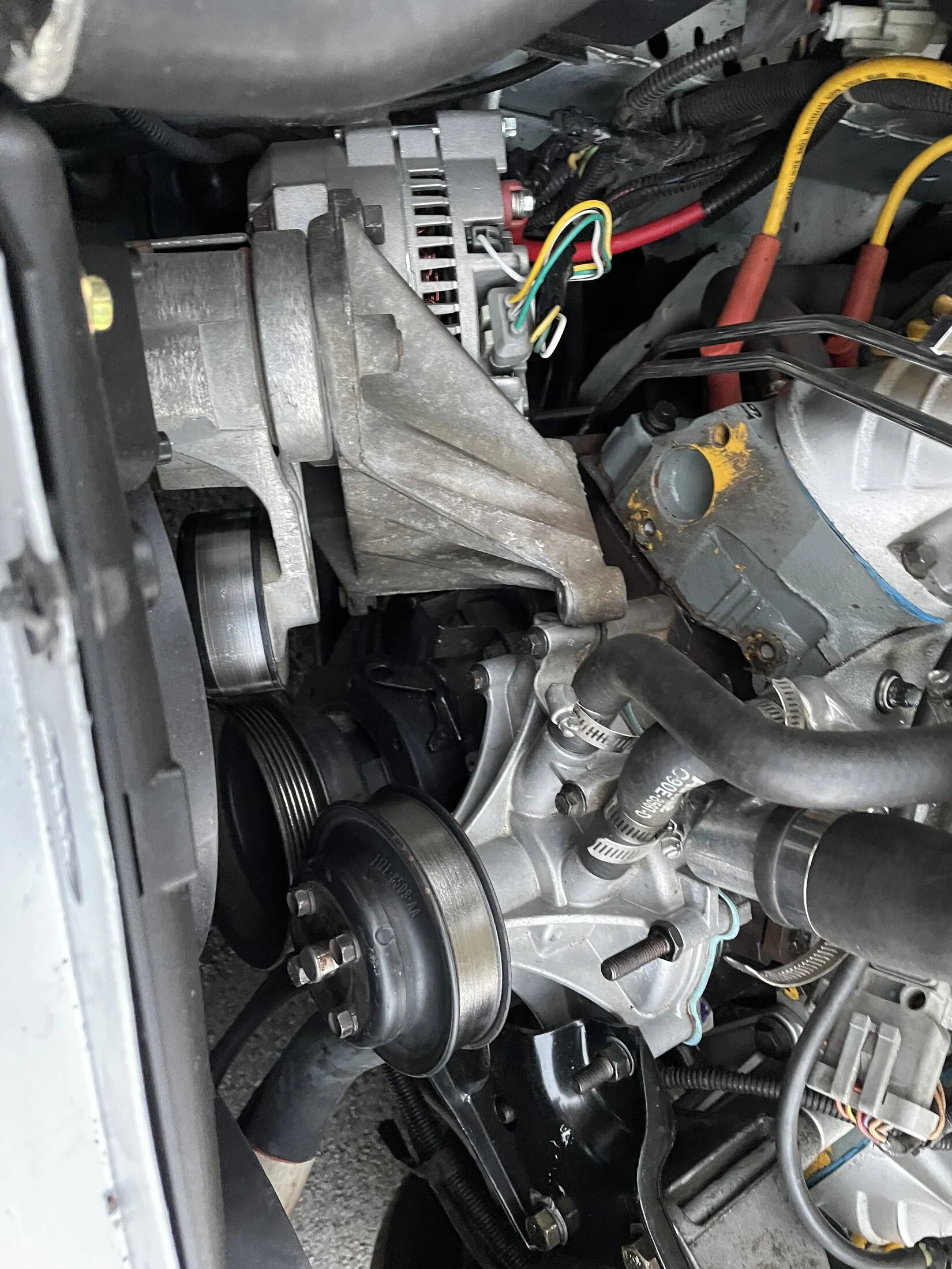

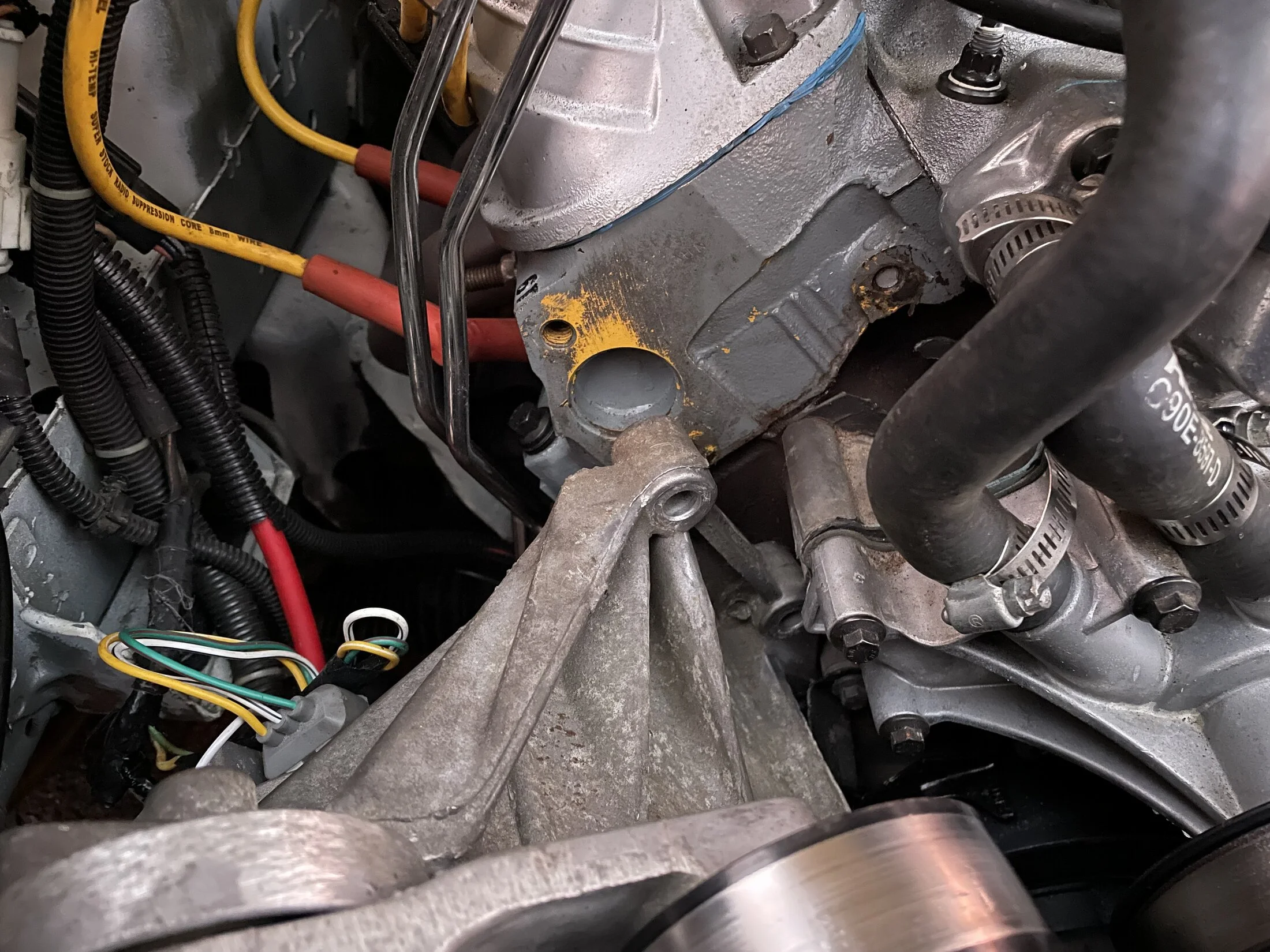

What I think happened …
My serpentine belt was just out of tension spec on the tensioner. I believe my “spirited” drive home caused enough vibration to shake and shear 2 bolts.
Then water pump stopped working and over pressurized. Hence the overflow leak.

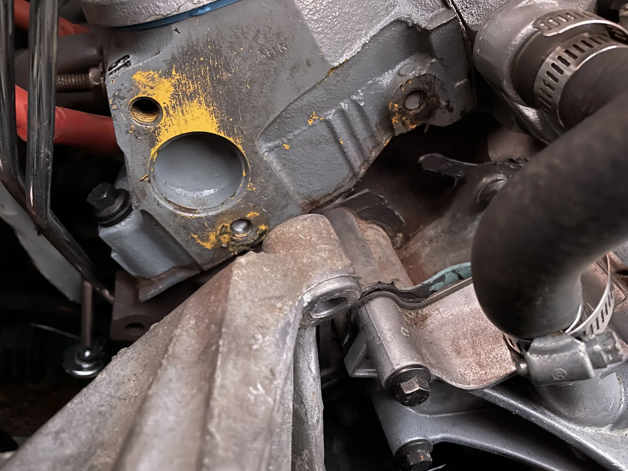

I am not looking forward to drilling out those bolts from the head. Not. At. All.

I swear it was like 1/8” off tensioner spec.
Also, I only see 2 sheared bolts. Did I forget a bolt when bolting it back up?

Town truck guy owned an 87 Foxbody. He’s feelin my pain.

Don't use grade 5 bolts when you put it back together.

What a great shot of 3-bar cylinder heads though. Way better than the ones used to ID those heads. LoL
Don't drill them out. Do the weld on nut process, then just thread them out. Will leave the head virtually unscathed.
Never done this. Got a good video or instructions for it?

Bracket assembly is Figure 6:
https://latemodel.cachefly.net/downloads/instructions/LRS-10313INS.pdf
Pretty straight forward if you weld:

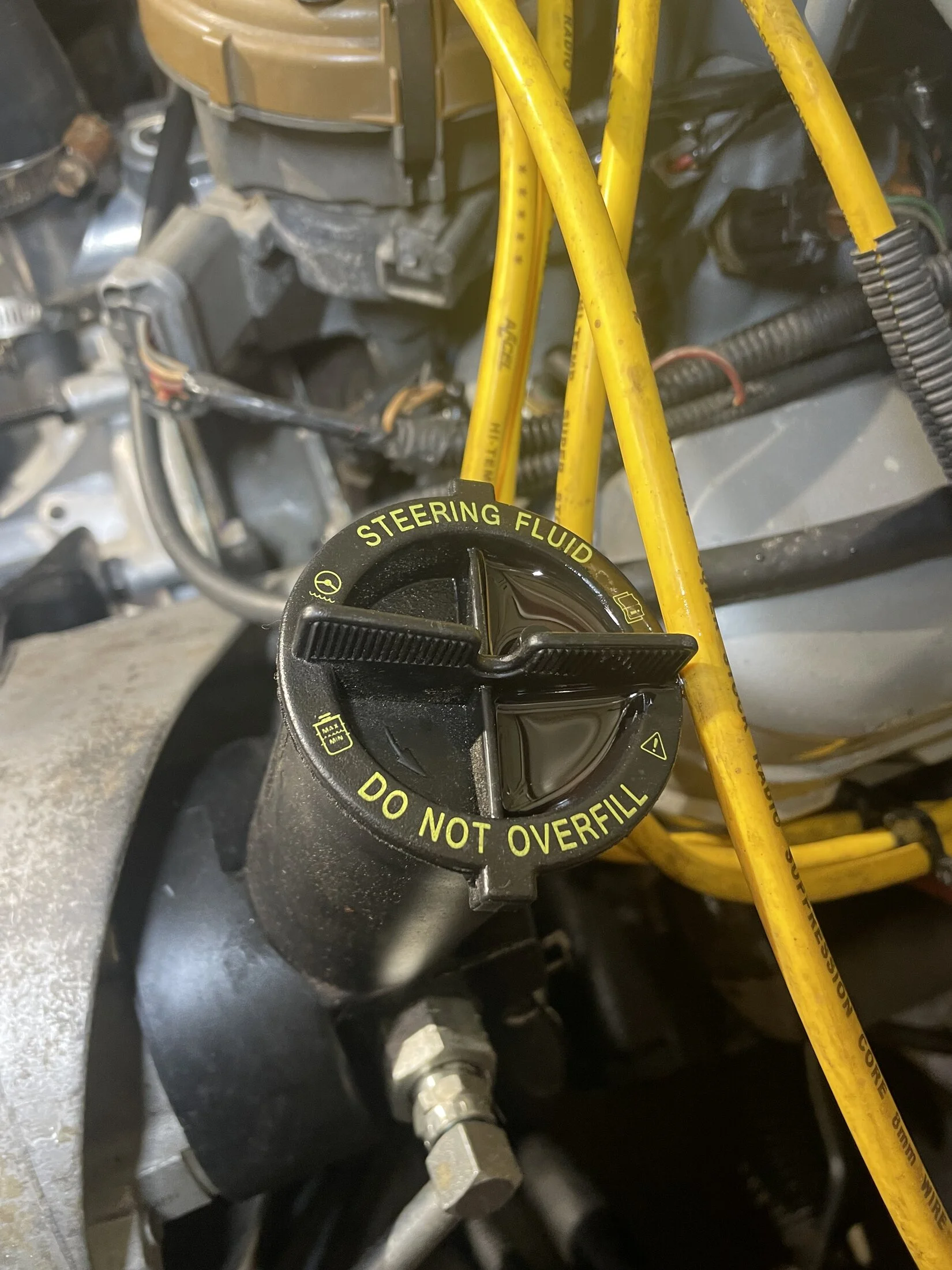

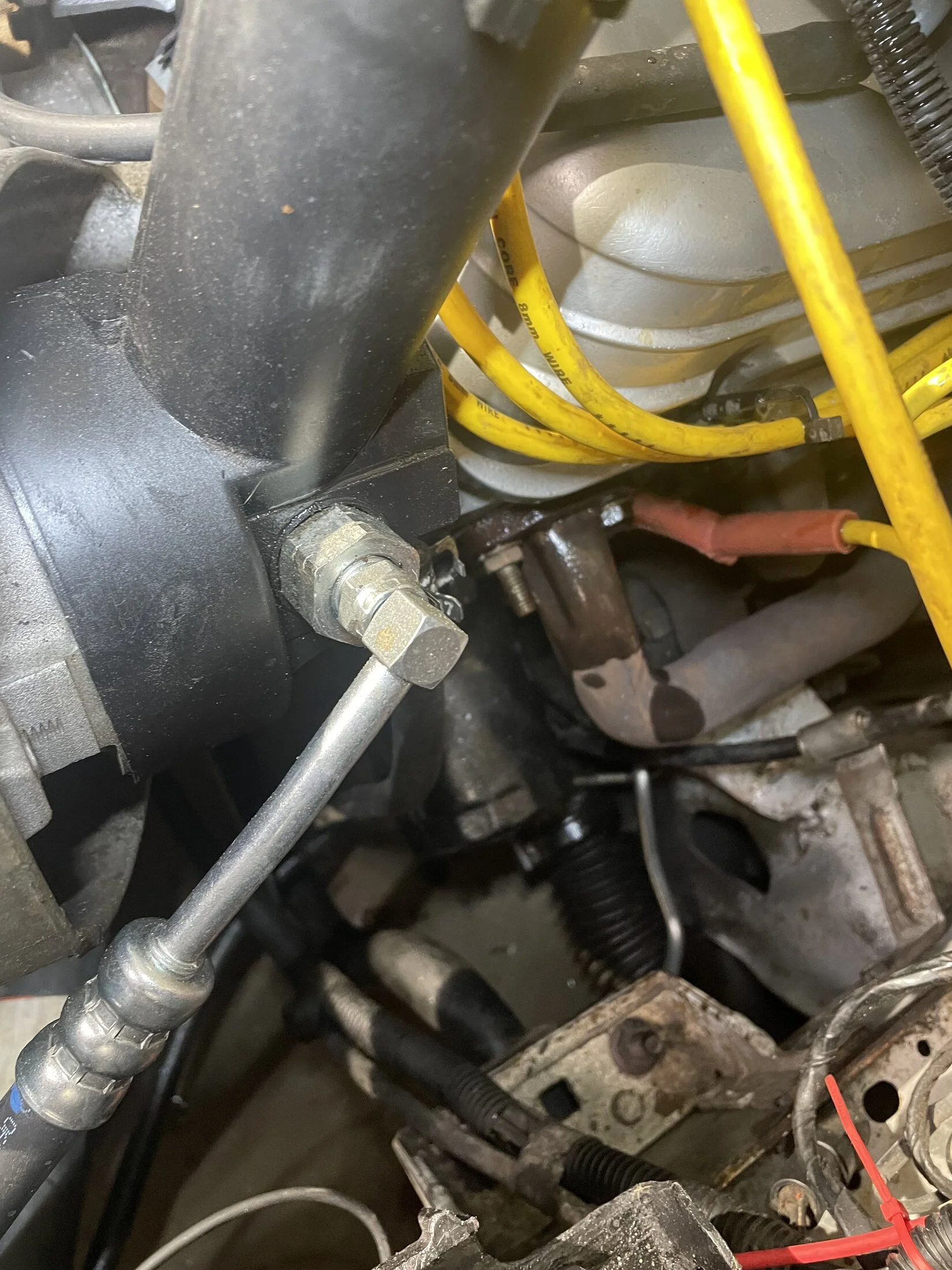

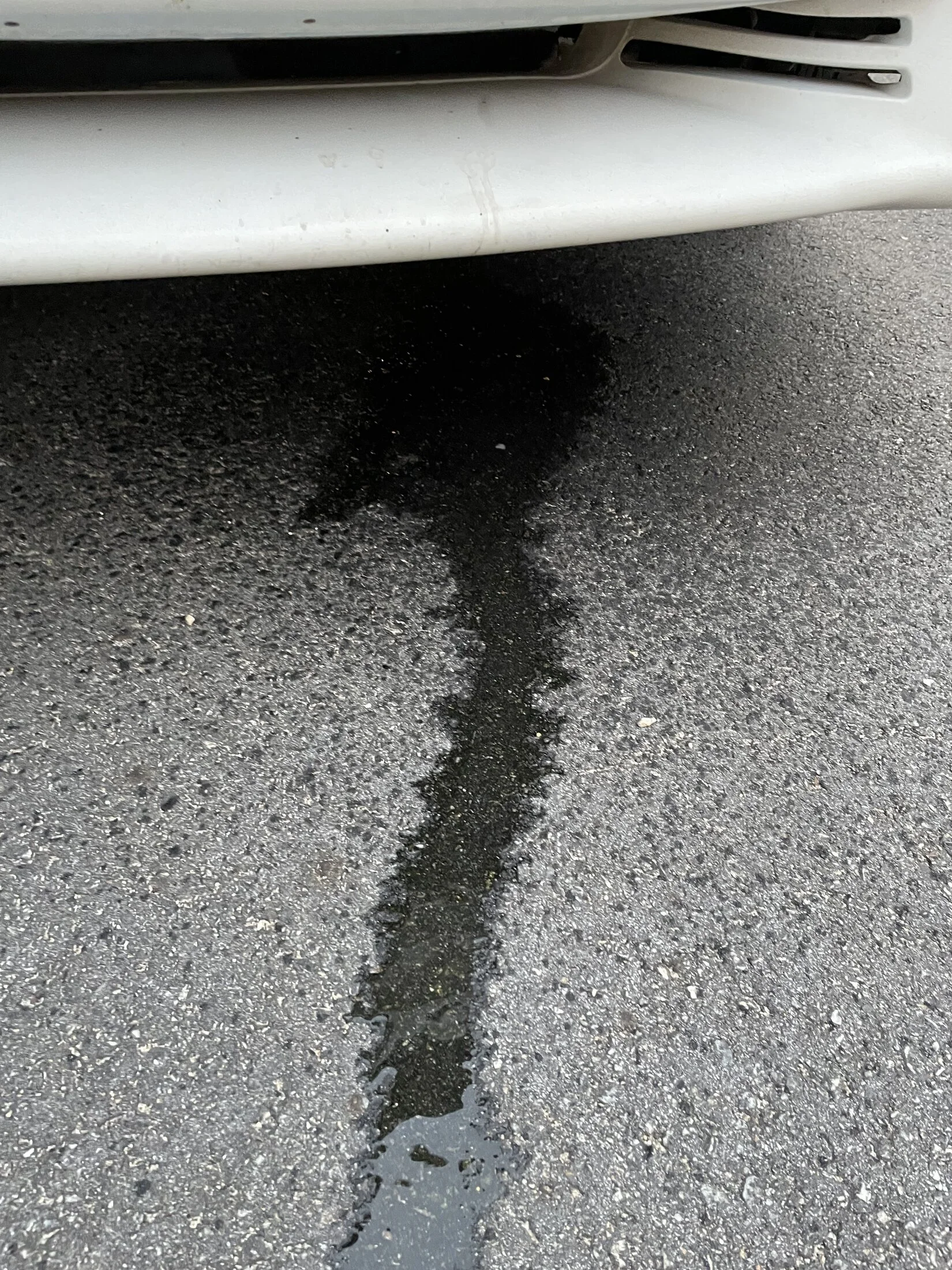

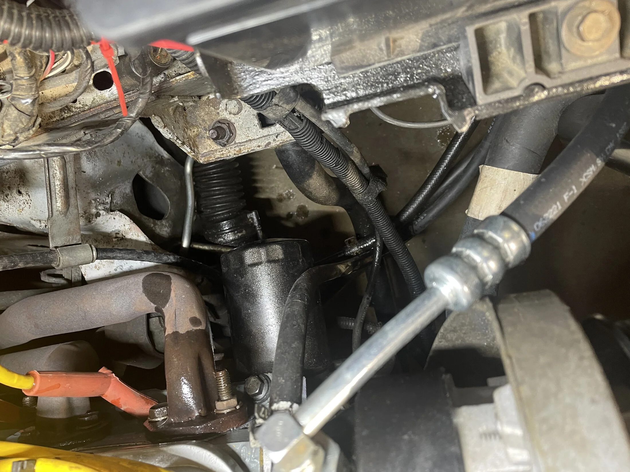

Just pushed car to get it facing in to garage. Looks like dripping PS fluid. Was turning the wheel a whole lot. Would this failure somehow cause that?

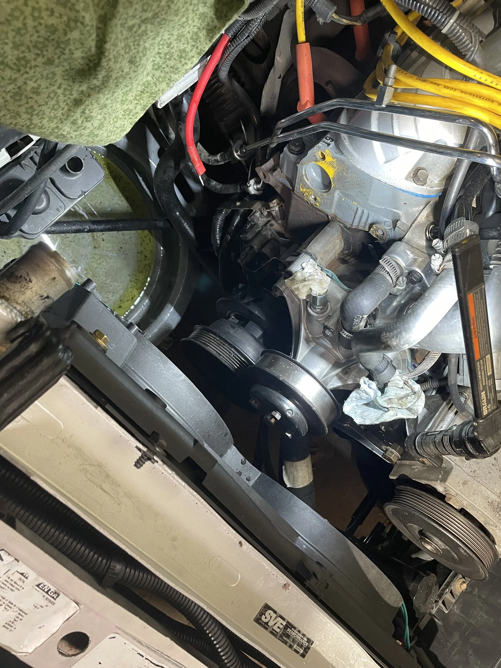

Just some more reference pics. Sorry for camera angle

Interesting PS pics. This is untouched yet by me

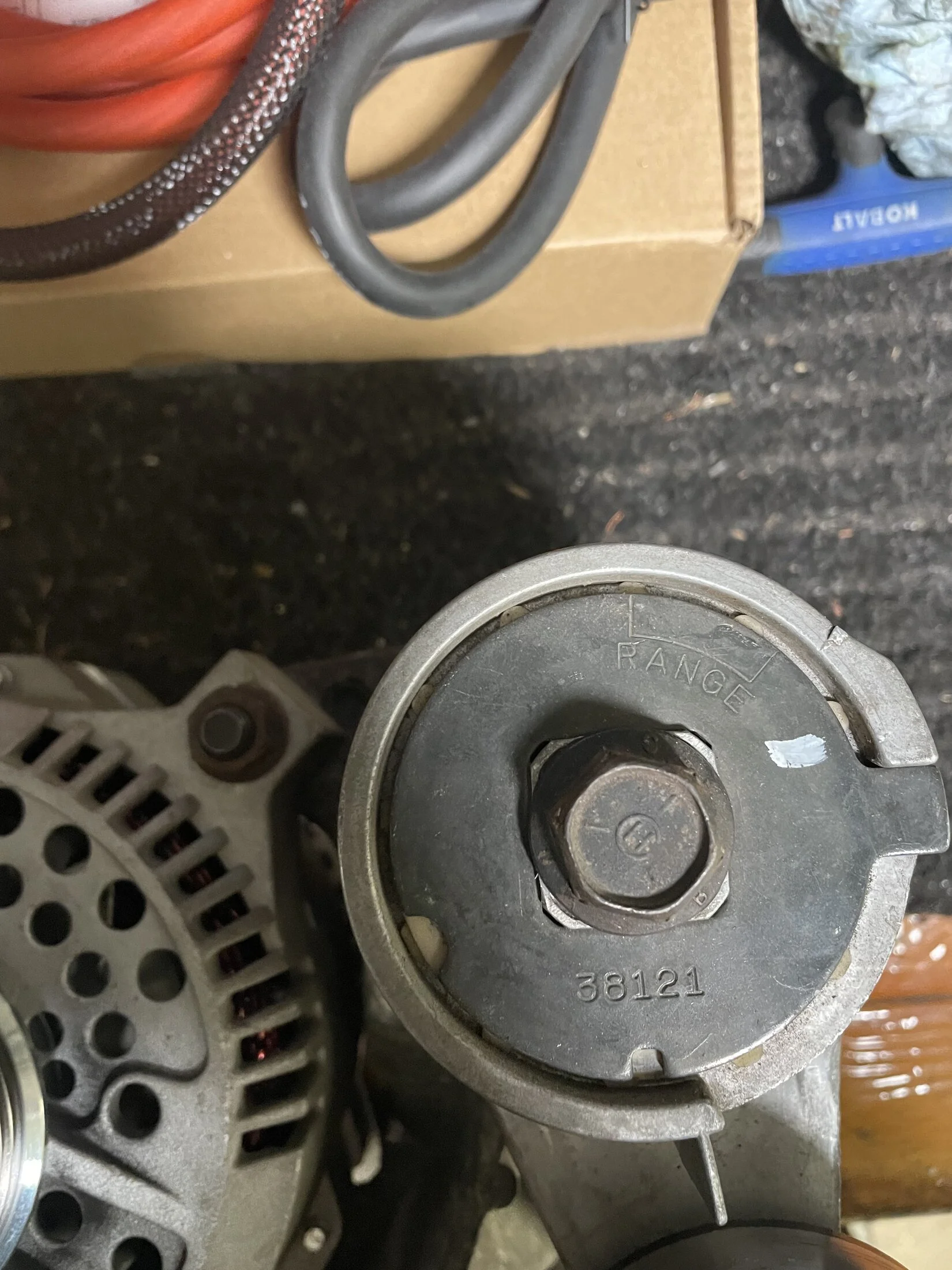

Lol - lesson #1:
Being 1/8” outside the tensioner is the MAX outside you can be. This pick shows the backstop of the tensioner is at the end. So no, I wasn’t 1/8 I was at the end and I could have been completely loose as the guage wasn’t able to show me.

So the thought is, as a first time welder, I’m going to get into this space, weld up a mount, put the nut on top, then weld it there?

Funny story. So when a boot shears but isn’t rusted, it may be super easy to get out. So easy that when you start drilling it, it literally starts turning. Catch it quick though, it will start tightening!
