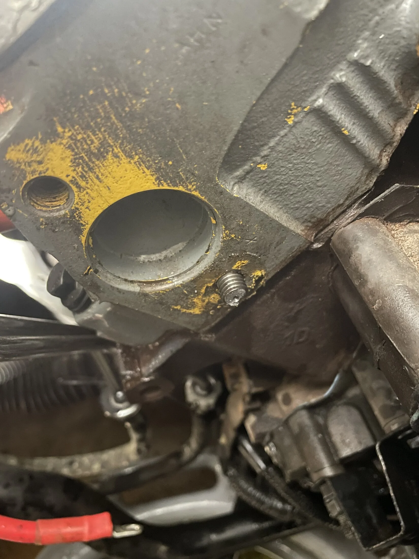

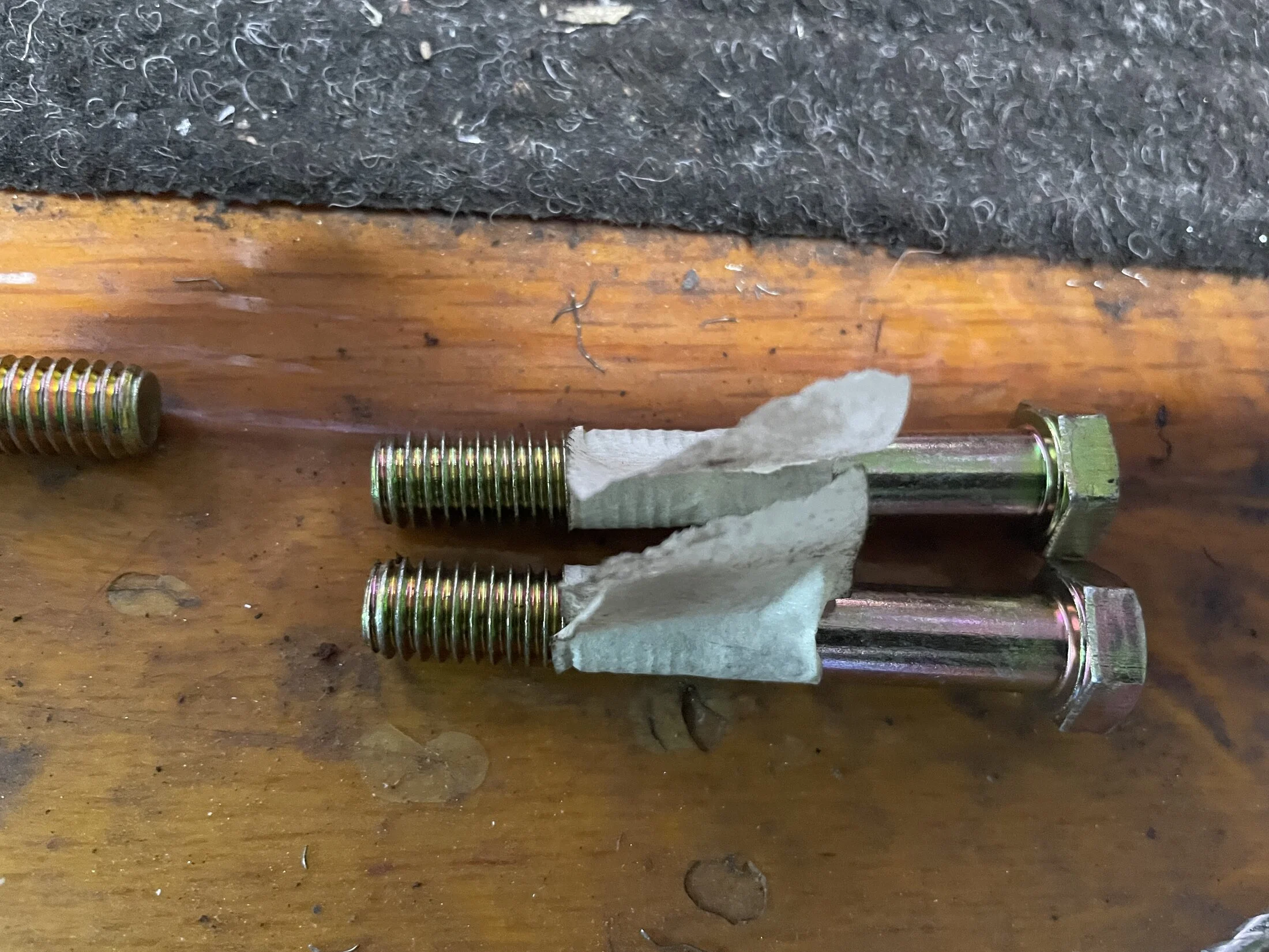

Uh - was that bolt long enough?
General karthief
Mod Dude
Aug 25, 2016
28,030
10,656
213
polk county florida
Sep 16, 2023
#902
  • Sep 16, 2023
  • #902
No.

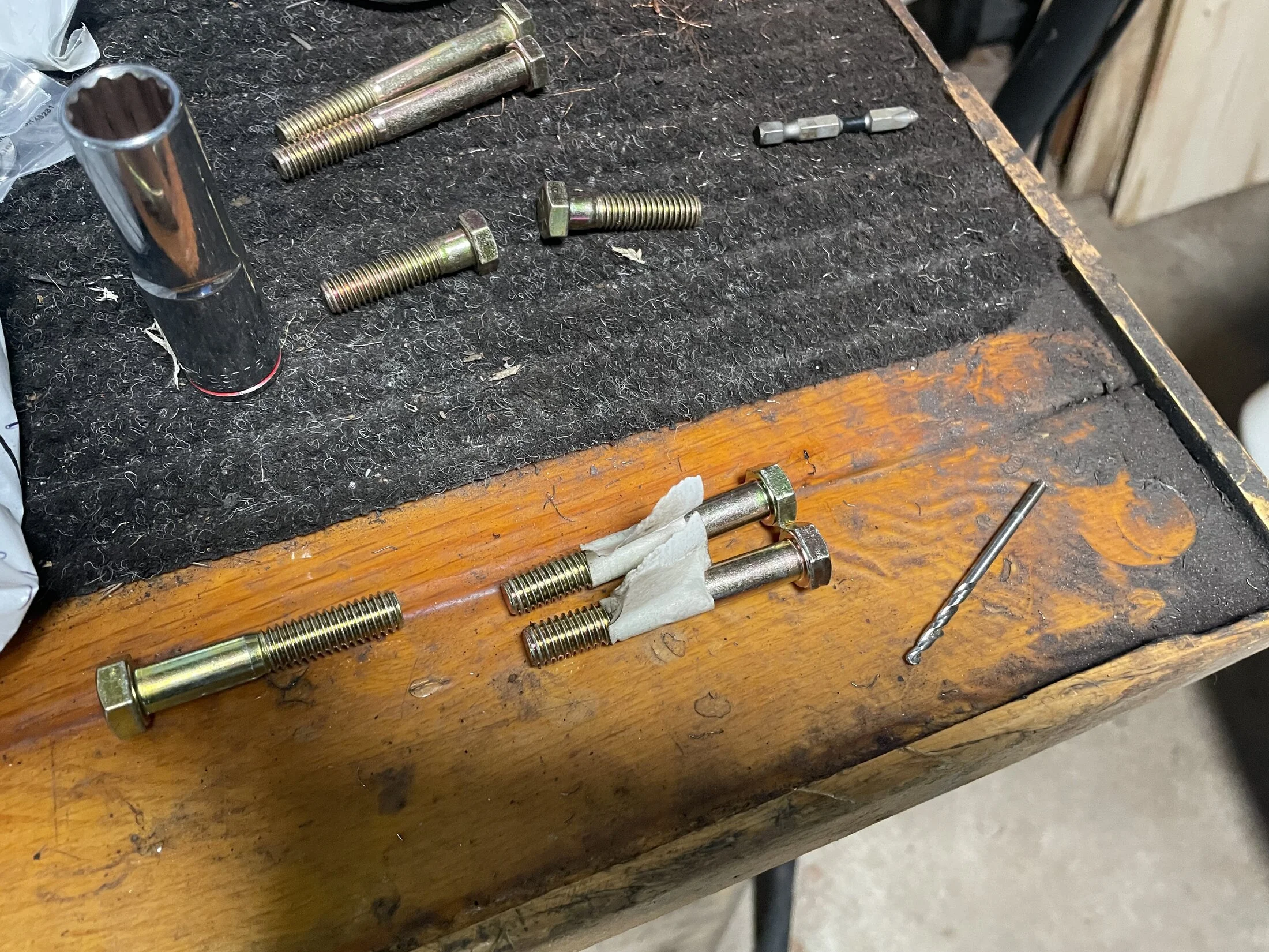

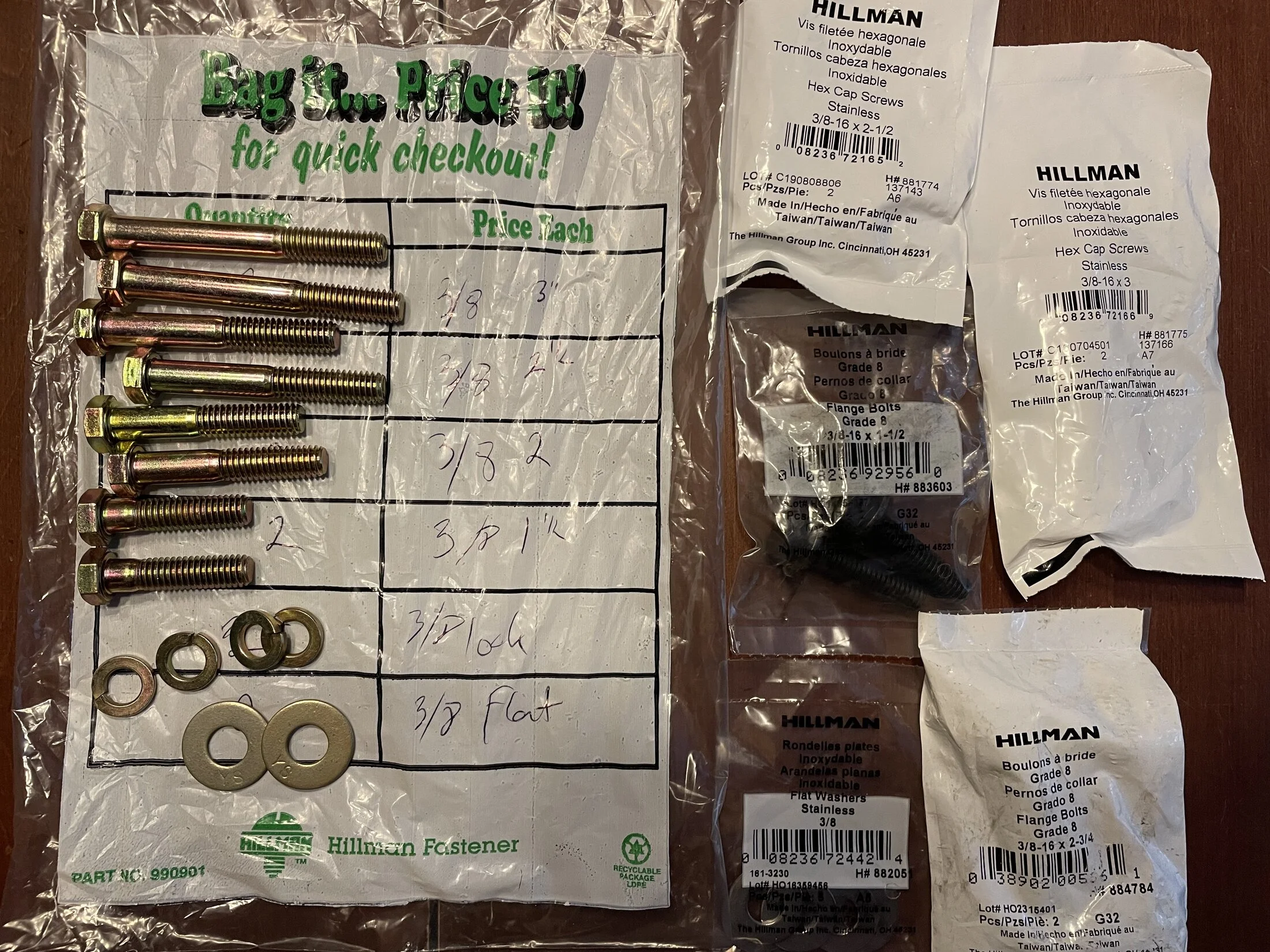

Second one was a little more complicated as it’s harder to get to, but once I got into it, also came right out.
So where do I by these grade 1 awesome fantastical special steel screws?

JAA said:
Funny story. So when a boot shears but isn’t rusted, it may be super easy to get out. So easy that when you start drilling it, it literally starts turning. Catch it quick though, it will start tightening!
thats why you use reverse drill bits.....
Reactions: General karthief
85GTStangGuy
5 Year Member
May 19, 2021
1,005
628
133
Jax, Florida
Sep 16, 2023
#906
  • Sep 16, 2023
  • #906
Like Limp said, a left-hand drill bit would solve that issue.
Was that the factory length bolt(s) for that location(s)?
1-1/2 times the nominal bolt diameter is the rule of thumb I've always used for enough (aka minimum) thread engagement in cast iron.
As evidenced by the the bolt shearing off, and not pulling the threads out of the block, there was enough thread engagement there, imo.

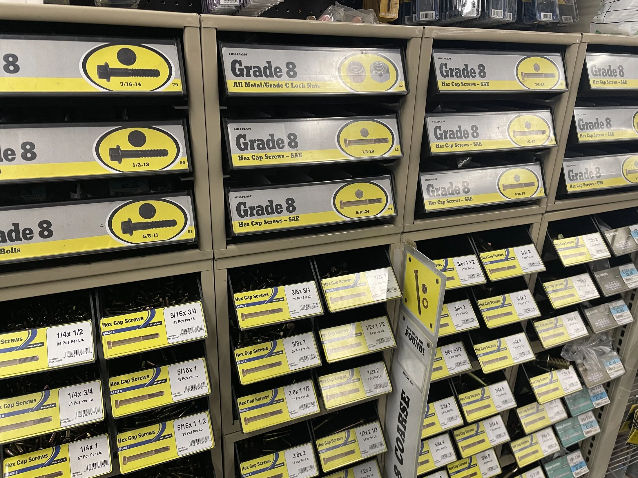

You want grade 8 (there is no grade 1, btw) bolts of the same size as your broken ones. If the tapped holes in the block are deep enough, you could go with a slightly longer bolt, but as long as you have the minimum needed thread engagement, there won't be much gained.
Ace Hardware has a pretty good selection of fasteners, if you're looking for a local place. And they can easily be ordered online, but usually you have to buy a quantity greater (sometimes much) than the 1 or 2 needed.
Reactions: JAA

Tractor supply FTW

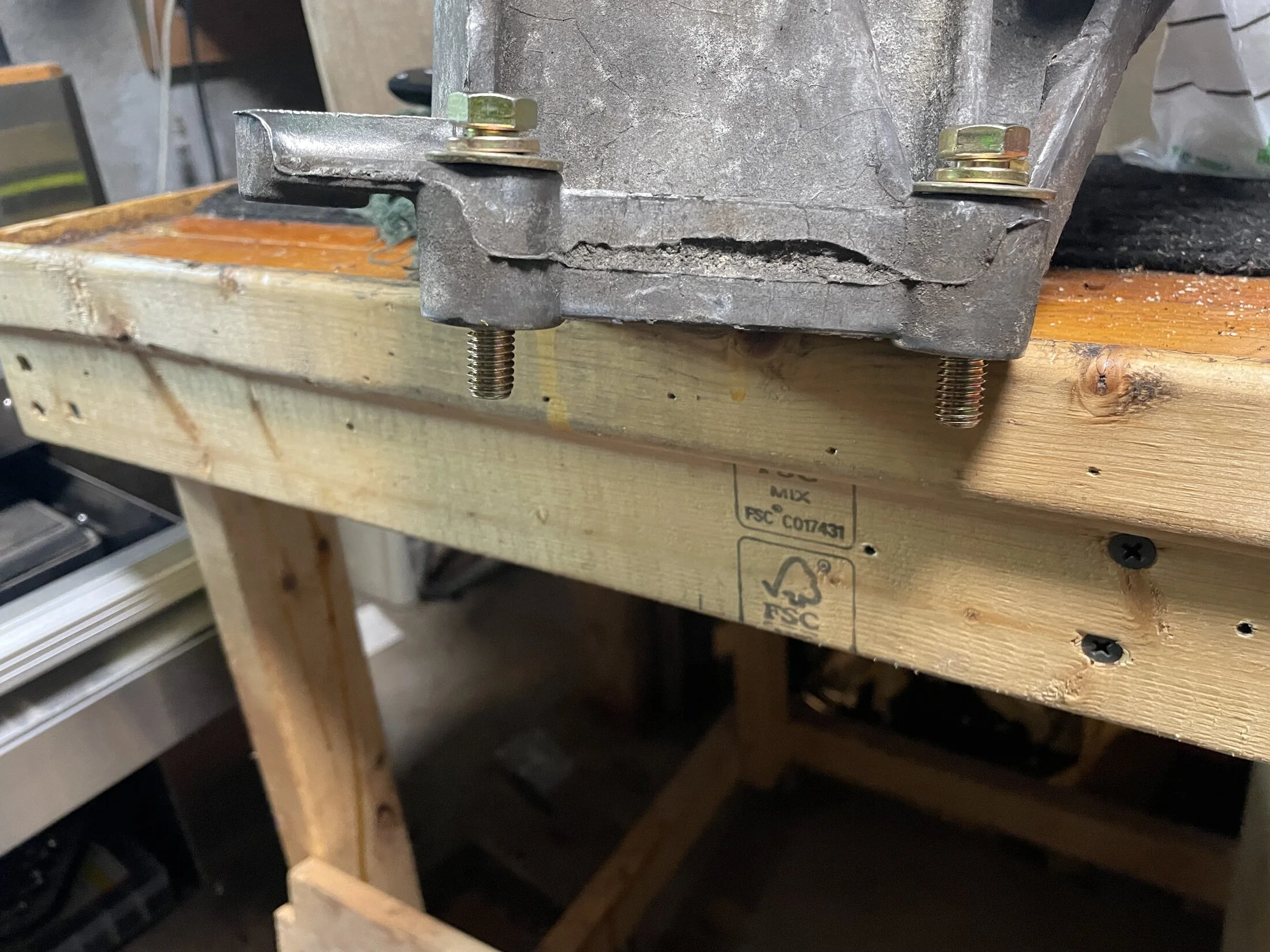

Aight - what do we like?
JAA
5 Year Member
Oct 2, 2018
674
110
63
Central MA
Sep 16, 2023
#911
  • Sep 16, 2023
  • #911

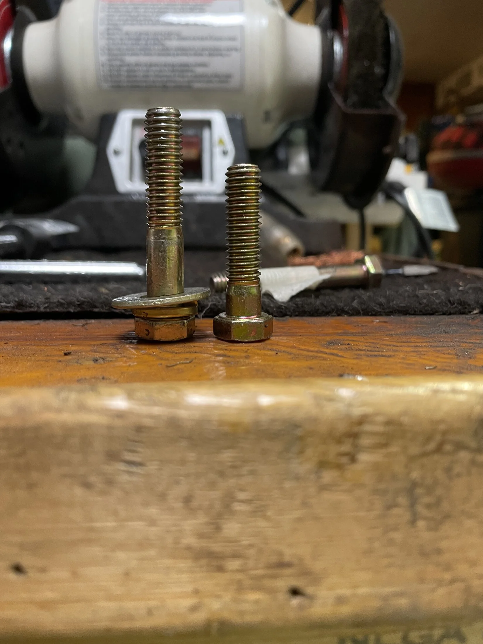

Depth
JAA
5 Year Member
Oct 2, 2018
674
110
63
Central MA
Sep 16, 2023
#912
  • Sep 16, 2023
  • #912
Looks like 2” with both washers
M
Monkeybutt2000
Mustang Master
Aug 11, 2019
1,387
851
133
Lafayette,IN
Sep 16, 2023
#913
  • Sep 16, 2023
  • #913
Those lock washers are not needed.
Reactions: JAA and limp

I do not run them on mine either and have not had one back out but up to you as it’s your car.
Im going to check length and go with whatever allows the longest amount of thread threaded.
Reactions: limp
JAA
5 Year Member
Oct 2, 2018
674
110
63
Central MA
Sep 19, 2023
#916
  • Sep 19, 2023
  • #916
Those 2” don’t bottom out without the lock washers. Feels like a better option than the 1.5 inch.

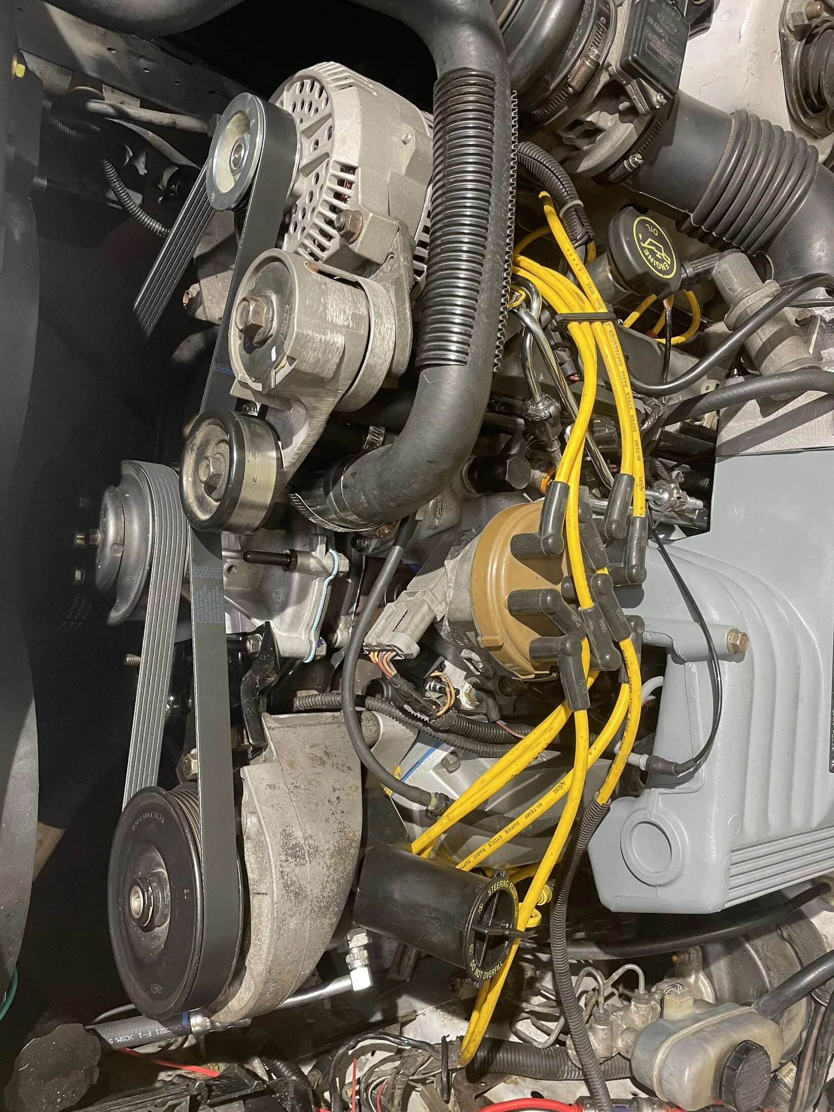

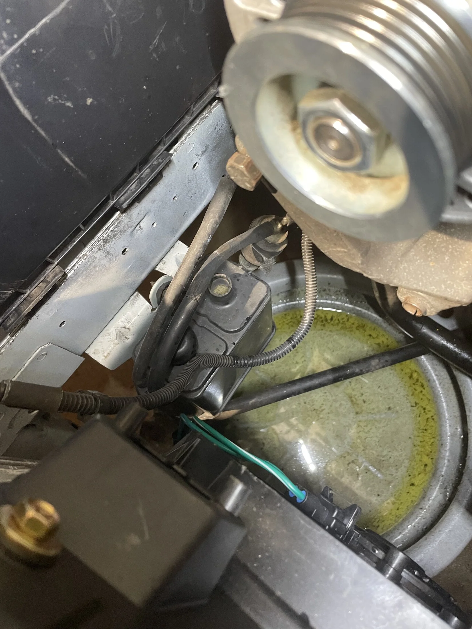

Reconnected everything.
Put blue thread lock on the generator/alternator bracket bolts. Also tightened to 21lbs
Putting radiator fluid in and will bleed the system.
Started right up. Smoke from my guess if PS fluid on the exhaust headers.
Other than that sounded great. It’s a little late so I didn’t want to leave it running to bleed the system. Will do that tomorrow.
Anything I’m missing?
Glad to see it back together!
I’m not sure if it was answered, but yes, turning the wheels with the motor off can build up pressure in the pump and cause leaks out the cap. At least that was my experience when I made the same mistake. I Got it cleaned up, and all has been fine since, with no ill effects!
Reactions: JAA
