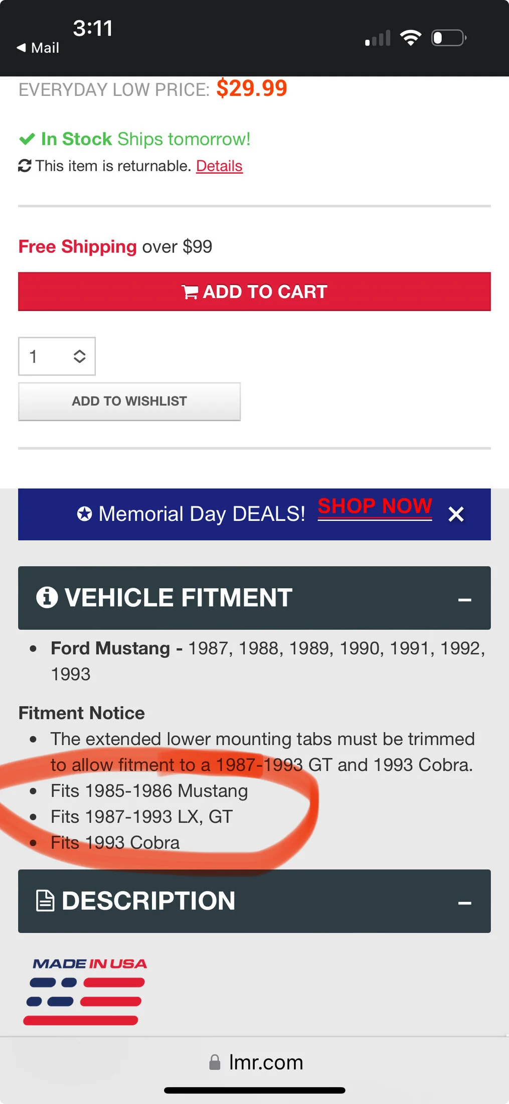

Getting ready to register Snow in Mass. Mass will require a front license plate. What do folks recommend for this? Here is my front:
https://stangnet.com/mustang-forums/attachments/4-jpg.614412/
https://lmr.com/item/LRS-17385A/1987-93-Mustang-Lx-Front-License-Plate-Bracket-For-Also-Fits-All-85-86?utm_source=google&utm_medium=cpc&adpos=&scid=scplp&sc_intid=&gad_source=1&gclid=EAIaIQobChMIwf-s87auhgMV3E7_AR2XGQDOEAQYAyABEgKRFPD_BwE

That's a bracket for an LX... it's not designed for the GT bumper.
Says it fits but you have to trim the tabs.
Gotcha. Didn't notice that. I stand corrected.

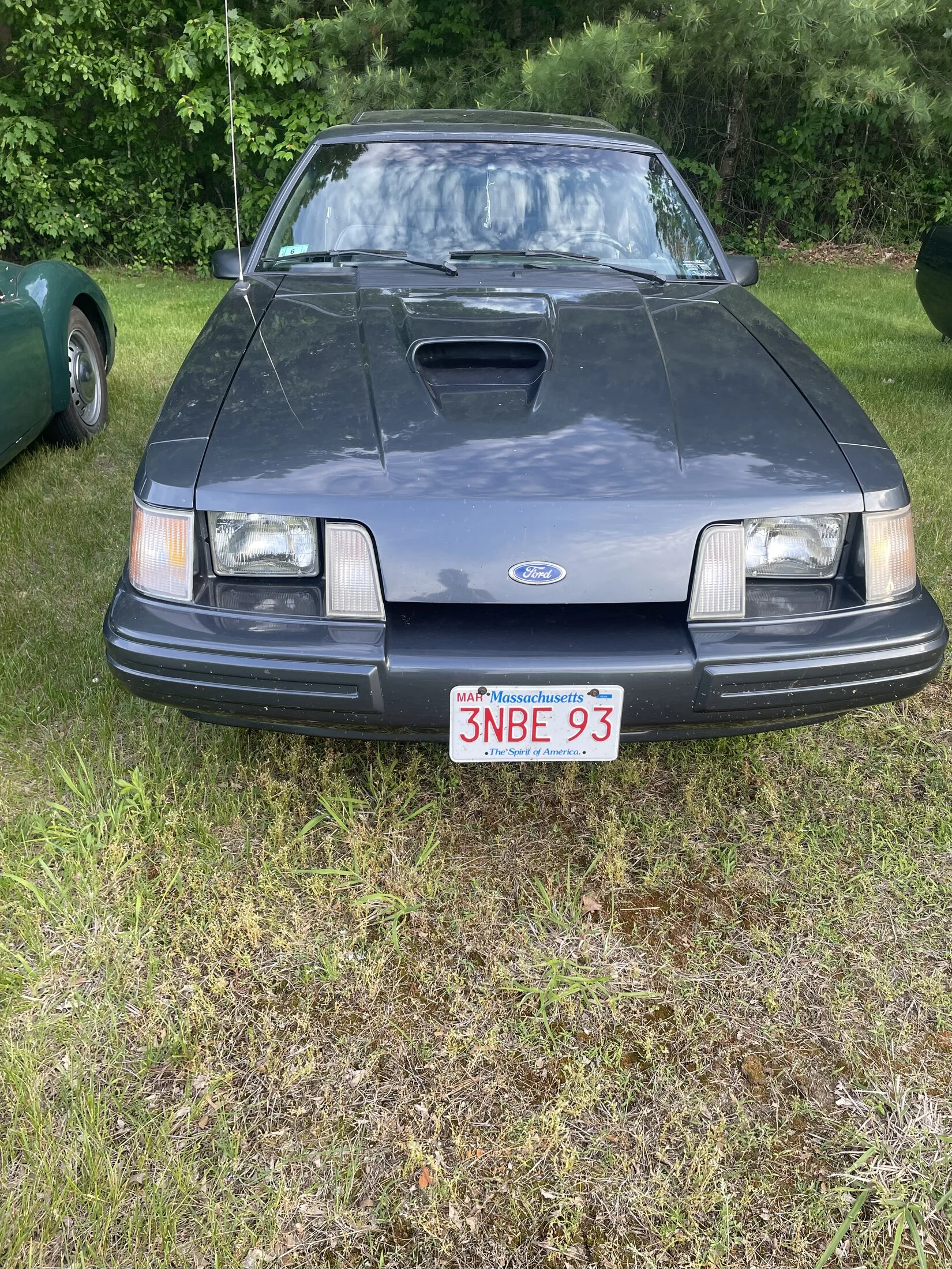

How about a little trivia, saw this Foxbody at the car show. Never seen this style before. Who can explain it?

I think some of the export countries had different light regulations than we did at the time

SVO turbo 4 cylinder

Believe the 1984 and early -1985 had the headlights set back like that. The late 1985 and 1986 cars had the flush headlights.

That was when Ford was in the midst of converting from sealed beam lights to “aero” style lights. All lights need to be approved by whatever regulating body does that. The new 1984 SVO was intended to have flush mount lights but they weren’t approved yet, so ford had to cobble up the old sealed beam style light until mid 1985 when they were finally approved and installed.
At least that’s the story I heard….
Approved by OUR Government...... Went through the same thing with " European" headlights on Porsche's
