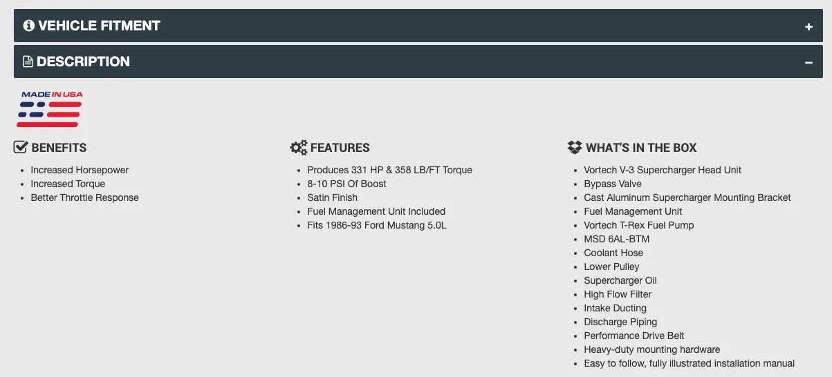

That puts me here 1986-93 MUSTANG VORTECH V-3 SI NON-INTERCOOLED H.O. COMPLETE SUPERCHARGER SYSTEM - SATIN
Should add 331 HP & 358 LB/FT Torque putting me 550 crank, so maybe 450ish at the wheels? LMR/Summit price tag of $5,346.99

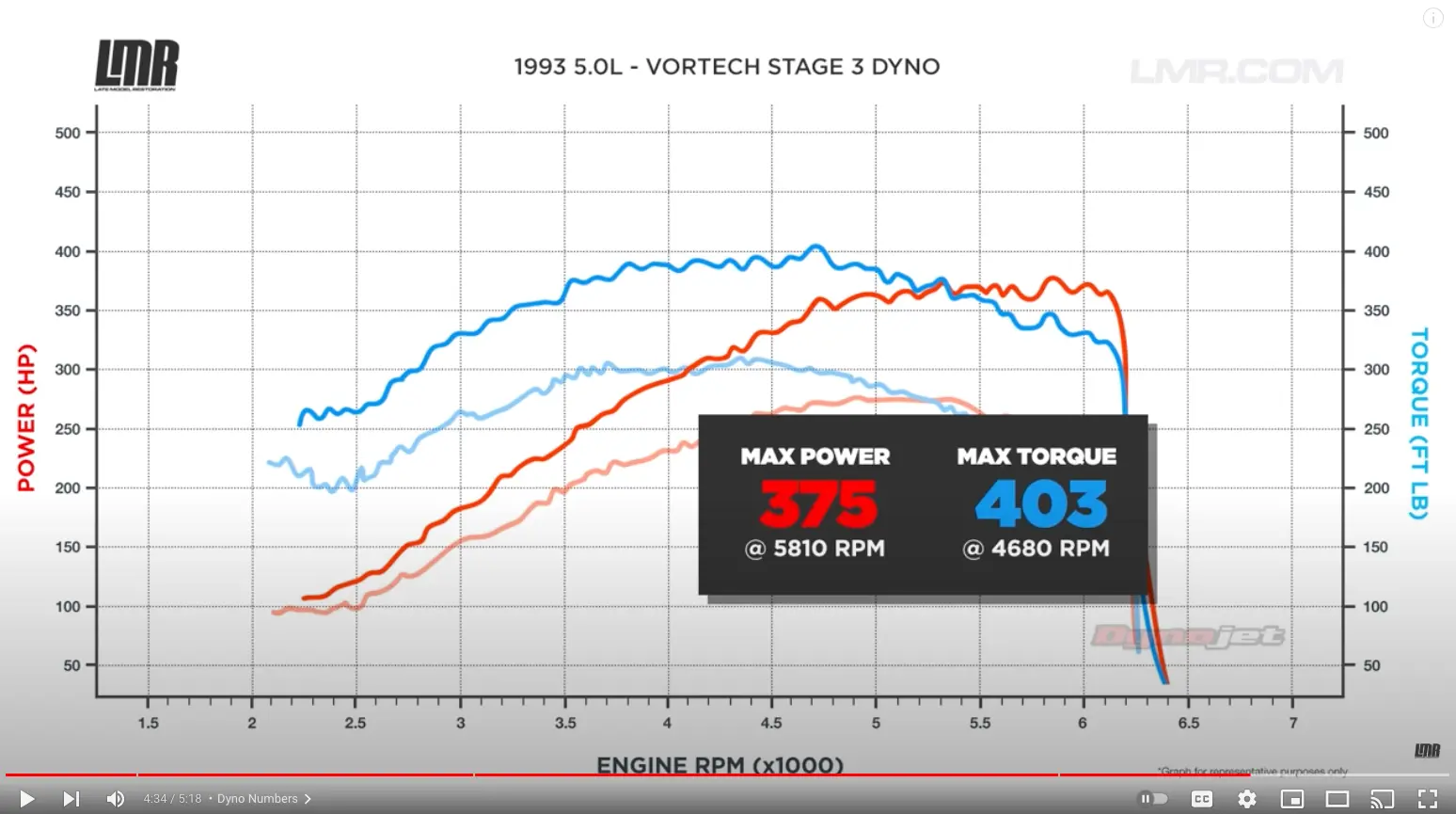

Watched the install vide, these were the final numbers:
I thought those numbers were final total power numbers, NOT how much it adds. Or am I way off base?
So maybe I got it wrong, here is the screen shot

@85GTStangGuy I think you're right, if installed on a stock car.
