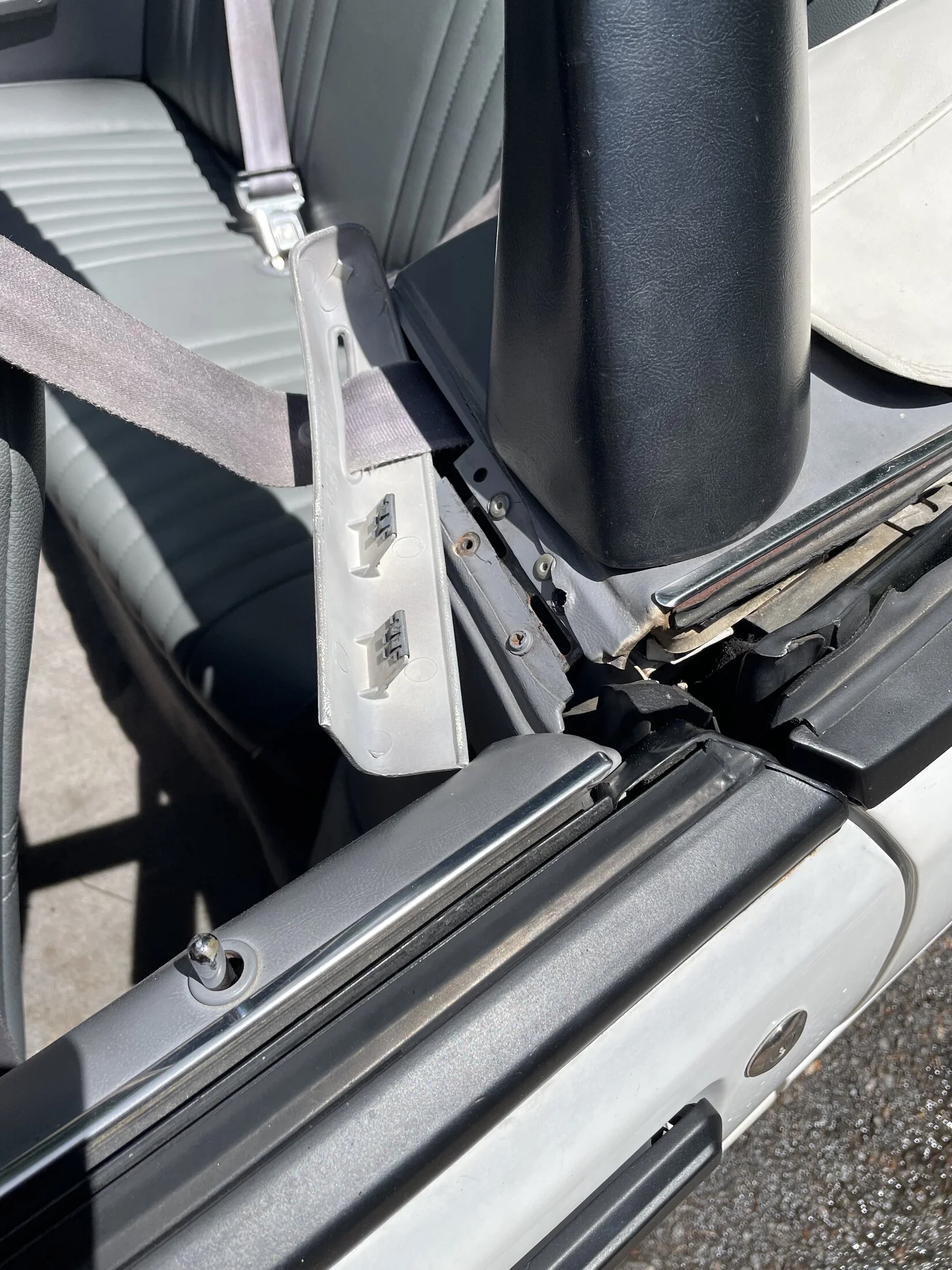

JAA said:
Anyone have tips/tricks for getting this broken piece to stay in place?
Did you ever solve this issue? If so, what'd you end up doing?
limp
5 Year Member
Oct 4, 2020
5,501
2,922
173
Florida
Jun 11, 2024
#987
  • Jun 11, 2024
  • #987
What about some thin Velcro?
Reactions: JAA
Not yet, some advice above that I will be trying.
