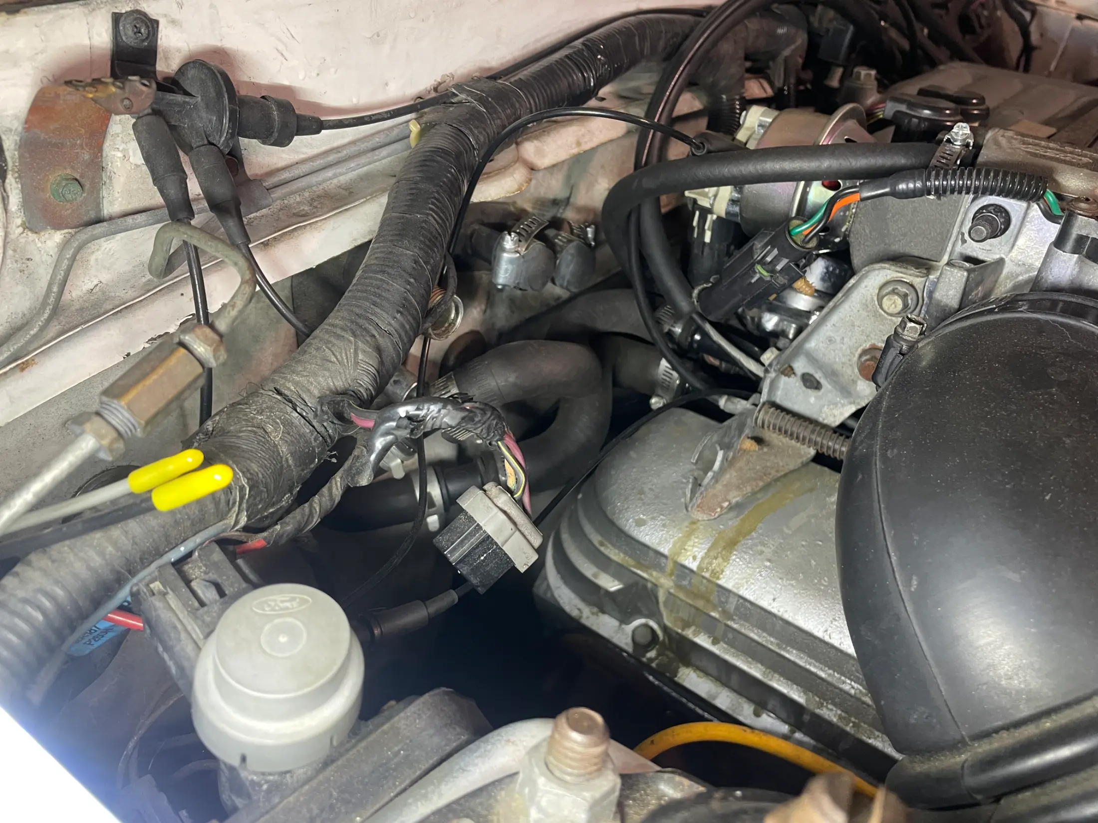

Some cleanup here, but is there a part number or DIY approach to solve my heater tube bypass monstrosity here? I see maybe one part online and they want $24 for it. Any easier options out there?

I'm not real sure what you've got going on with your heater tube? Are you bypassing the heater core? If so there's a hose you can use that works perfectly.
Yea - that was me 1000% being lazy with what I had. It will be fixed as its a huge eye sore.

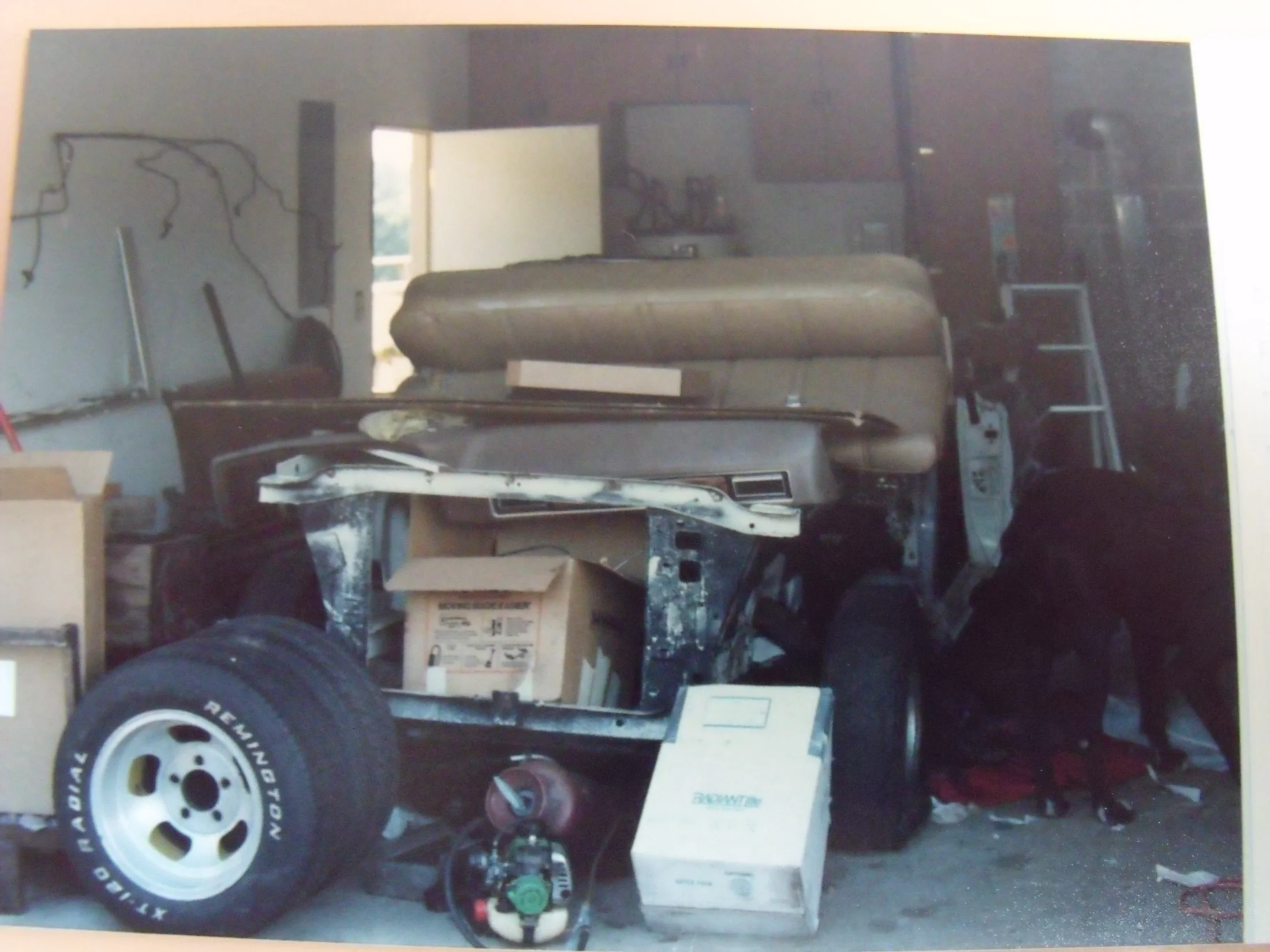

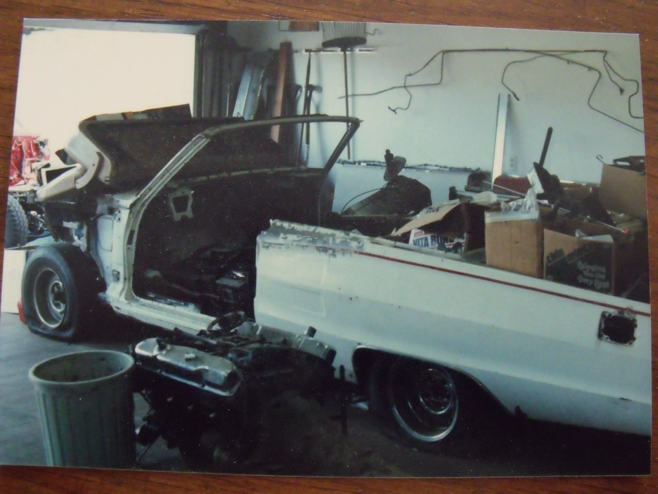

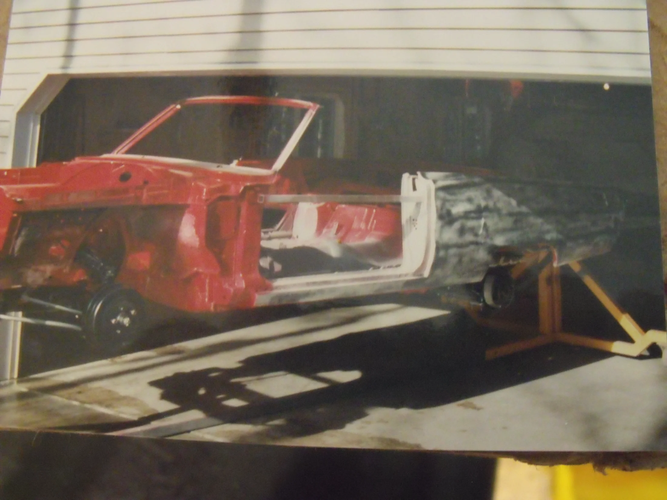

It happens.. I pulled my Dodge out of a field, did a rotisserie resto on it and owned it for 31 years before selling it... It was needing a mini resto and I just did not want to spend the time or money on it... I have a couple of new projects I wanted to do and at 71 years old in April, it was literally " do or die time" ... LOL
Funny, your hot start issue was the ONLY problem I had with my Dodge after completely taking it apart and putting it back together.... Mine was more of a NO crank problem intermittingly.. Turned out to be a loose bat cable on a relay....
