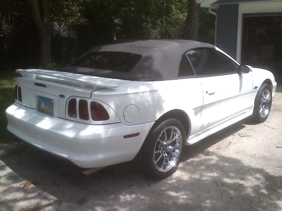

Is anyone using a Snow kit methanol kit on their 4.6? I'm thinking of trying it on my GT.
