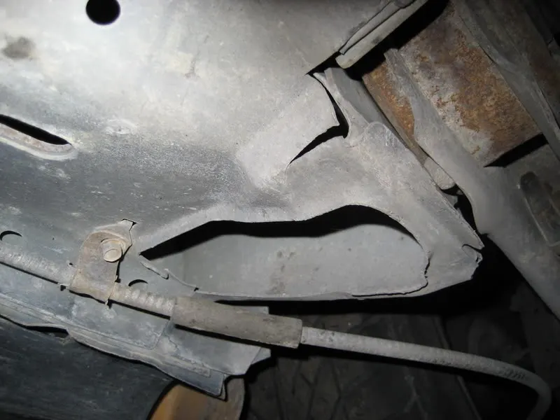

So I crawled uner my car the other day and this is what I saw...

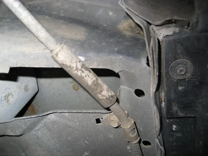

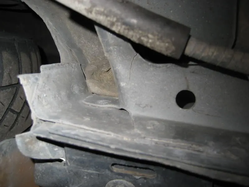

The first nasty looking one is on the passenger side, and the other two smaller cracks are on the drivers side.
I am installing the reinforcments before I get her back out for the summer, but anything I can or should do to fix this?
Yeah, you can take it to anyone who can weld and have them weld it up... it'll be almost as good as new :D One of mine looked like that, now its all welded and holding up fine.
Yeah, I was planning on that, but I didn't know if there were any tips/tricks or anything specific to do. My dad's a pipe fitter for Ford and welds for a living and he's dang good at it too, so I'll get that done no problem.
drilling a hole will do nothing unless you tell him to de-burr the hole and weld the damage.
if you drill a hole at the end of a crack, it will keep the crack from becoming longer. im not saying dont get it fixed because you DEFINATELY should get that taken care of ASAP. i remember this happening to someone and this is what they did :shrug:
