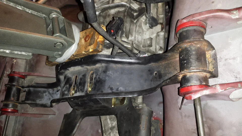

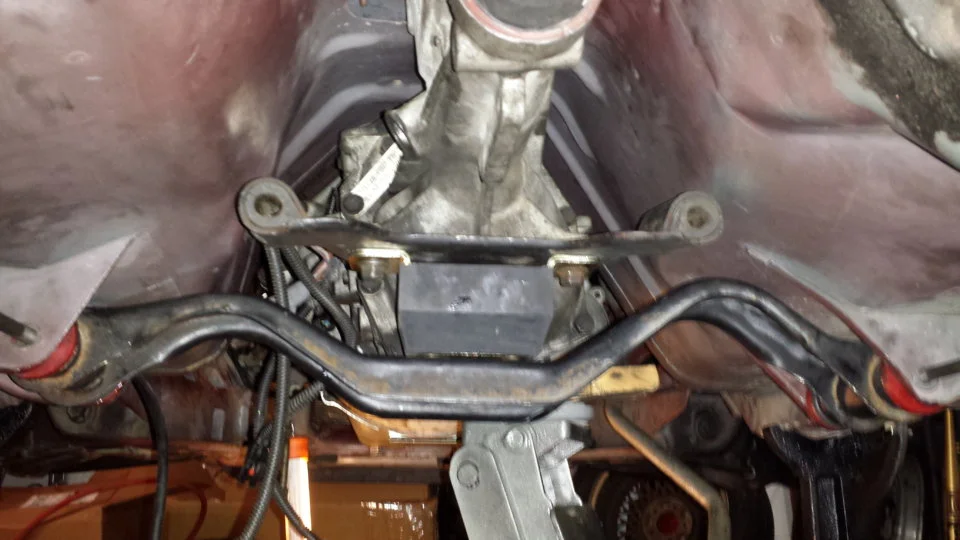

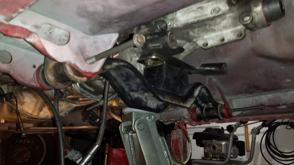

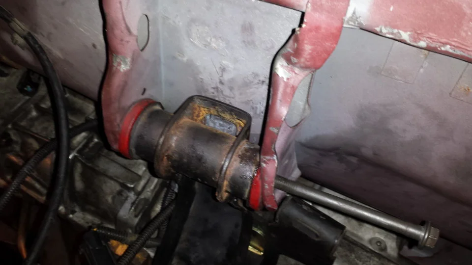

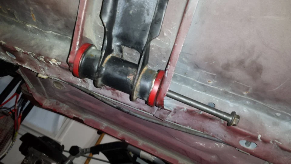

ok....this thing just won't go in. I did have it in there the wrong way, so I flipped it the correct way and everything seemed to line up. Started putting it all together and I could NOT get the last hole on the cross member to line up with the frame. I took it all back apart, jacked the transmission up and out of the way (that eliminates the trans mount and engine mount from being the issue) and just have the cross member trying to line up. And it WON'T.
I have been out there for hours with a hammer and a jack and pry bars etc.... and it just won't go. Here are some pictures of where everything is at at the moment..... does anyone have any tips or tricks on how to get this crap to align? Would buying a aftermarket cross member fit any better?

looks like the trans bushing is too thick? I would remove it, out the crossmember back in with the bolts and then see if you can slide the trans mount bushing back in, If not, mark how much needs to be trimmed and then cut that out and then slide it in and bolt it up.
Well, right now I have the trans pushed up with a jack so that the trans mount isn't even touching the cross member. Figured I would do that to eliminate the trans mount from effecting anything...even with that the cross member just won't fit...
Ive had it before where ive had to spread the tabs on the chassis (just used a 2lb sledge) and then still have to hammer the bolts thru. That was with a brand new frpp crossmember, the old rubber gets so rotted that when you tighten the bolts it draws the tabs together.
Alright, finally got it in.... after resting for a bit and eating some apple pie, I went back out there with a purpose. Basically that means I grabbed the hammer and banged hard while moving the pry bar around. Eventually they all seated WITHOUT breaking the threads on the bolts. I have had to replace a few different bolts/nuts because I banged on them already on this project and I didn't want to do it again, but desperate times call for desperate measures. So anyways, everything is in there and torqued to the proper specs.... I appreciate everyone's help.
