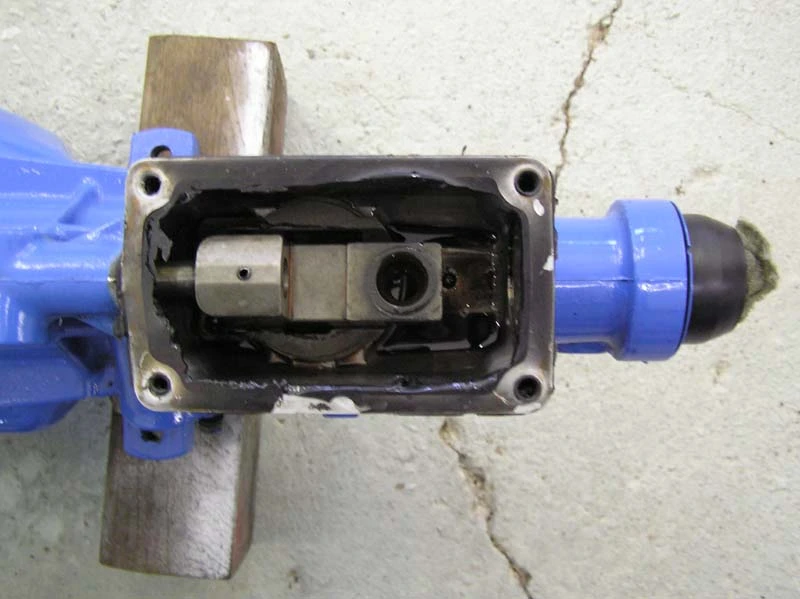

Here's a pic:
It's actually the only one I can find...
- Jeff

jzgt said:
Here's a pic:
- Jeff
funny.. my seal (old one) doesnt look like that one.. mine is almost flush with the end of the tailshaft... im glad i saw that before i bought a new one for comparison
I've seen those seals before... Even used one before. It's not a big deal, they seem to work just as well. Not sure what tranny/car year(s) they came on originally. I got mine at NAPA maybe 5 or 6 years ago. It happened to be one of like 4 cross referenced numbers for the T5 and was also the only one he had in stock. I've not seen one since then. Maybe they come off of GM T5s?:shrug:
I dunno... mine was out of a 1991 LX 302 / t-5 but i dont know if it was ever changed before me. i doubt it, i bought the car in 1994 and have owned it ever since
