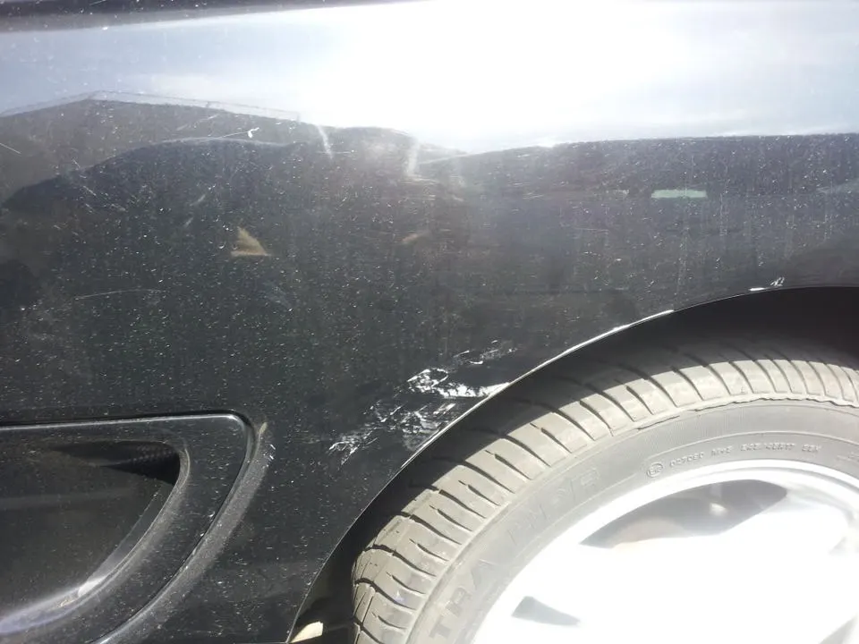

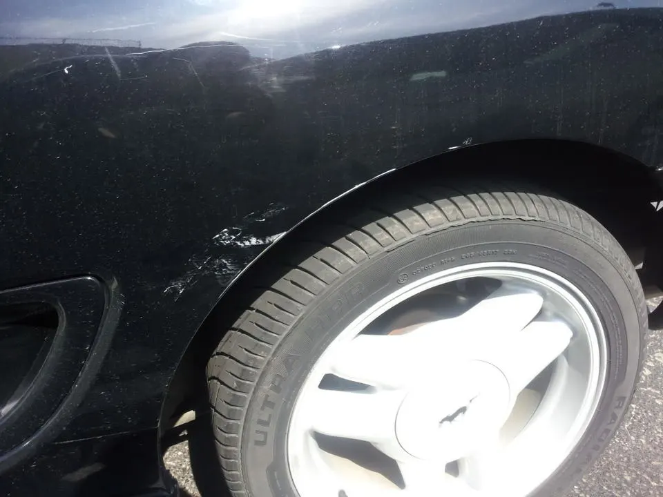

When I left work this afternoon I noticed this on my car :
It could have happened while it was parked at my house (I live in a condo so we have a shared parking lot) or at work. I just know it had to of happened in the last couple of days. I will run through our security cameras at work. Looks like a new paintjob is not that far off after all...

How did some a-hole put the reflection of a guy with a camera in your paint? I smell insurance scam.

it doesn't look dented so it should buff out.

Is there something that I could buy to try and remove some of that white paint? And no it doesn't look like there is any dent there. Thank you.

I'd start with a mild abrasive. There are usually 3 levels of abrasives and usually
Stage 1: buffing compound
Stage 2: machine polish
Stage 3: hand polish/glaze
Although stage 3 sounds like it is meant to be used like wax and won't do much it's a misconception. Start light and work your way up. If you have a buffer use it with the appropriate pads, if not get your hands ready for a workout.
When done buffing it off, I would put a fresh wax on her.
