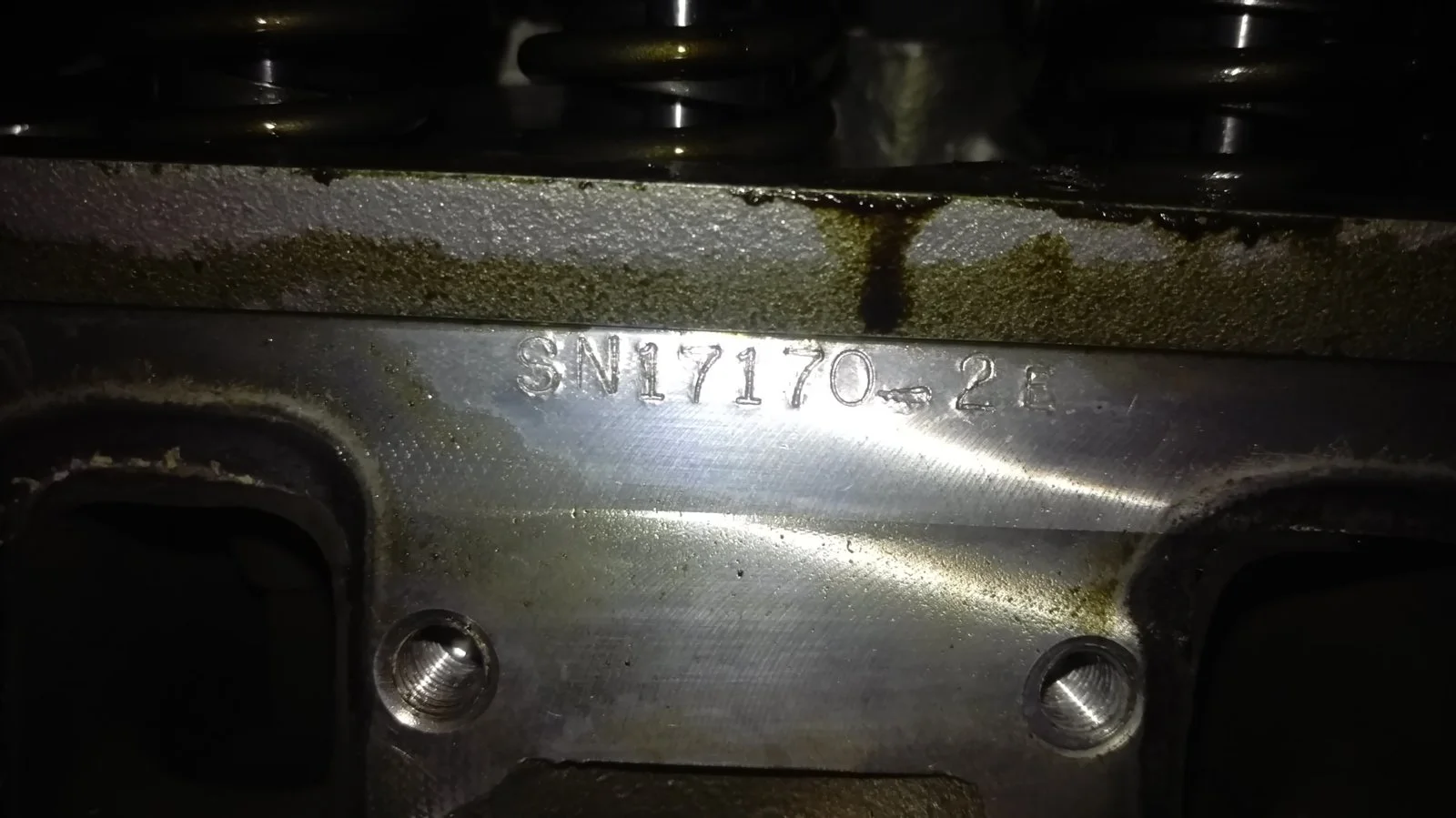

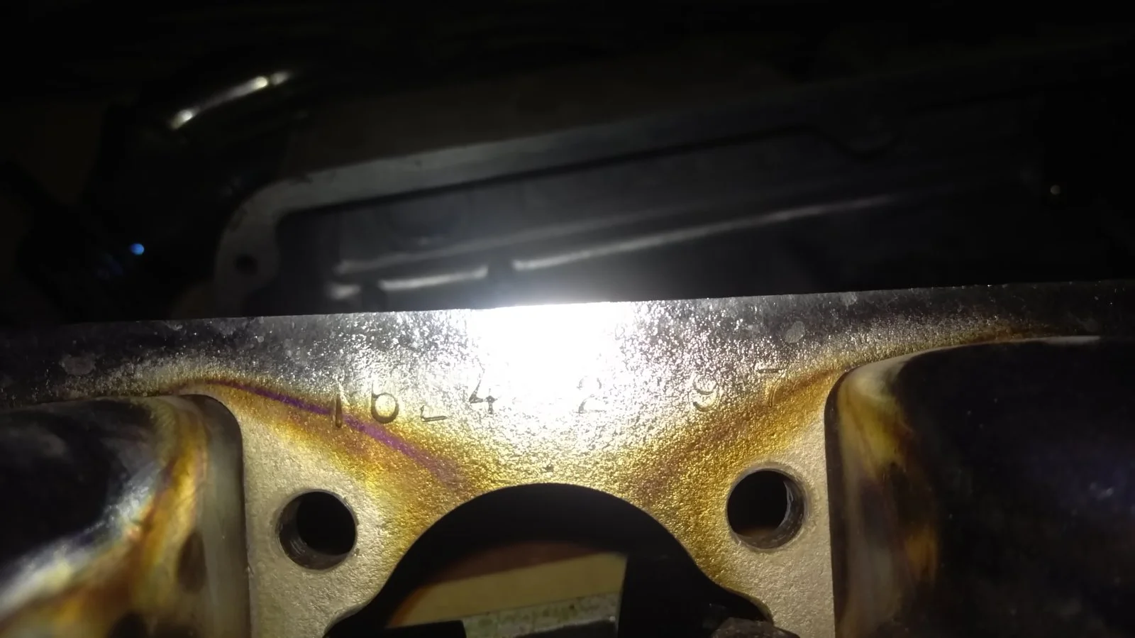

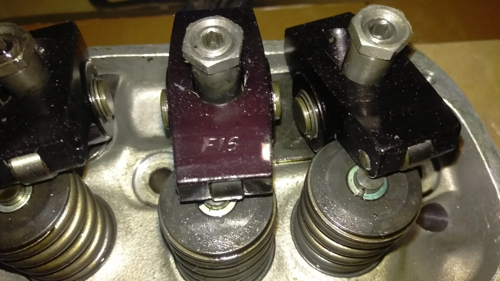

I recently acquired a set of Trick Flow TW heads and other parts from a friend who had them on his '82 Capri back in the late 90's. They have aluminum stud mount roller rocker arms that I can't seem to identify. They are black, and the only marking on them is F16. I also think the heads are 170cc, is that the intake size? They have had a minor port job done on the intake. The heads also have pushrod guide plates.

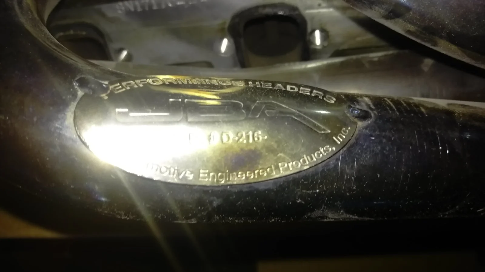

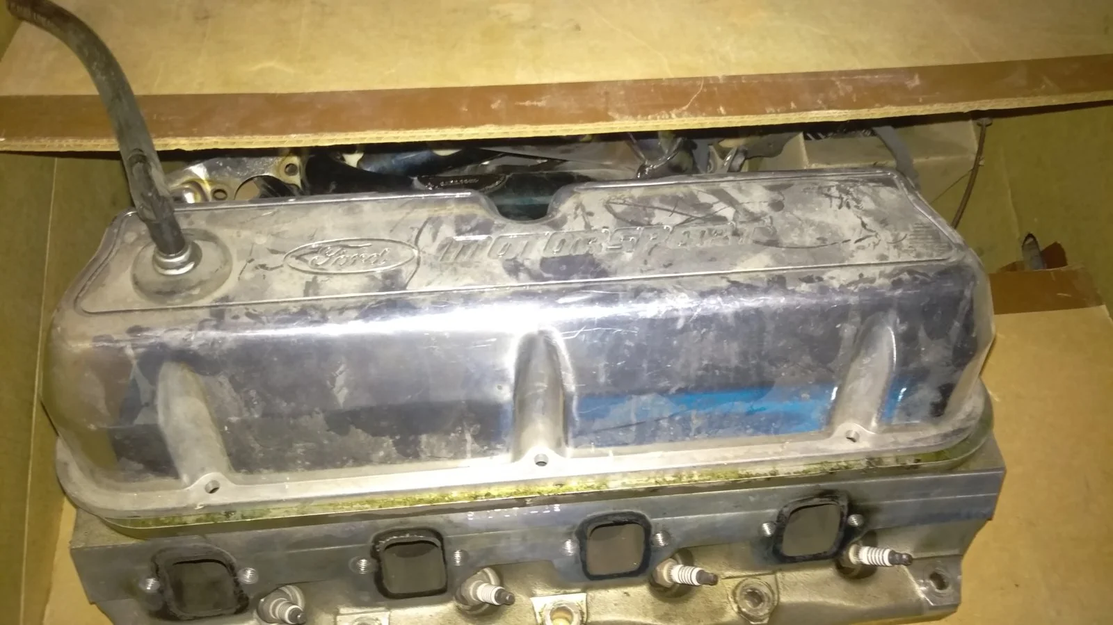

Other parts I got are a set of JBA shorty chrome headers, Ford Motorsport valve covers, and ARP bolts.

1. What brand are the rockers?
2. Are JBA headers any good?
3. Can I use the valve covers? And if so, will I need an intake spacer and will it fit under a stock hood? (Explorer GT40 intake with internal EGR)

6. What cc are the combustion chambers?
Here are some pictures I took of the parts and any numbers I found.
If you want or need any more pictures I can get them, just let me know what you want to see.

JBA makes some of the best headers you can get. Definitely use them. You could make the valve covers work, but I wouldn't. They are carb covers and are never going to be "right" on a EFI motor. You can also reuse the head bolts.
No clue on the rockers or combustion chamber size. I guess you could cc them if you have the stuff.

Is there any difference with these heads from the 90's and today's TW fast as cast heads? Does anyone have any idea who made the rocker arms?
