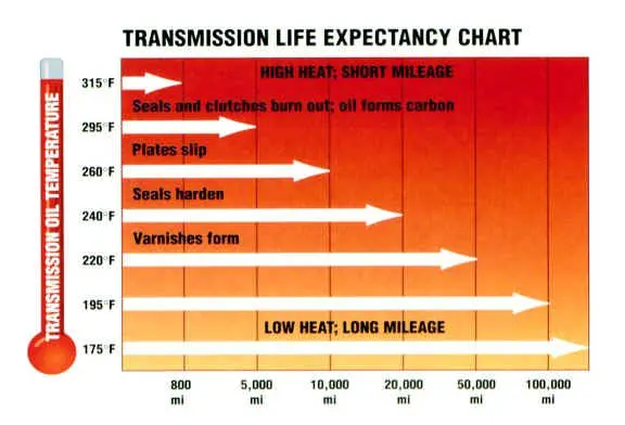

Why are you putting you Trans Temp sender in the trans pan? To get a meaningful Trans Temp, you want the sender in the trans line that goes from the Trans to the Trans cooler, not the return line though.
That'd be reading the hottest fluid that's being sent to be cooled. I want to read the temp of the fluid that's being sucked up and sent to the valvebody and pumped into the TC. Otherwise you're not getting that good of an idea of how well it's being cooled, just reading how much abuse you're giving it.
I've seen it done both ways. Many argue the pan is more accurate because you're reading the temp of the new cool fluid being mixed in with the pan fluid which is what your trans actually uses. Some even move where they had it before to the pan due to inaccurate readings:
http://www.explorerforum.com/forums/showthread.php?t=176798&highlight=transmission+temp+gauge
Also show properly here: http://neptune.spacebears.com/cars/stories/trgauge.html
Most do a T-fitting so they dont have to weld.

Nope - that's it. Just trans temp and A/F - no need for more unless the car had boost. I'll take a video of it at day and night and post it up Laser:nice: Install is going on as we speak - quite the bitch it appears.
Install's all done. Very nice results - i like the set-up a lot. Got a vid of it during the day - will combine it with it at night to give people an idea. Trans gets about at 192 in fairly spirited driving including occasional downshifts, so far. About 170-180 cruising on the freeway.
