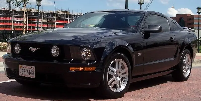

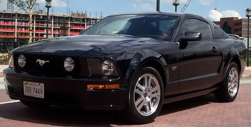

Just wanting to put some pic's up. This is the first time that I have used Zaino and I'm pretty pleased with the results. Just got my complete kit in yesterday. I was able to get one coat on today and will put two coats on tomorrow.
Anyone have any good suggestions on washing with hard water. :notnice: :notnice:
NICE...... I love Zaino... Didn't think I would ever become a convert...but...After one use, I was sold. :hail2: It only gets better with more applications. :nice:
As for the hard water..that is a tought one...Dry REALLY, REALLY quick. :D
The GT looks Great! :cheers:

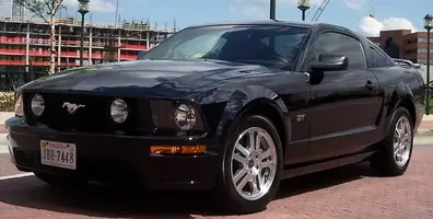

Here is mine with 3 coats of Z2 Pro and Gloss wipe down
nbk13nw,
That looks awsome! This is my first black besides a 69, which was like 20 years ago. Nothing like the newer technologies of auto paints. I just got it tinted yesterday and it really makes the car look good.
