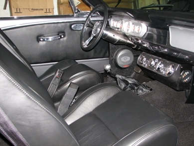

Is that a FR column?

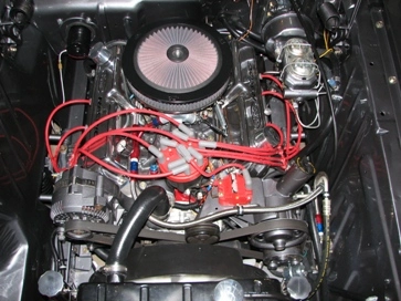

Where is your AC compressor?
What brackets did yo use to configure your Alt & PS like that?
edit: More Questions...
Is that a JME gage unit?
Do you have electric windows? where 'ja put the switches?

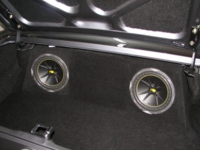

Where are your tunes...glovebox?
Again... Nice

it is a FR column.
Ac compressor is under the ps pump, engine and serpentine setup if of a '95.
not the JME unit, it is an abs unit available from Laurel Mountain Mustang.
all windows are power front window switches are in the doors and locks and rear window switches are in the ashtray.
Yes radio in the glove.

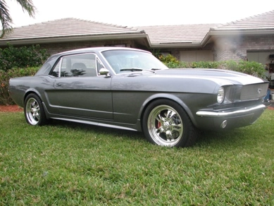

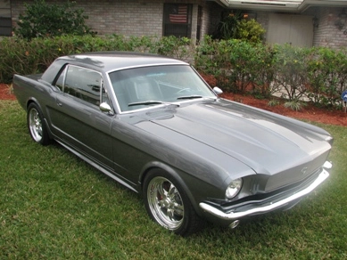

0to100to0 said:
that is neato.....
what kind of ground effects are those?
are those windows tinted? were they originally green?
matt
The ground effects are from a current model altima
No the windows are not tinted, the windshield is new the rest are orig. actualy rear was replaced more than twenty years ago.

Posted by stang65':
I thought I remember reading somwhere the 94-95 Mustang front accessories were set back further (closer to engine) and wouldn't clear the shock tower on the 65-66 models.
Yours is the first I've seen like that. Did you have to do anything special? (different motor mounts...?)
Here it is! from the Ron Morris web site:
94-95 MUSTANG 5.0 ENGINES
This is a good engine, computer and wiring system for an EFI conversion. It uses a 2 speed electric cooling fan, an electronically controlled automatic transmission (AODE) and has data link capabilities.
If you are installing this engine into an early Mustang, the timing cover does not have a place to drill for relocating the oil dipstick tube. The timing cover that comes on the 94-95 Mustangs is shorter than 93 an earlier timing covers and has it own water pump and accessory brackets. If you decide to change the timing cover you will also have to get different accessories and brackets. If you plan to run air conditioning, you will have clearance problems using the stock 94-95 brackets and a/c compressor. The compressor will interfere with the shock tower.
:shrug:
Nice job...the car looks great (interior, exterior and engine). What side view mirrors are you using (shelby type)? I was staying away from these mirrors, but your car makes them look good....I guess must reconsider.
