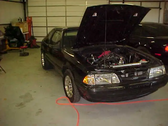

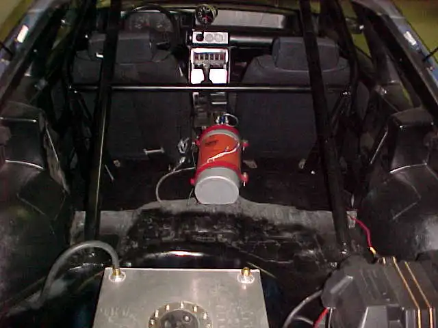

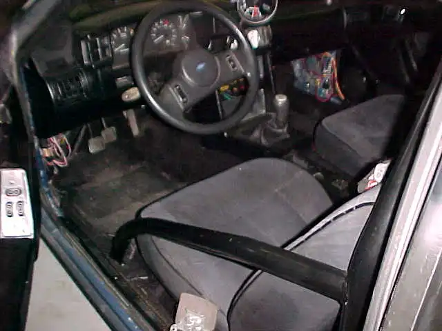

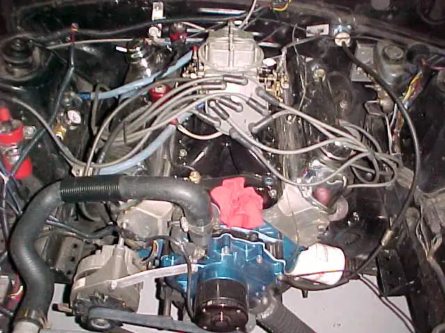

dirty as hell and b4 i put the distributor back in

looks good :nice: how much are you spraying on it?
have not sprayed any on the new setup yet . On the old setup(c9 heads with stealth intake) with a 150 shot the car went 11.18@123 and was going 12.08@112 all motor all done on 3.73s and 26inch slick. The new setup(tw heads with vic jr intake) has acheived 11.74@116 all motor and i think friday i will be spraying a 100shot (carrying the 150 jets with me) as i journey into the 10 second range. I expect the car to run a new best all motor time too thanks to the 4.10s and 28 inch et drags. A bunch of the local guys i have talked to said there is no reason it should not run 10.60s. Im mostly worried about my block though:shrug:
