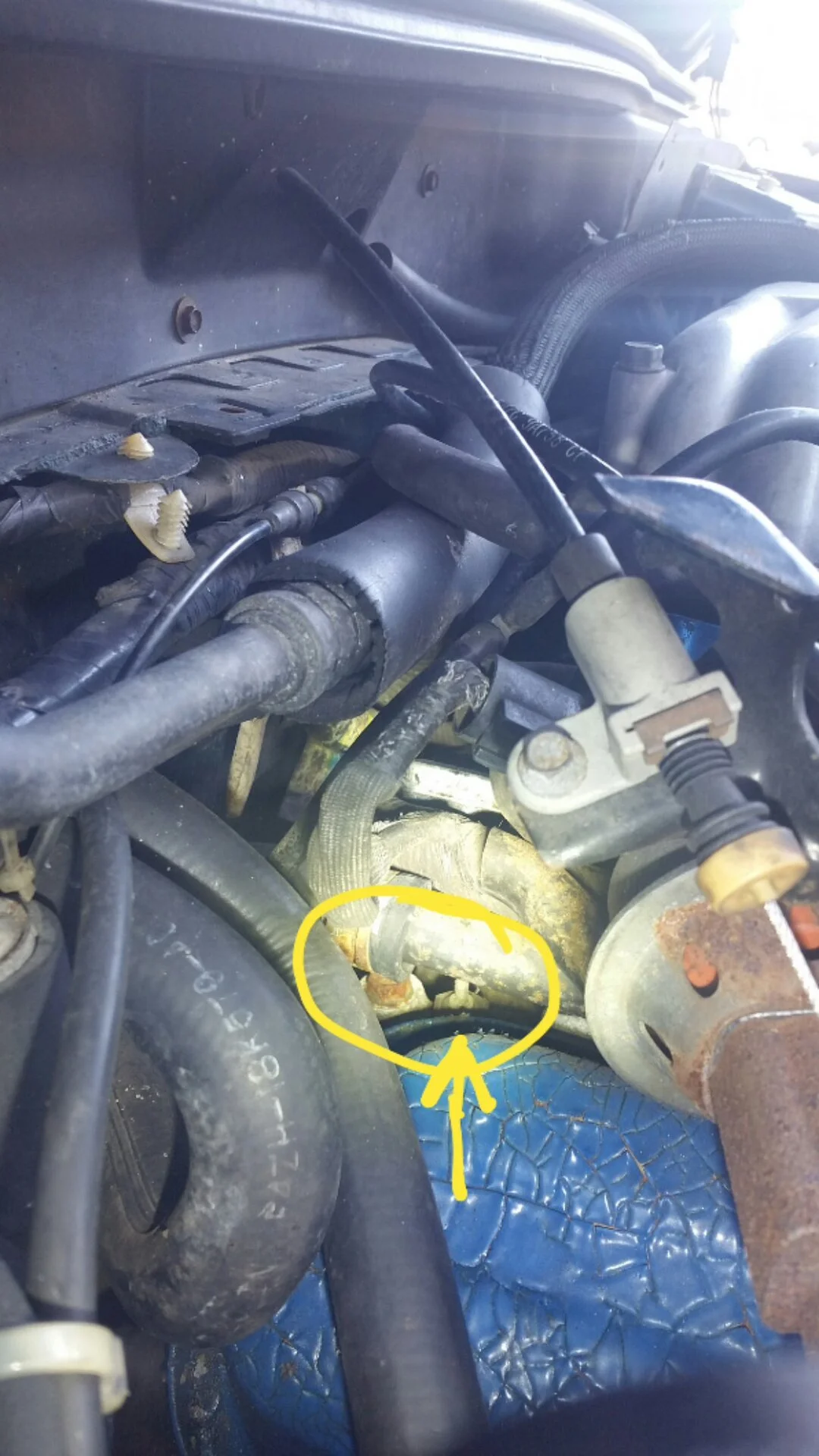

So I just took another look, I dont see any grounds to the intake or the firewall just yet.
i took a pic of the bolt that is sticking up in the back left of the lower intake, just in case.
thanks again

That stud is likely for the heater hose tube, there are two of them on the passenger side intake bolts (right side of car).
The ground strap from the back of the head is on the drivers (left side of car) side.
if the heater tube is metal, then this stud isnt for that i dont think. i saw where the metal tube brackets sit, bigger bolt, different location.

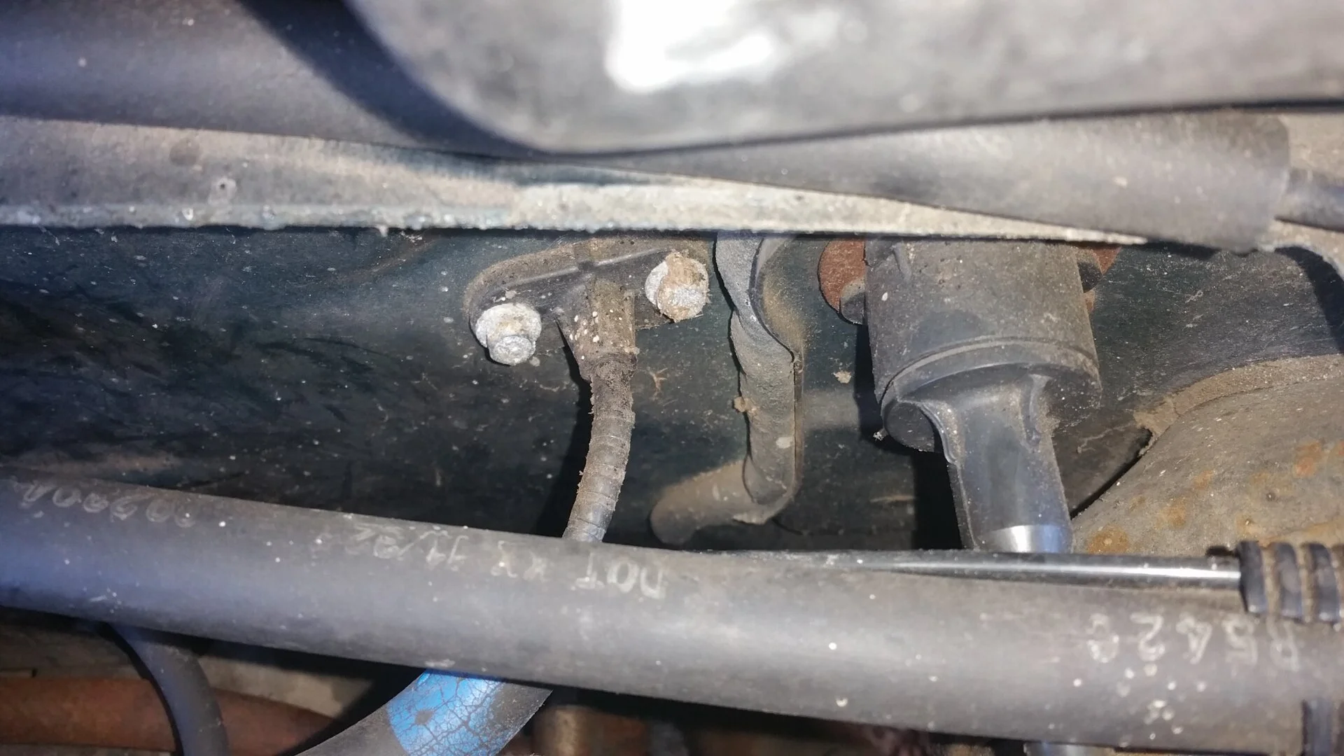

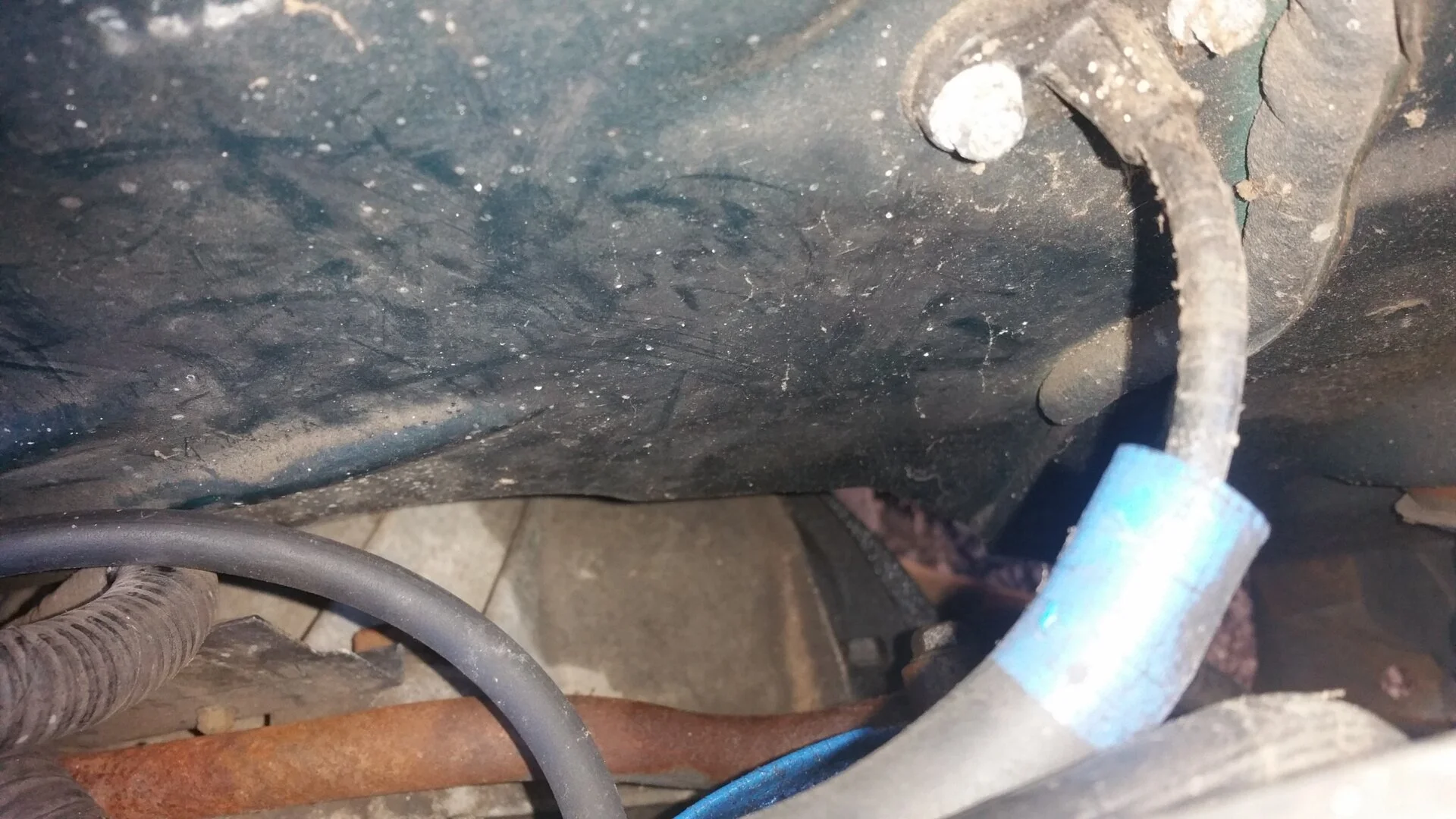

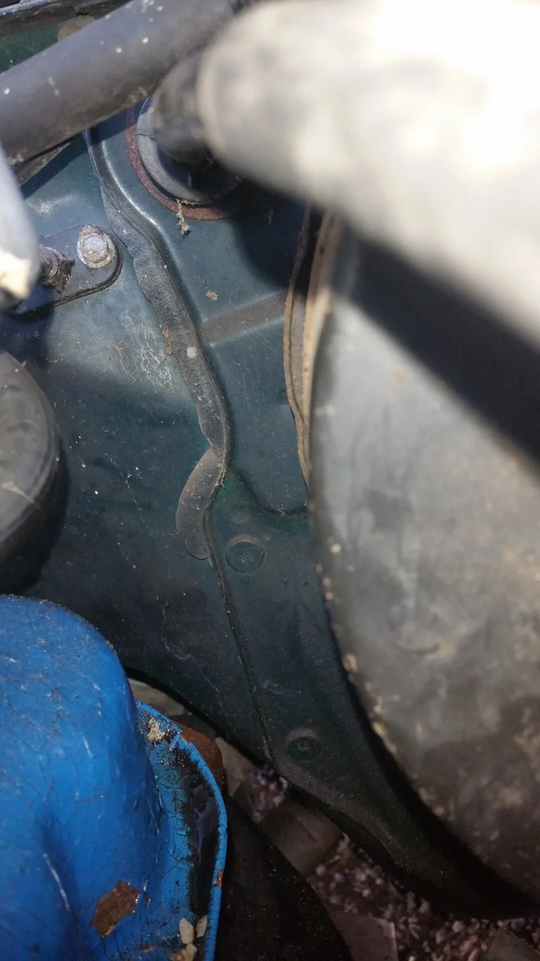

Post a pic of that area?
1st pic is to the left of the accelerator cable looking down, 2nd is straight on just below the accelerator and clutch cable, 3rd is looking down at the accelerator and clutch cables.

I searched for ground wires for the 94-5 stangs and found little to no info, everything for the 86-93 models so maybe no ground there for your car (as confirmed by the pics), I forget those two years started the use of the ccrm (constant control relay module) and that has a ground, that mess is located around the passenger inner fender panel,
Like you said you have possibly resolved you issue.
