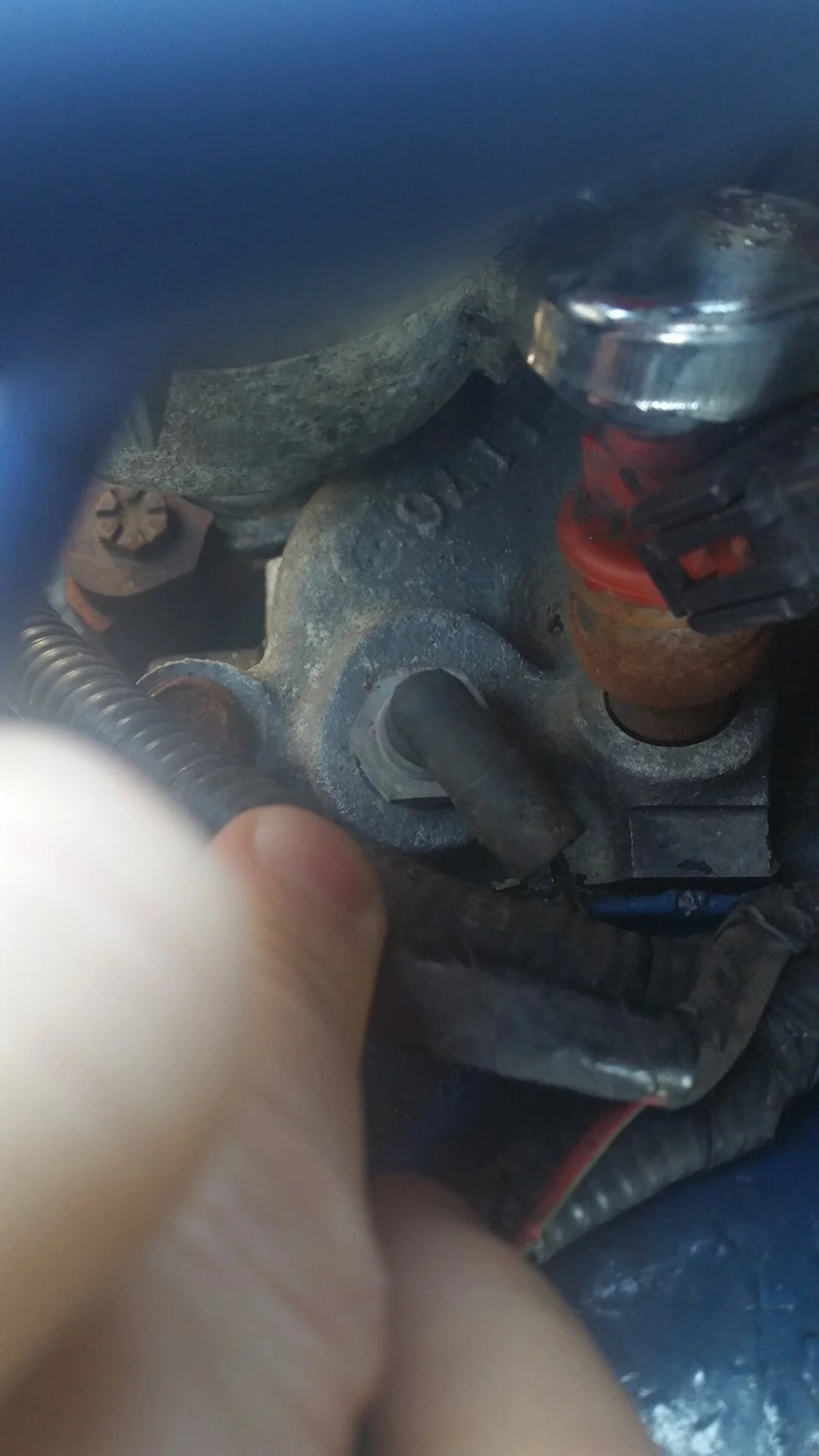

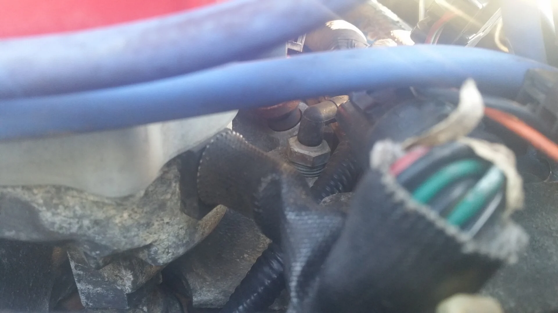

Another important ground is an orange wire that is in the injector harness and bolts to the intake or back of the head on the passenger side.
i found what appears to be a red wired (maybe red/white) that has a fitting that is connected to a threaded bolt sticking up out of the lower intake. i think this is what youre talking about? it is connected at the front right of the lower intake with a black rubber boot, kinda like a spark plug boot. i saw a similar bolt sticking up at the back left of the lower intake as well, but there is no wire on it.
i couldnt find any wire on the head to the firewall. will look harder next time i suppose.
