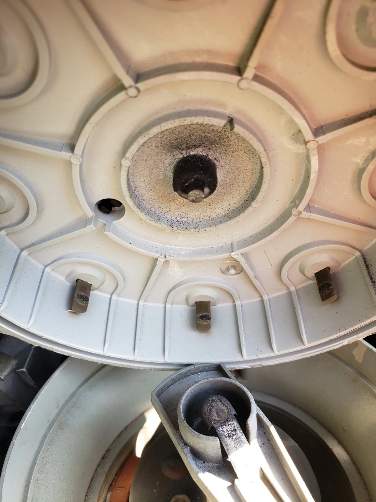

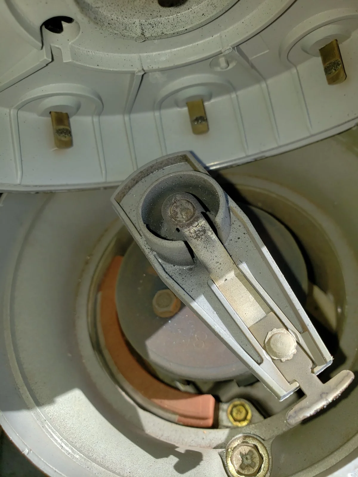

pics of the 'black :poo:' in the distributor?
if this posts twice, sorry
