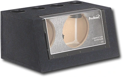

Sorry to say this, but it even says they are NOT recommeded for use as Free airs. Not to mention the issue of weight. These are heavy speakers and you would really have to support them. You can always buy a competition bandpass box by R/T. They have a clear plexiglas front for view and some even come with neon lights inside the box. If your looking for show, this is the way to go. You can just use speaker carpet and thin pannel to dress up the space around the box so it looks like it's built in. Just my .02
Here is a picture of the box I had in my Accord, I just can't fit it in my stang :(

I know what you mean by free air subs, and using the trunk as an enclosure, but thats for car shows. And people who test SPL levels with earphones on. If you have ever sat in a car with a rear seat folded down, and the subs aimed at the front of the car, you will know what the sound waves do to your ears. Its not fun. Stick with the speaker box in your trunk. Plus, if someone walks by your car and thinks your idea as good as you do, he will own it. And you will be posting on here on how to install an alarm :)
my friend had a 68 bird in highschool. he put 2 10's and 2 eights in the back deck lid. they were pioneer free airs. I was actually suprised how good they sounded. the work to intall them was more than builiding box in my opinion. You can pick up an mdf box for 2 tens for 60-100 or a sheet of it for like $20. I dont' know how you plan on monting them in your stang but there will be some work involved. they still have to have a rigid mount of somekind. no what I would recomend but it can be done and made to sound ok.
