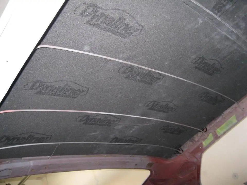

i applied dynamat extreme (the butyl stuff with foil) and 1/4" dynaliner to the roof while it was upside down on the rotisserie. I believe the original insulation was around 1/2" total but was very soft.
i tried to do a non-scientific sound comparison (tapping on the roof) in this video. click on the picture.
Hmmm, link led me to photobucket, but no video. Looks like this should have worked but didn't work for me. Anyone else get this to work?
