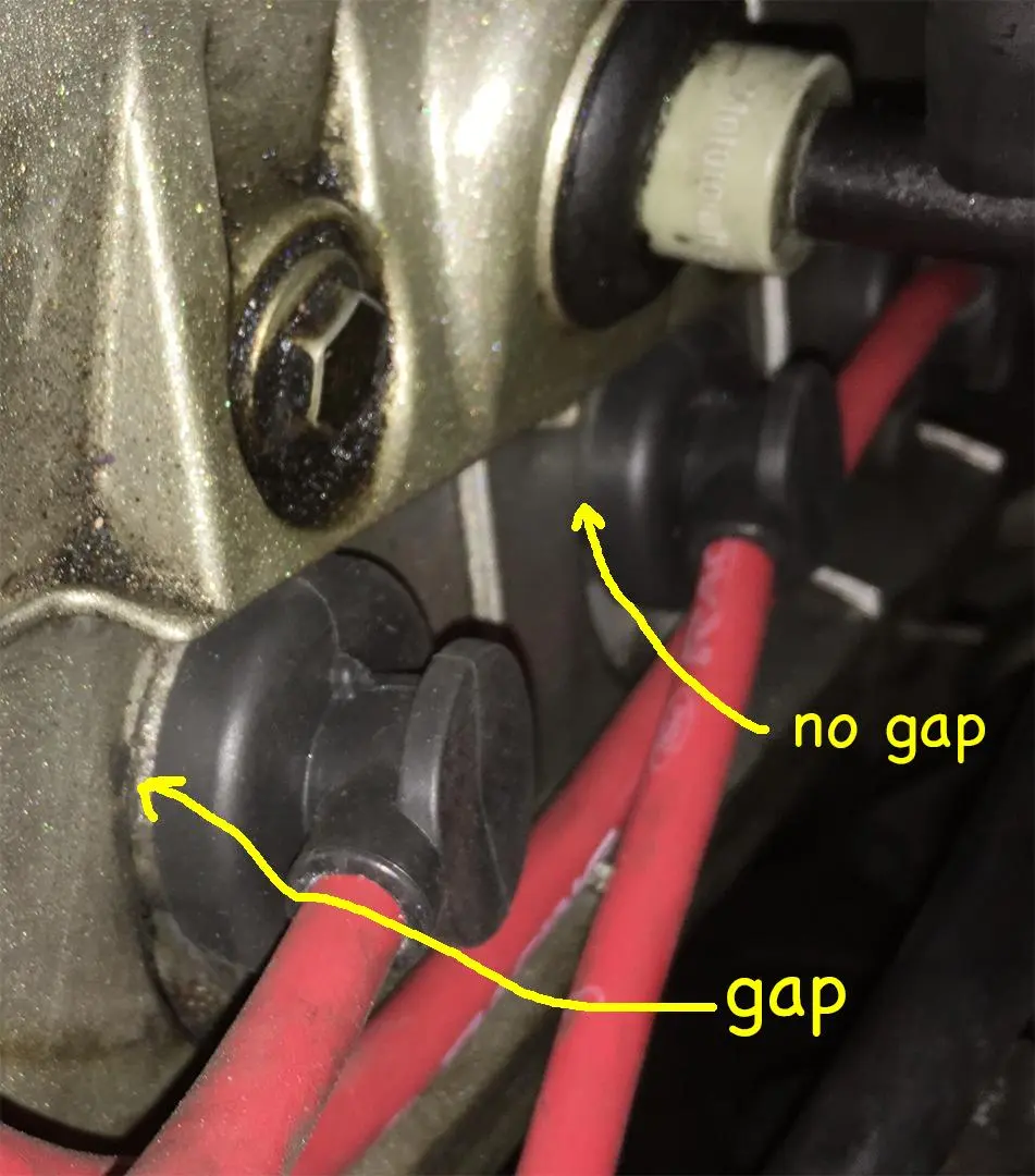

Today it was time to replace the spark-plug wires, and of course the plugs. I found that one of the rubber connector assemblies didn't want to slide over the spark plug and sit flush against the engine the way the others did. I tried another connector, but had the same problem. I also tried reinstalling the plug. I suspect that this is the hole that was repaired years ago (it's on the correct side).
I replaced the wires before, but don't remember this happening. I may have simply dismissed it, but now I'm concerned that the plug is actually not screwing into the block as far as the others, because of the repair. I've attached a picture showing the connector plunger in question.
Wouldn't it cause a performance problem to have a spark plug not extending into the cylinder properly? Any suggestions on what to check or do about this? The car does seem to run fine, but of course subtly reduced performance may not be noticeable.

Hi Gavin. Thinking out loud here...
--Would that difference in spark plug seat height matter? Seems to me it would. The spark plugs do not usually take too many turns of the wrench to get in place. Each turn is a couple millimeters, I would imagine. Could we equate the difference in the spark plug seat height you show to not tightening any other working spark plug fully? Or tightening it fully, but backing it out a half turn? Not sure, but seems logical to think so. Would that difference be enough to affect the ability to properly ignite the air/fuel mixture in the cylinder? That seems to be the question.
--You know, issues tend to be simpler for more complex. Could it be debris or residue built up in the spark plug cavity? Perhaps with a mirror and flashlight you could get a glimpse down there? Or with a small hose-camera?
--I was not familiar with the heli-coil solution, so I did a quick search on the interwebs... given this video:
View: https://www.youtube.com/watch?v=-_azEsNkA9Q
, it seems plausible that the thread in the affected cylinder would have flexibility properties different than that of the other threads. Perhaps expansion/contraction over time has affected the integrity of the original heli-coil. Not sure. Just thinking out loud here.
--Perhaps there is some way for you to look back through your paperwork to identify the specific spark plug cavity that had the heli-coil work done to it?

Thanks for the reply. As it happens, my car is now misfiring badly, and sure enough it's this same cylinder. My mechanic concluded that it was bad spark-plug wires, which I've encountered before and yes, they produced similar symptoms.
So I replaced the wires, and the problem came back quite rapidly. This time my mechanic concluded that the wire to this cylinder was defective. I've replaced it, and still the same result: misfiring. I tested the newest wire against the other (almost-as-new) one and found the same 3.3K-ohm resistance.
Even more alarming: The gap in the fit of the wire assembly is now larger than it was in the above picture. This indicates to me that the plug may be coming out of the engine. Further research reveals that it's not uncommon for helicoils to fail.

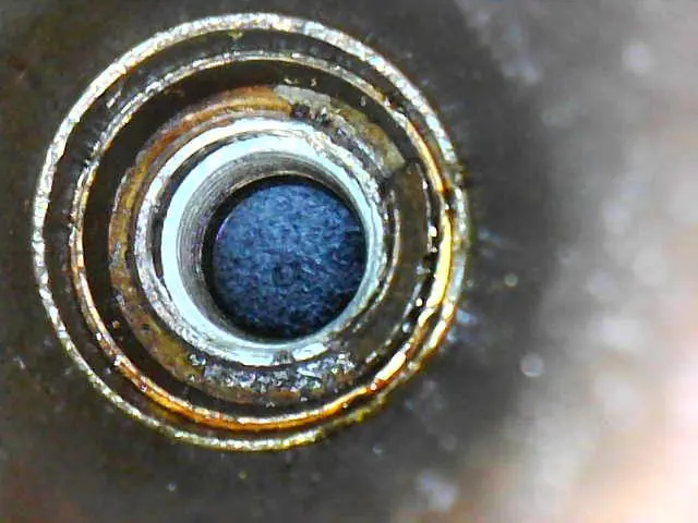

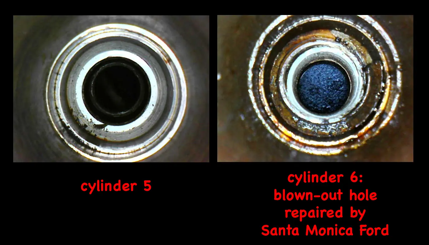

I finally used my borescope to take a look at this hole. Here's what I can see from the top:
I don't know what that fragmentary shape is at the 3:00-4:00 position. Although the scope has a 90-degree mirror attachment, its focusing distance is about an inch and a half; so I can't get a clear side view of the thing.
I pulled a plug from a neighboring cylinder and was about to look at it when the camera battery died. I'll try again tomorrow, but meanwhile any feedback is welcome.
Reactions: NotA5oh
