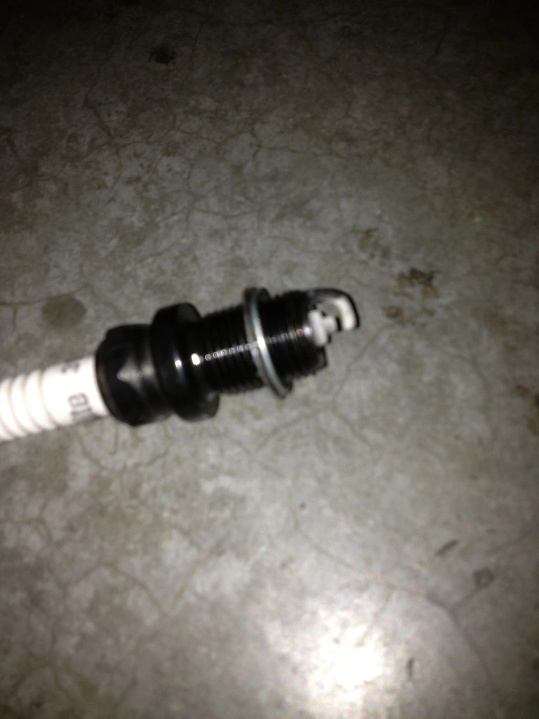

Plug was getting buildup on the edge.
Two days ago I ripped it down to swap the Intake pulled the valve covers, compressed the springs, pulled them off, and put on a new valve seal and threw it bak together. Valve guides were fine
Today I threw new plugs in, and it runs damn good!! But I pulled the #8 plug and its getting buildup still, on hard acceleration it doesn't smoke as much, but still does.

looks like you are running way lean
you cant read plugs after youve idled on them...
unless thats a wide open throttle pull then the motor shut off while at wipe open throttle you will NEVER get a good reading on a plug.
as for the oil left over on the plug... give it a few days of running with the plugs in it and let number 8 burn what ever is left in it out. and then report back. may help to pull them out after 2 or so and clean number 8 off so you know its getting a good spark in that hole.
might also want to run some seafoam through the PCV line to break up any crap thats down in the chamber also to help get it out.
