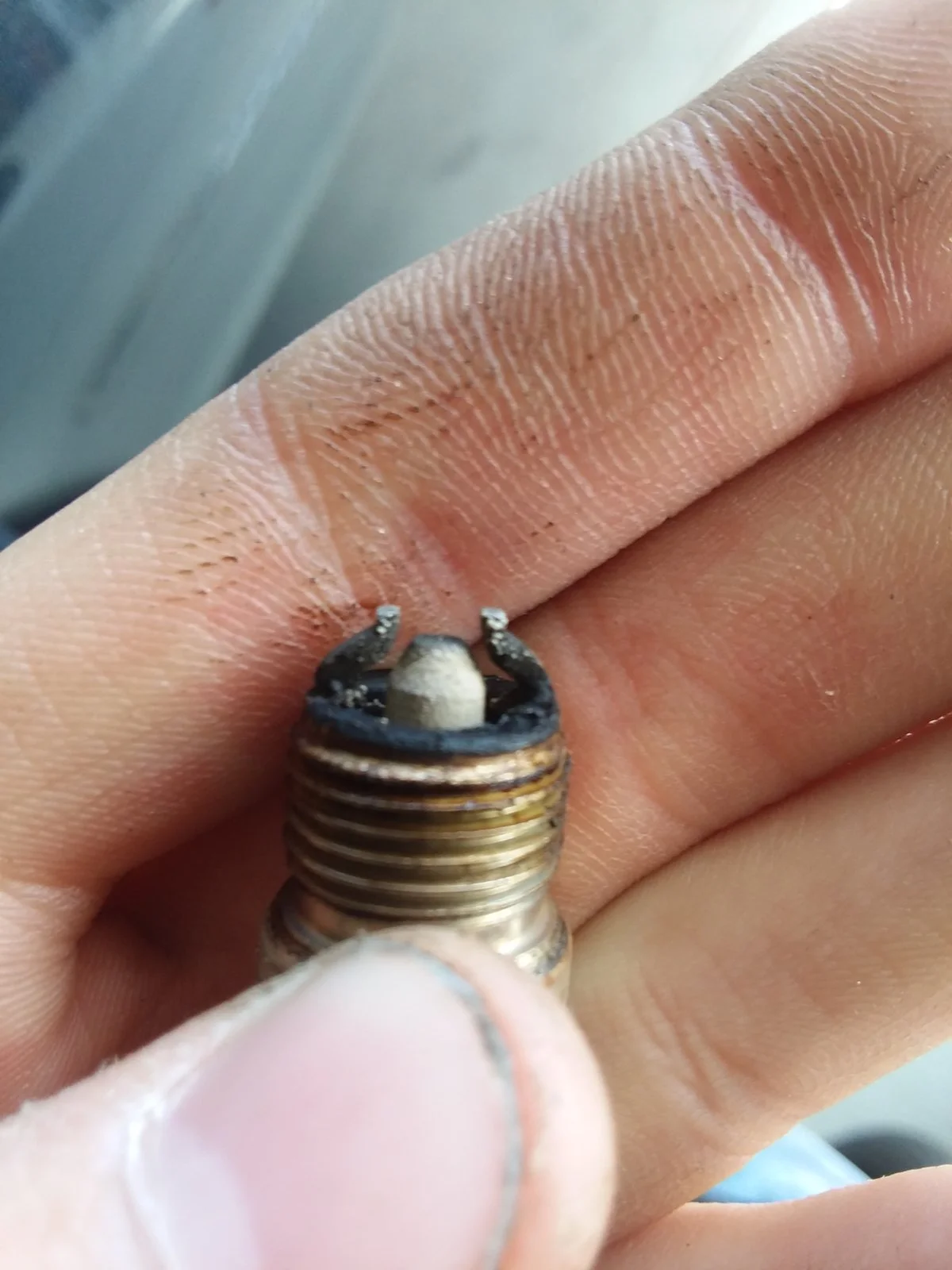

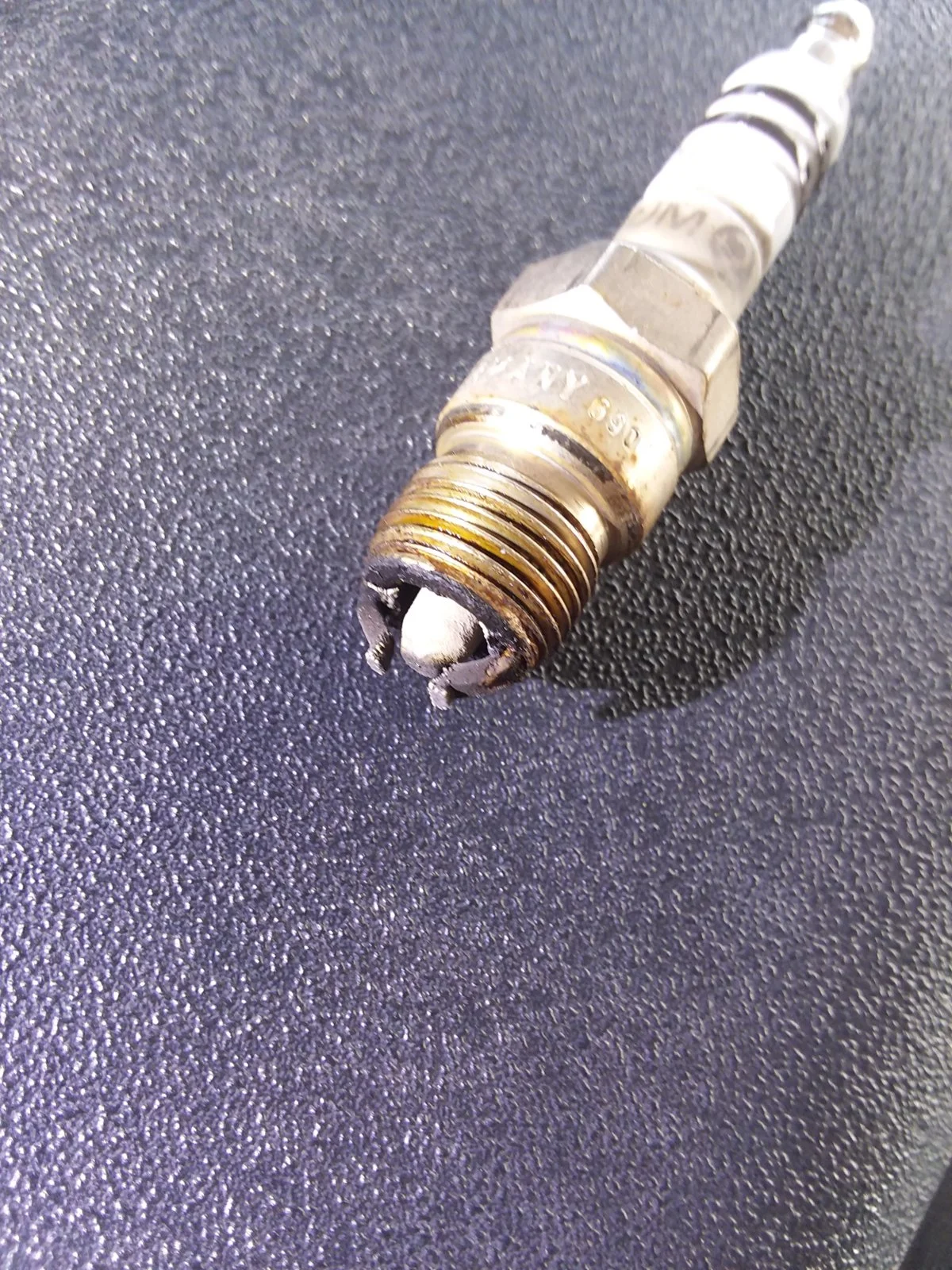

This doesn't look right, is it oil fouling, what do you guys think?
That's a sign of oil being in the combustion chamber....
What cylinder was that and what engine ?
5.0 ho out of my 1991 mustang. That was cylinder 5. I figured it was oil fouling, I think its valve seals.
That spark plug looks like its been in the engine for 12000 miles.
It would be wet if it was fouling. It looks to be neither fuel, nor oil. Most likely carbon
Build up.
If the engine eats oil enough to foul a plug, it'd smoke as well I think.
And unless you've either did a leak down test ( preferred) or a compression test to determine overall consistency between cylinders, I'd think twice before pulling anything apart.
Build up.
She smoked a little. But replaced my PCV and it hasn't smoked much since. Should I put some new plugs in, factory plugs instead of those Bosh plugs the previous owner put in?
